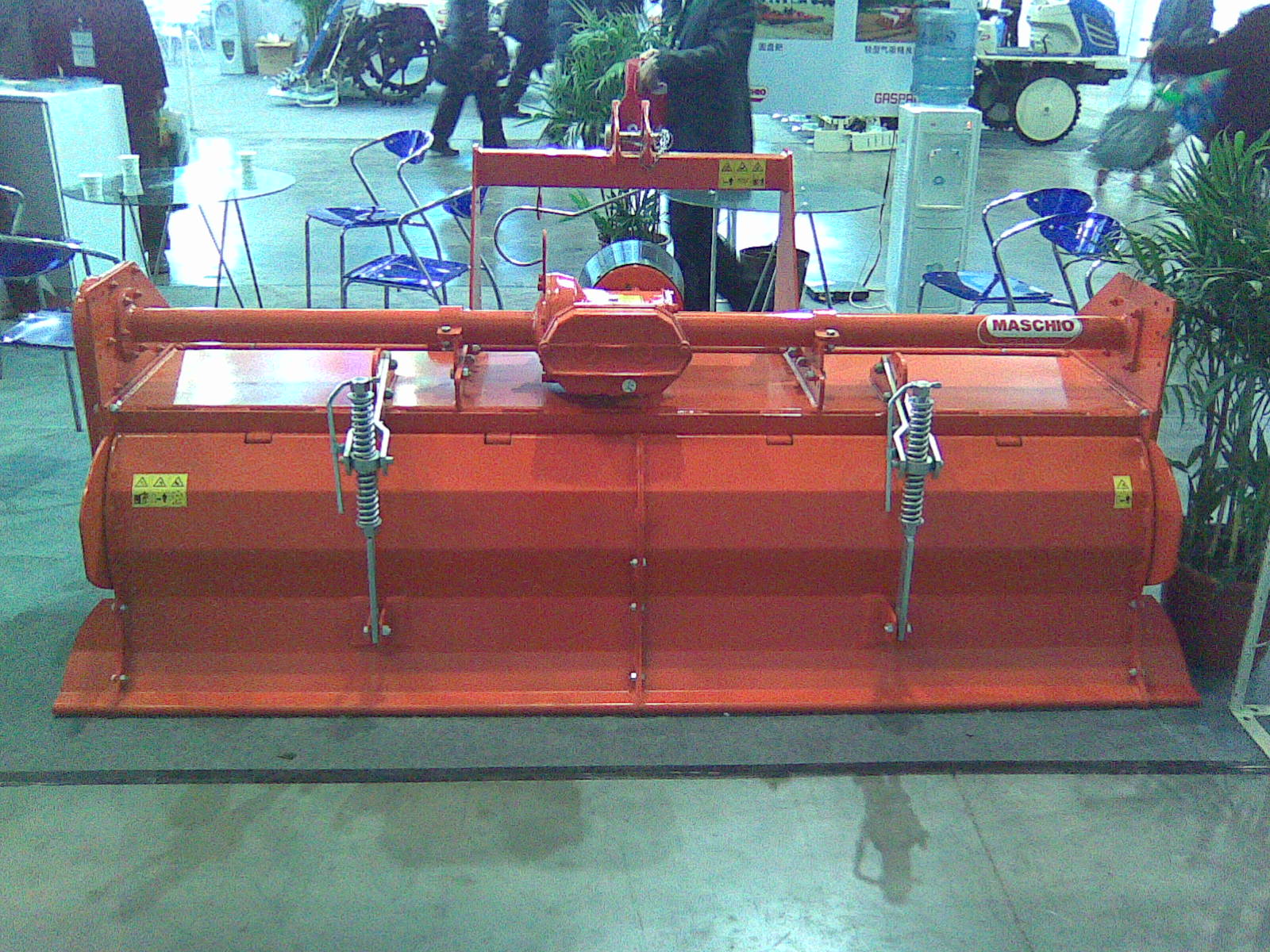

So I finally got a chance to give this tiller a workout. I went from this:
To this:
Here's an action shot from another section
I'm *NOT* running the tiller offset to one side, having it it centered is not an issue with leaving tire tracks at all.
All tilling is at 540E PTO and no issues at all. It does bounce when it finds rocks or root, and there were plenty of those!
I made 4 passes over this 1 acre area. No leaks or any other issues encountered. Seem to be a very solid unit!

hello, how much did you pay for this?
and one more thing, I'm very sure this Maschio tiller are made in China. Last month I visited the exhibition in Nanjing and I talk a lot with Maschio's Chinese factory's sales manager, he told me all of them are sold to oversea. Then I check in the China Custom's data, he said right.
