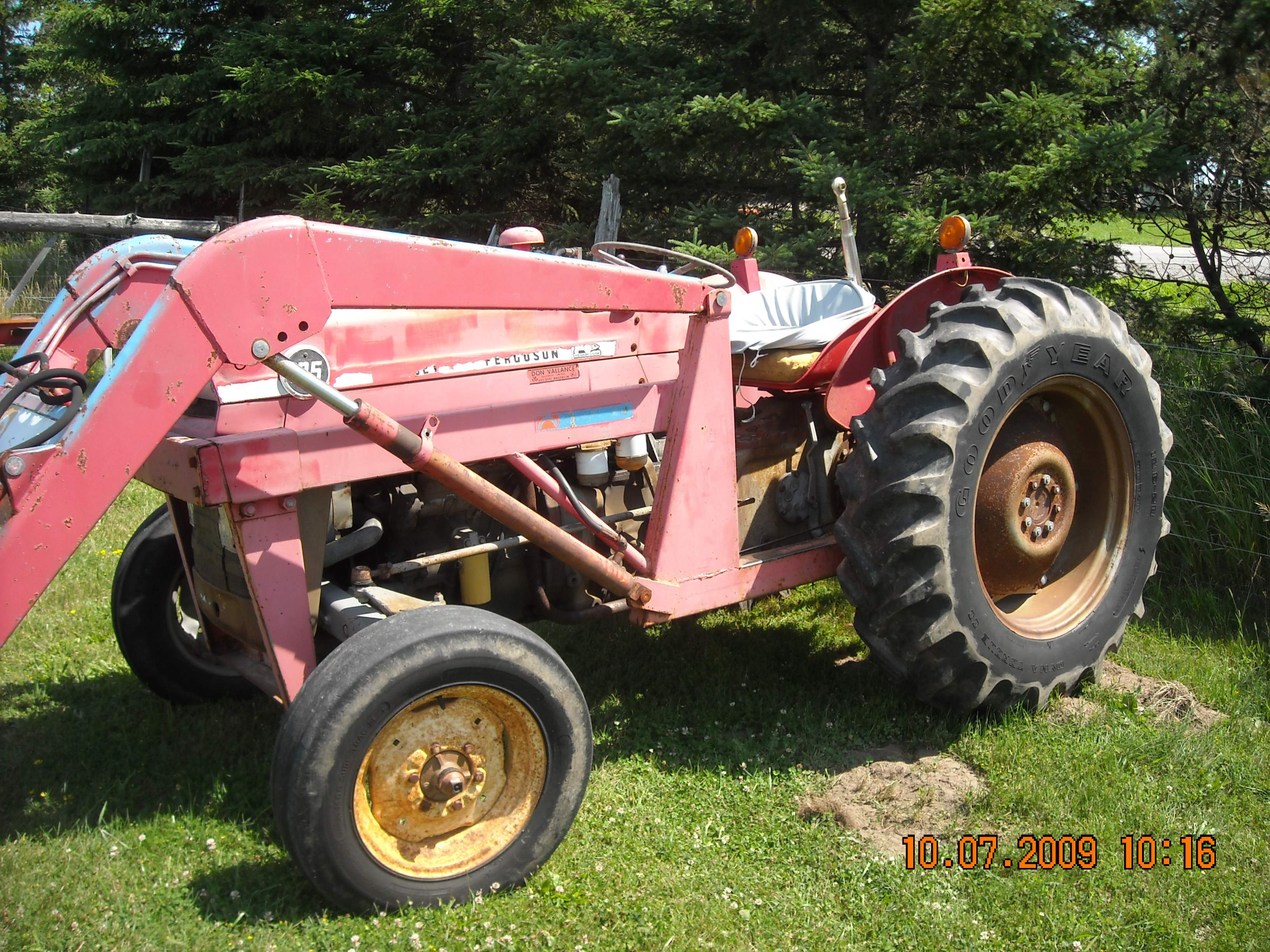

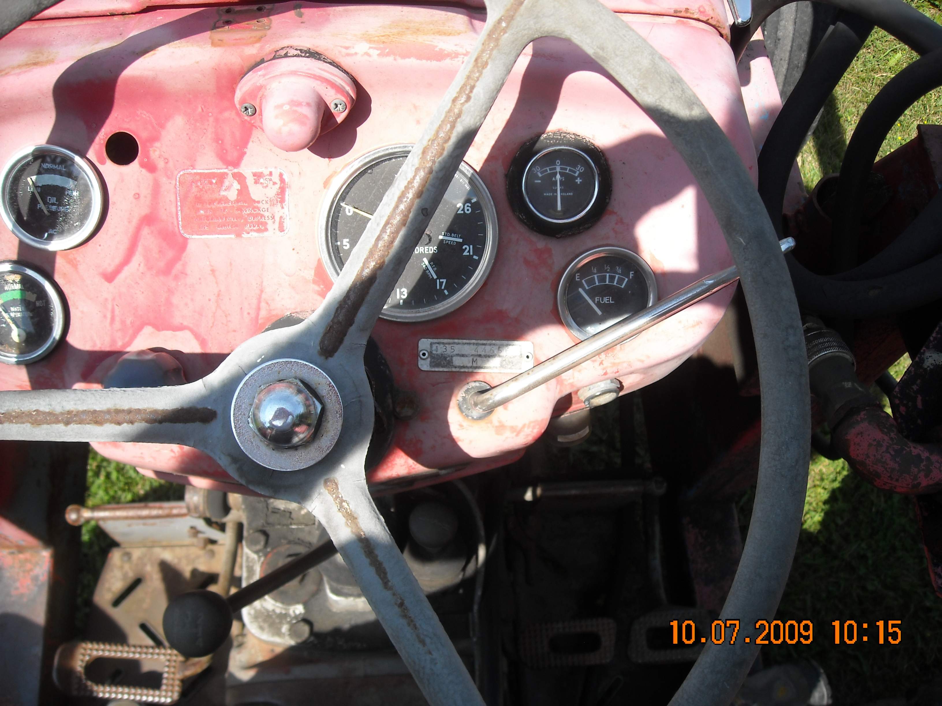

I guess I should have mentioned that I'm a Canadian, eh! I thought there wouldn't be a difference between Canadian and American tractors. I took a couple of pictures of the front axle to see if that helps Farmwithjunk about figuring out the model or year of it. Thanks for the breakdown of the pto. It will help until I get hte books. View attachment 134763
I don't know the exact year (or serial # break-off point) but LATER model UK (Canadian too) 135's went to the straight axle. I'm thinking it was around '72 or so. I have a buddy who's more in tuned with UK models that I'll pass along the serial # to him. I'm sure he could identify the year based on ser. #.
   / Massey 135 just aquired #23
That is the same setup as my 135 has. If it's a UK model that would explain why I can't get the info I want on my steering valve from the local Massy dealer. Upon seeing my tractor the mechanics there had no idea why it was setup like it is.
Brakeman could you humor me and get a picture of the steering gear housing? I just haven't seen another one like mine anywhere. Wanted to see if they are the same.
Here are a couple of pictures I had available right now.
I think what you have there is a 2135 OR more likely a 135 TURF SPECIAL. (Note non-adjustable front axle) They were quite different than a standard 135.

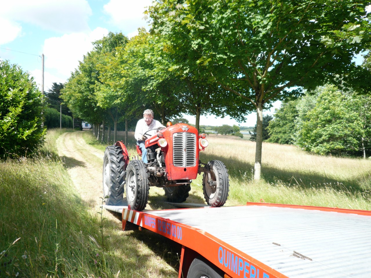

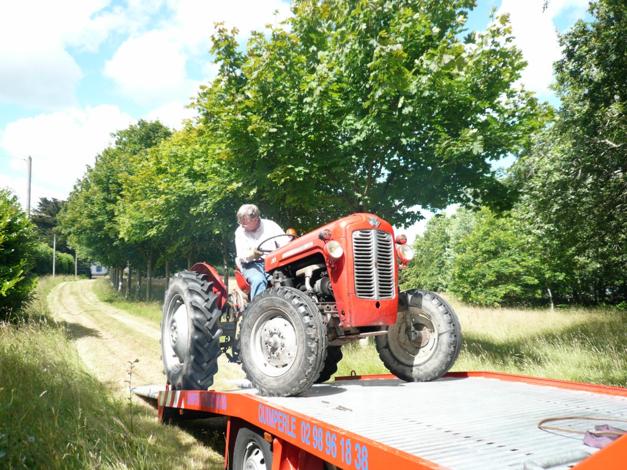

My diesel Massey 35 has an adjustable front axle.

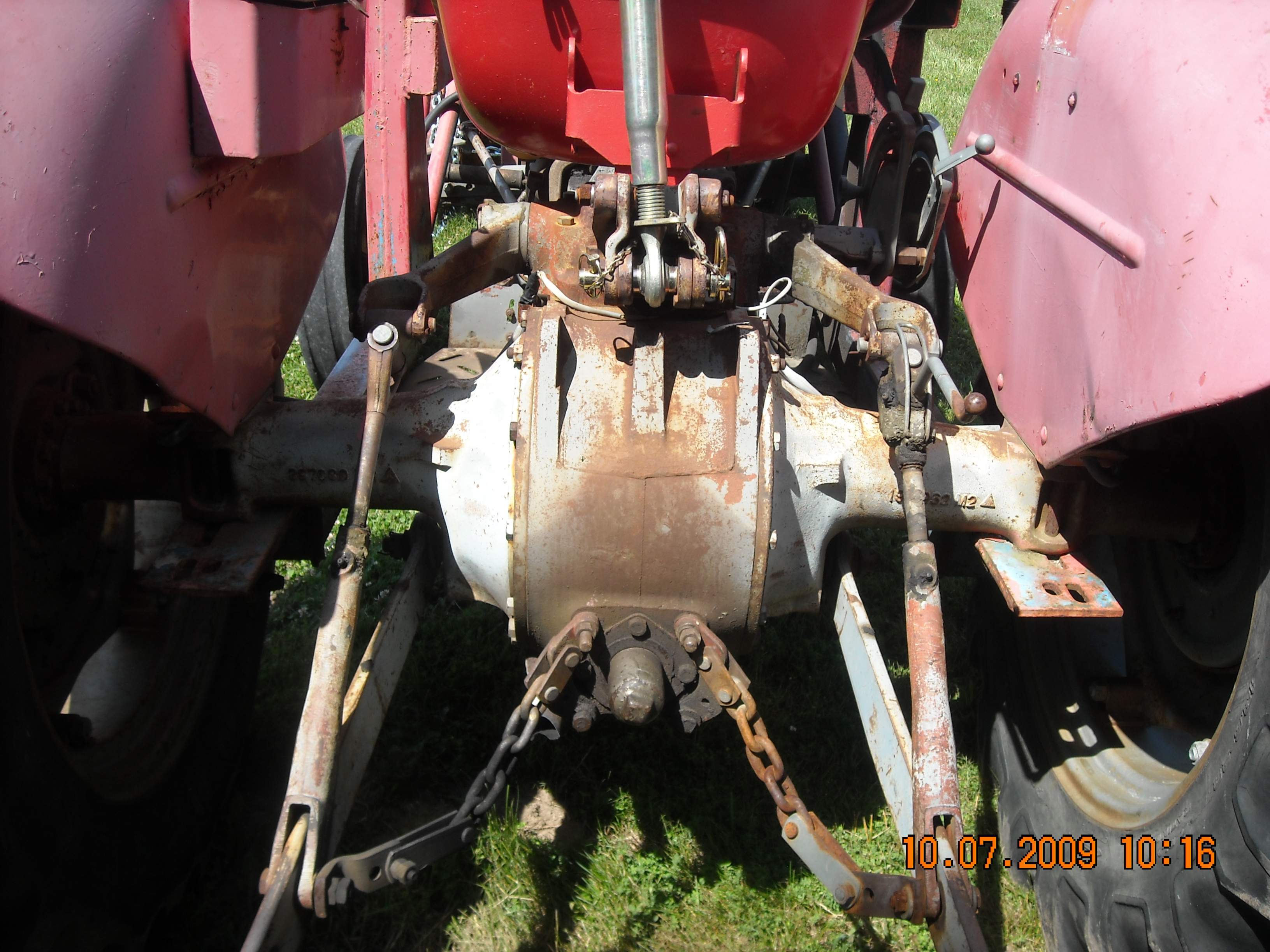

I checked Dirtleg's 6/21/08 post ("Just bought a 135 orchard"). His 135 has that beefy rear axle that's very different from the one on my 135 orchard.
My 135 has the standard 135 axle (shown in this photo)
As near as I can figure, the original owner of my 135 cut down or replaced the front axle spindles to lower the tractor and substituted 16" dia rear rims for the standard 28" rims so the tractor could be used in his olive orchard. It sure doesn't look like any of the 135 orchard tractors in my MF fat book ("A World-Wide Guide to Massey Ferguson 100 and 1000 Tractors--1964-1988").
