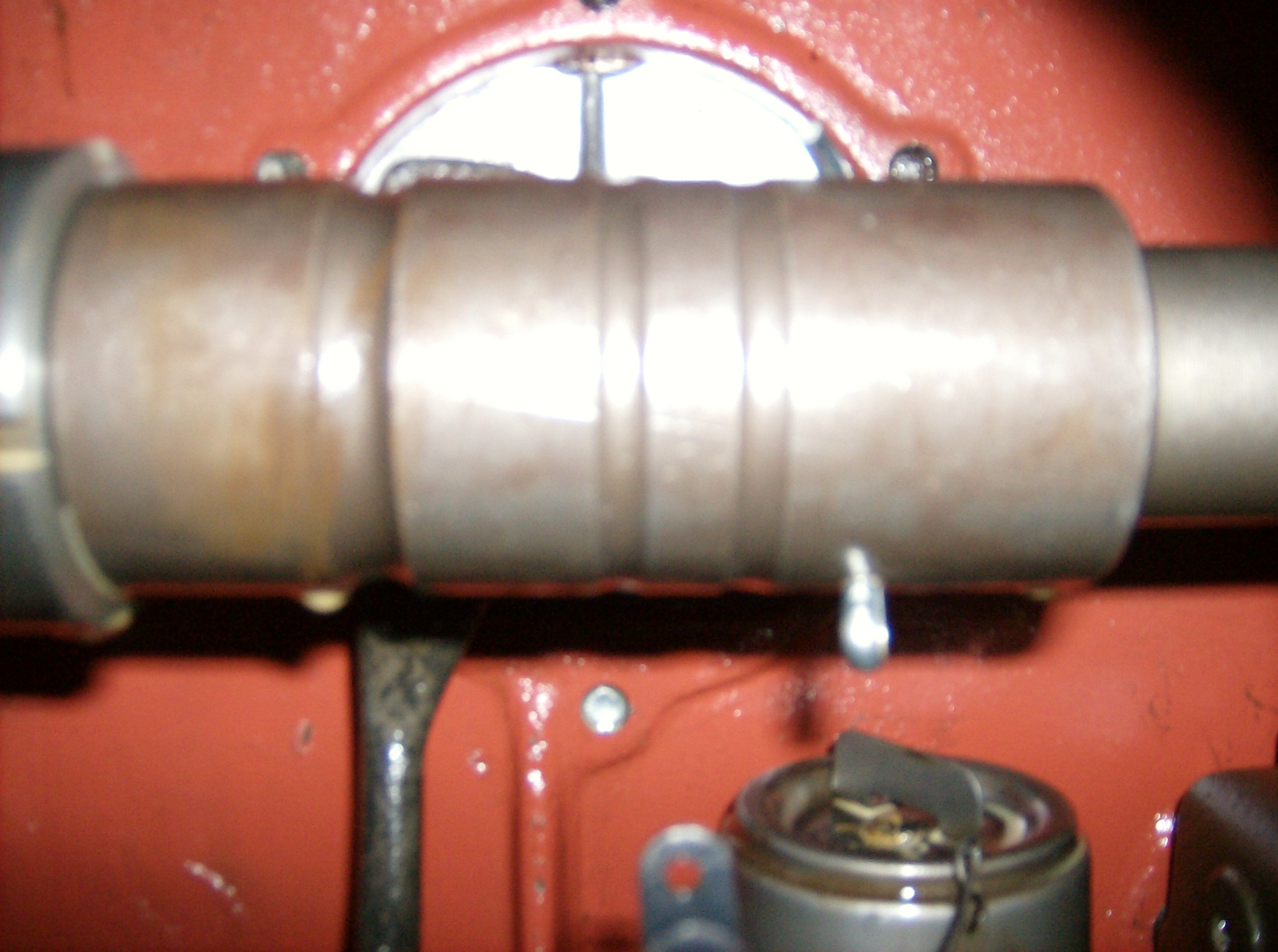

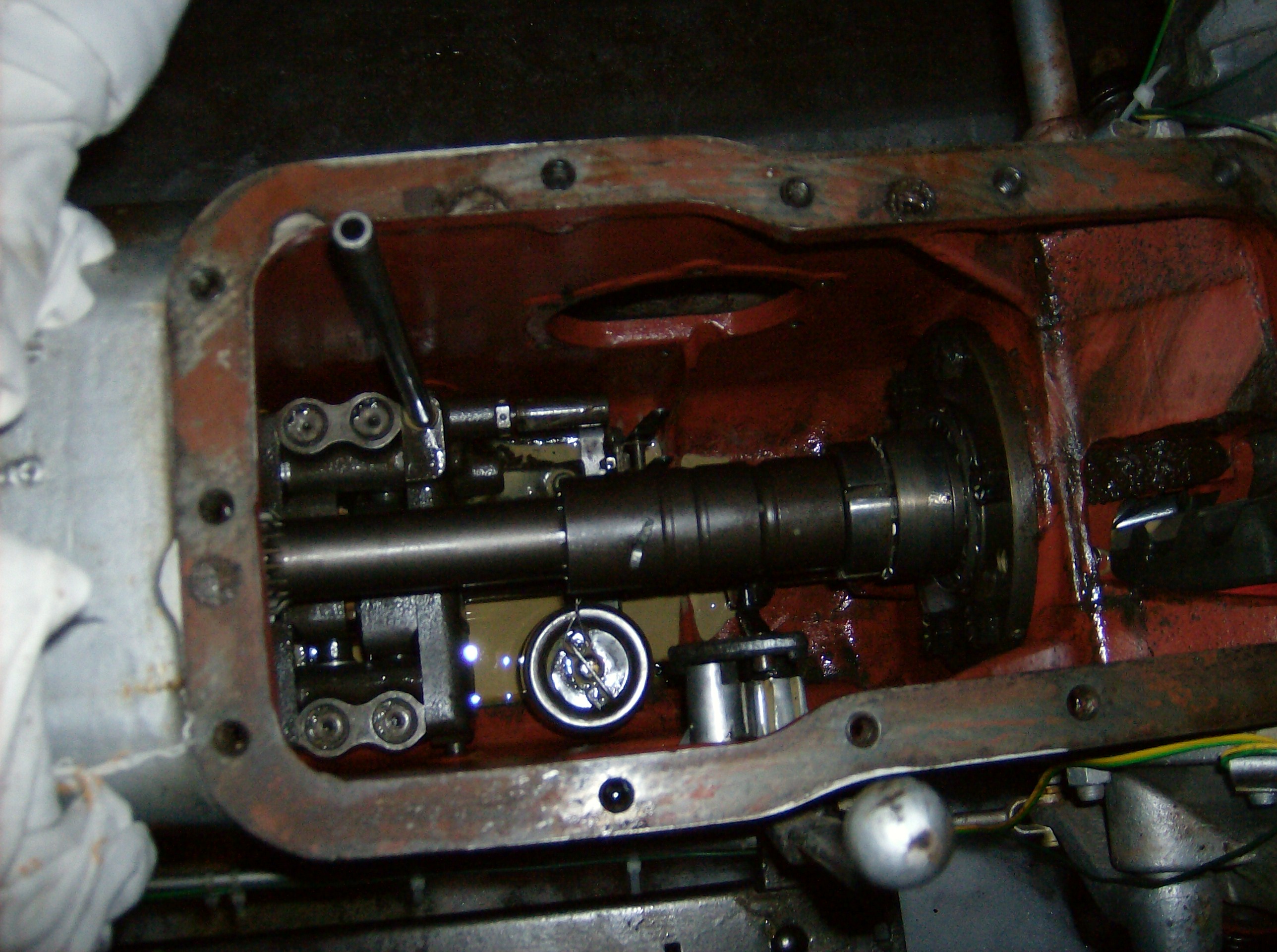

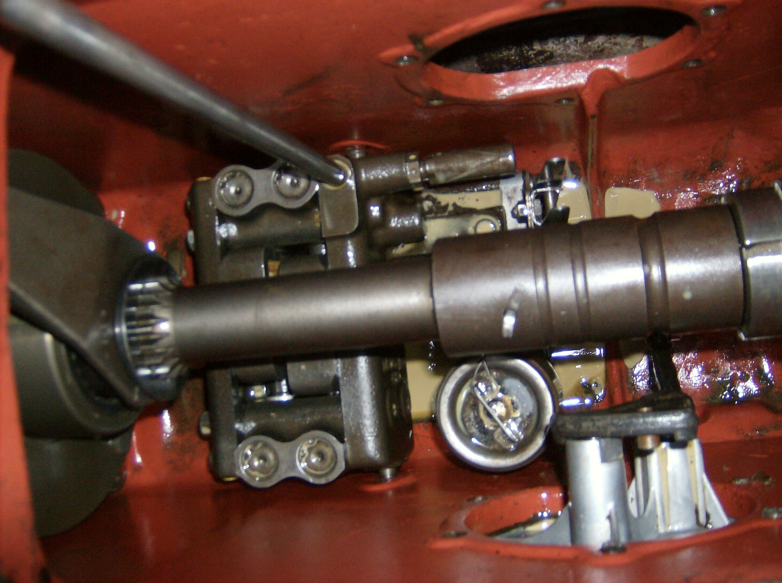

HI Brakeman; Im new to the forum and noticed your entries. Im in Peterbrough Ontario and have a 135. Presently I have a recent problem with slow hydraulics. A local mechanic suggests a clogged filter but without a view of it and where it is I cant imagine how my hand will pull it out of the tranny. Any ideas or maybe a picture? Im working on getting manuals .
Thanks
Keith
   / Massey 135 just aquired #37
Thanks
Keith
Filter should be on the right side of the tractor behind the dipstick plate??
   / Massey 135 just aquired #38
Could be a clogged filter, contaminated fluid (shift lever boots split and are allowing water into case) or seals on the standpipe. Pics are of my MF 135, hope they help.
