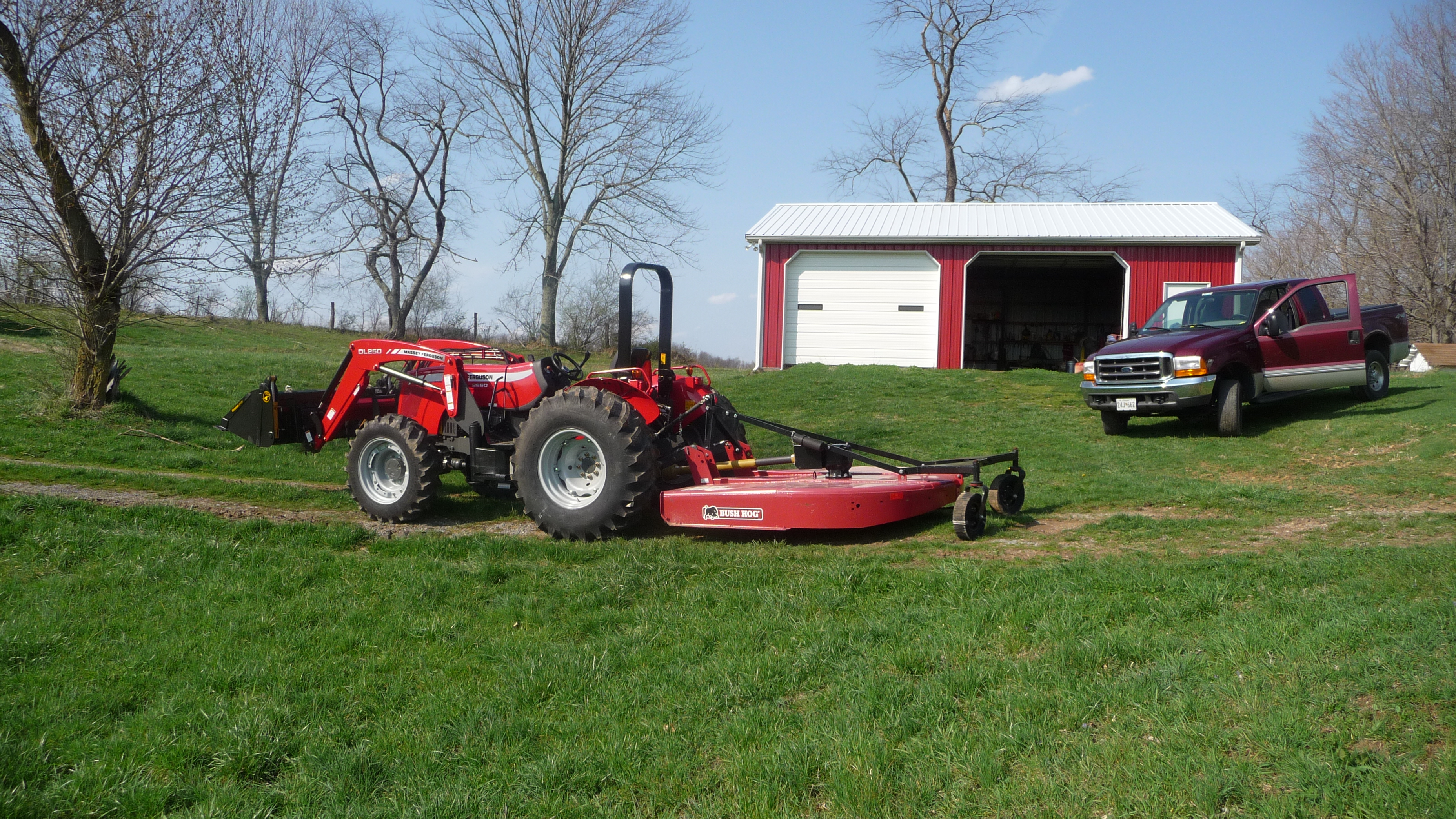

First pict is just before I took delivery.

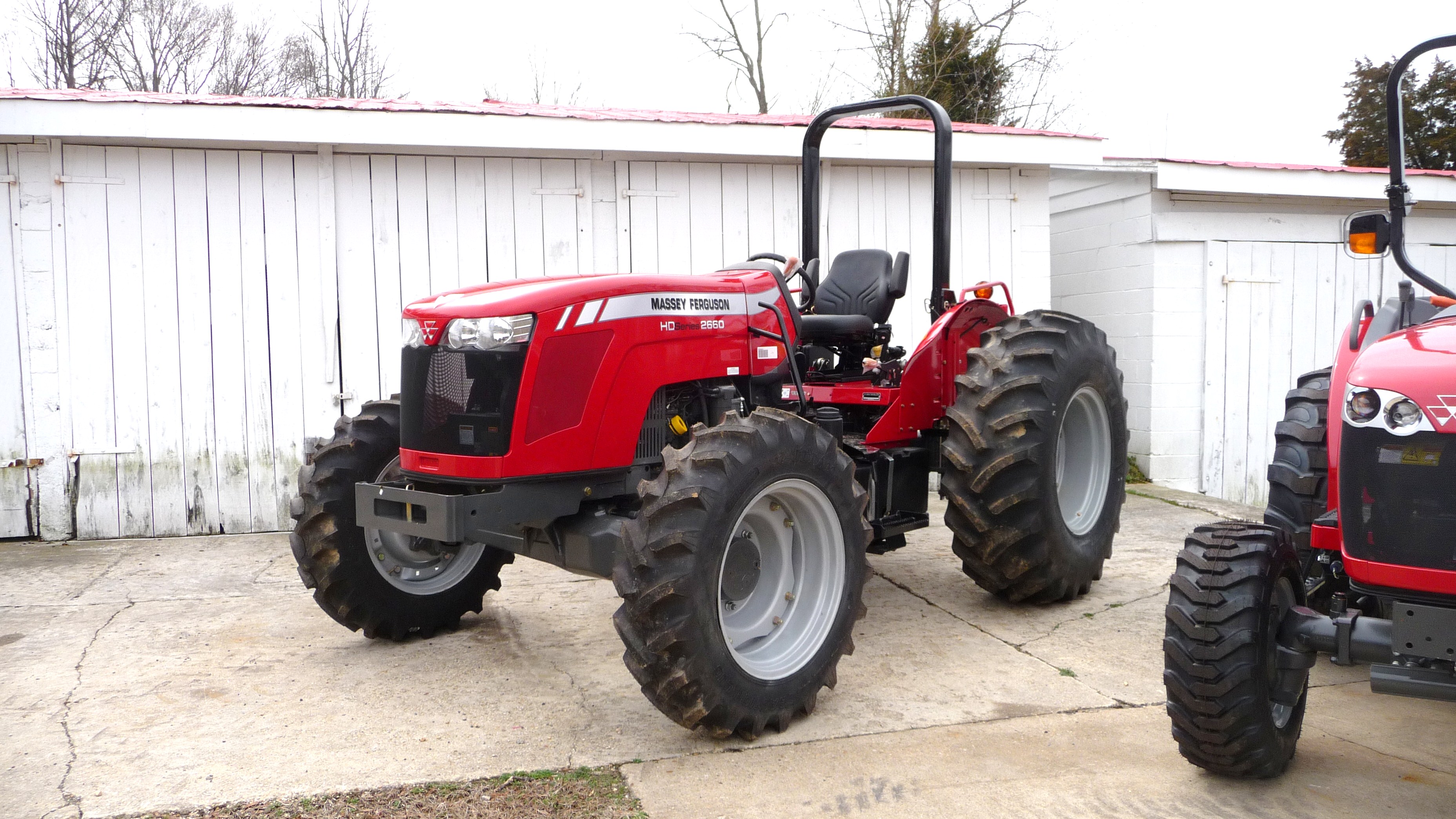

Second picture is on the farm in typical configuration as used today.

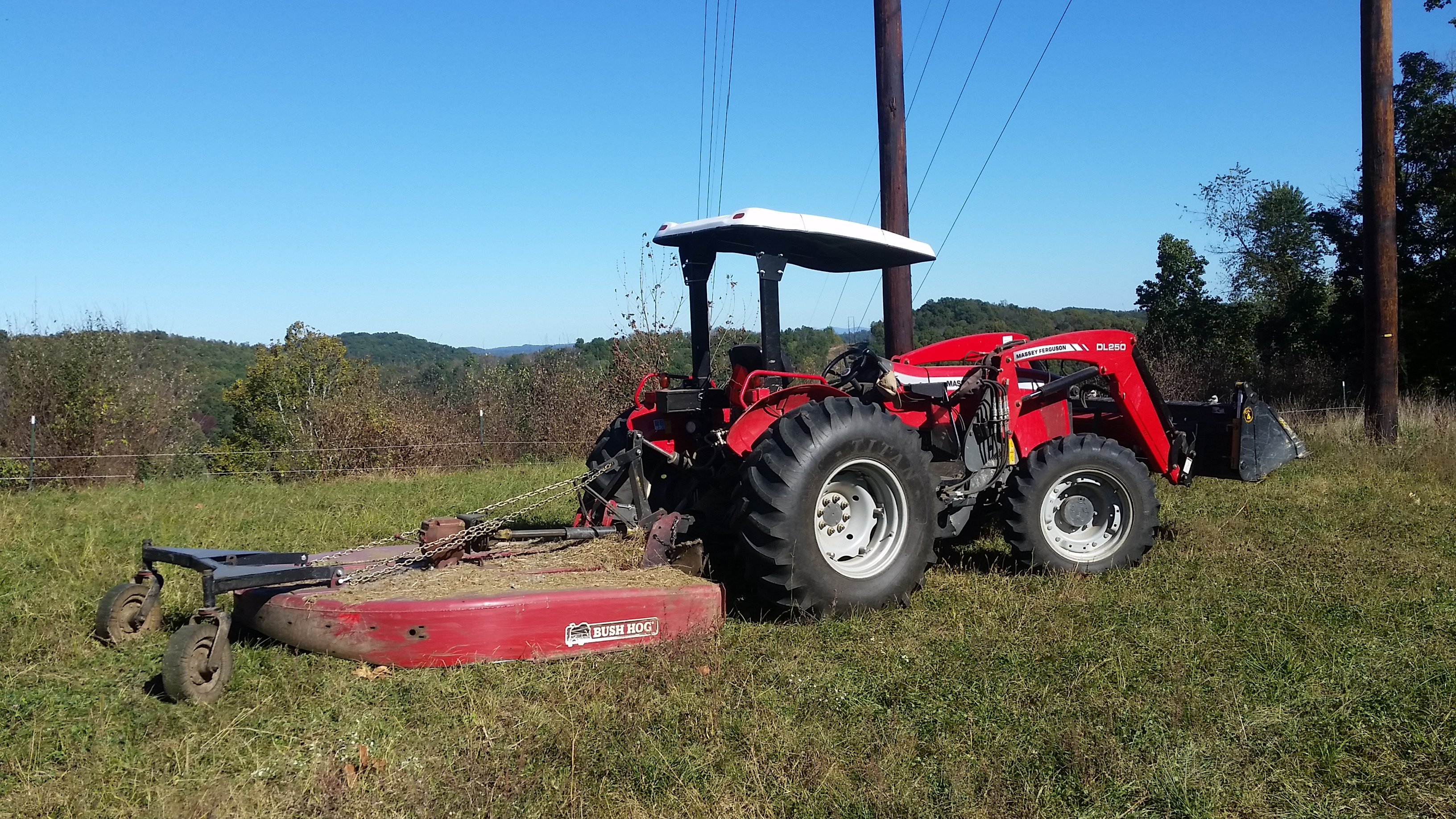

Third pict is just after hauling to the farm, still new, ready to use.
