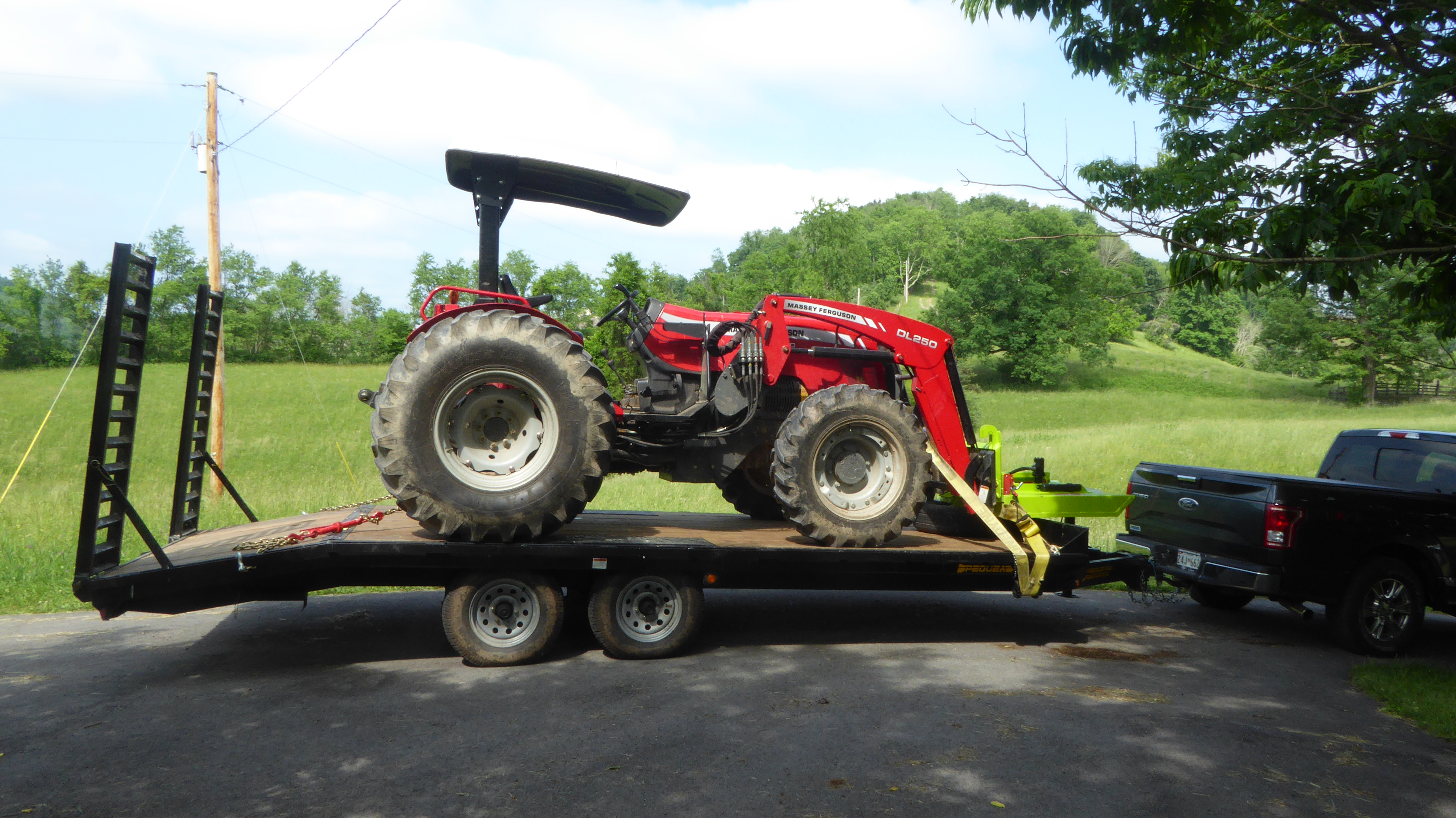

Speaking of trailers ... I had my 2660 wheels mounted such that the inner edges of the front and rear tires matched while the outer edges of the rear tires were 8ft. apart. That works really well for my applications, often on steep terrain and more bush hog work than anything else. It also meant that my old trailer at that time (early 2011) with fenders above the deck would not haul the 2660. I tried it just short distance with the front of the tractor as far forward as possible and concluded it was just the wrong trailer. I traded the trailer in at Wengers in PA for a new Pequea model 1018 deck-over that is 8' wide at the deck top. The actual deck length is 21' with 4' of that being a gentle sloped beavertail. Works very well. The axles are good for a 12,000lb GVWR but I got 6-lug wheels with overall rating of 10,000lbs to avoid some nuisance licensing issues. If the load capacity became an issue I could swap for the higher rated tires/wheels without changing anything else. The 2660 rear wheels can be mounted outward a good bit further but I'm comfortable on 40 to 50% slopes with the 8 foot outer edge rear spacing. If you go wider, it can become an issue for hauling, etc.
I'm very happy with my Pequea (good solid trailer, protected wiring, nice rubrails all around, toolbox area, heavy drop-leg jack, good brakes, etc.) I do not haul often.
With your cab model, probably wanting the loader and some rear implement on when you do haul, you probably want a larger trailer with more weight rating.
This picture is from last year when I bought a FEL mounted hydraulic motor rotary cutter for clearing overhanging limbs, brush, etc.

That is a very nice trailer and should be totally adequate for 2660 hauling when you need to do it. I like the fold over feature with the ramps allowing you to place things on top of them. I have had to rig some strange looking things to haul my 2660 with the 7ft bush hog on it due to my ramps. You also have a nice 6" more width to your deck. All good.
I was using a Ford F-250 with the V-10 engine and 5sp std transmission when I bought the 2660 here in So.Md. I borrowed a bigger trailer and towed it 330 miles incl. the mountains of I-68, etc. to the farm in central WV. The F-250 weighed 6600lbs and was 4WD with HD springs. That was before buying the newer Pequea deckover trailer that I have now. I use a 1000lb 4-in-1 bucket and a 1460lb 7ft Bush hog so if all that is on the trailer I'm at about 13,000 lbs total towed load. That was OK but was hairy in the much steeper mountains in Randolph/Tucker Co WV where I took it once -- without the bucket. The main towing chore was taking the 2660 to the dealer back in the "bad old days" of early ownership.
Now, it has been 5 years since I had any reason to take the 2660 to a dealer for work on it. And I traded trucks. The picture I posted in post #13 was a rare 1 time case when I took the bare tractor (no bucket and no Bush Hog) to a dealer 22 miles from the farm to have a Lane Shark FEL mounted cutter installed. Yes, that is my 2015 F-150 on that trip. There are some surprising stats between the F-250 V-10 and the F-150 turbocharged V6. The F-150 is automatic of course where the V-10 was a stick. The V6 has the same torque figures (420 ft-lb) but 65 HP more than the older 2000 model V-10. Power is not the issue. The main difference I felt was the F-150 being so much lighter -- about 1000lb lighter with an all aluminum body and a lighter duty truck anyway than the old F-250. The springs and 4WD and towing pkg are all OK but mainly because of the lightweight of the F-150 I would not be using it in the mountains or challenging towing with the 2660. I have used the F-150 to haul a B2150 Kubota to/from another place in the higher mountains in WV and various things like attachments (the 7ft hog by itself, a 7.5ft flail mower, etc.) But not the larger tractor. My towing these days is not frequent.
