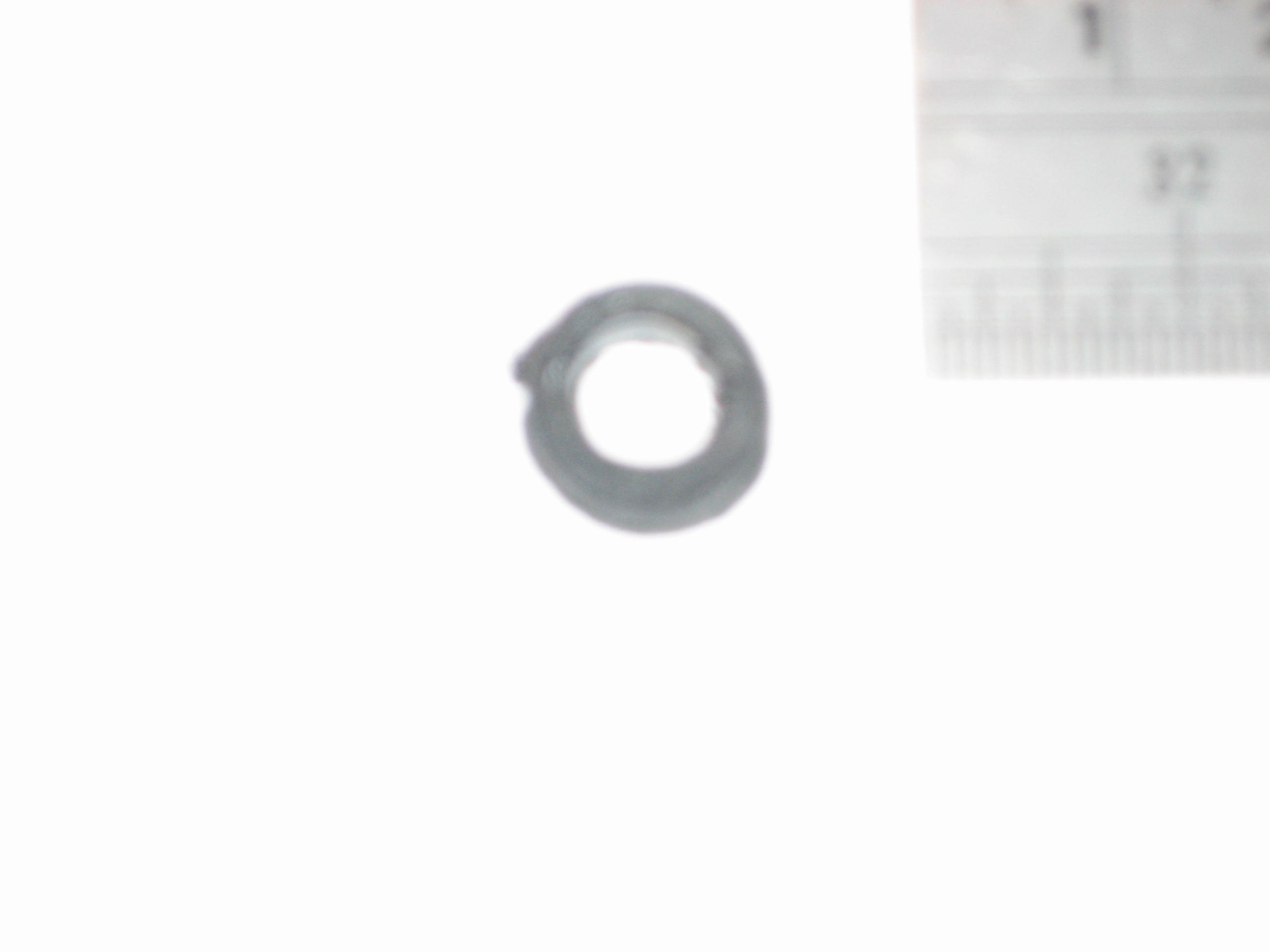

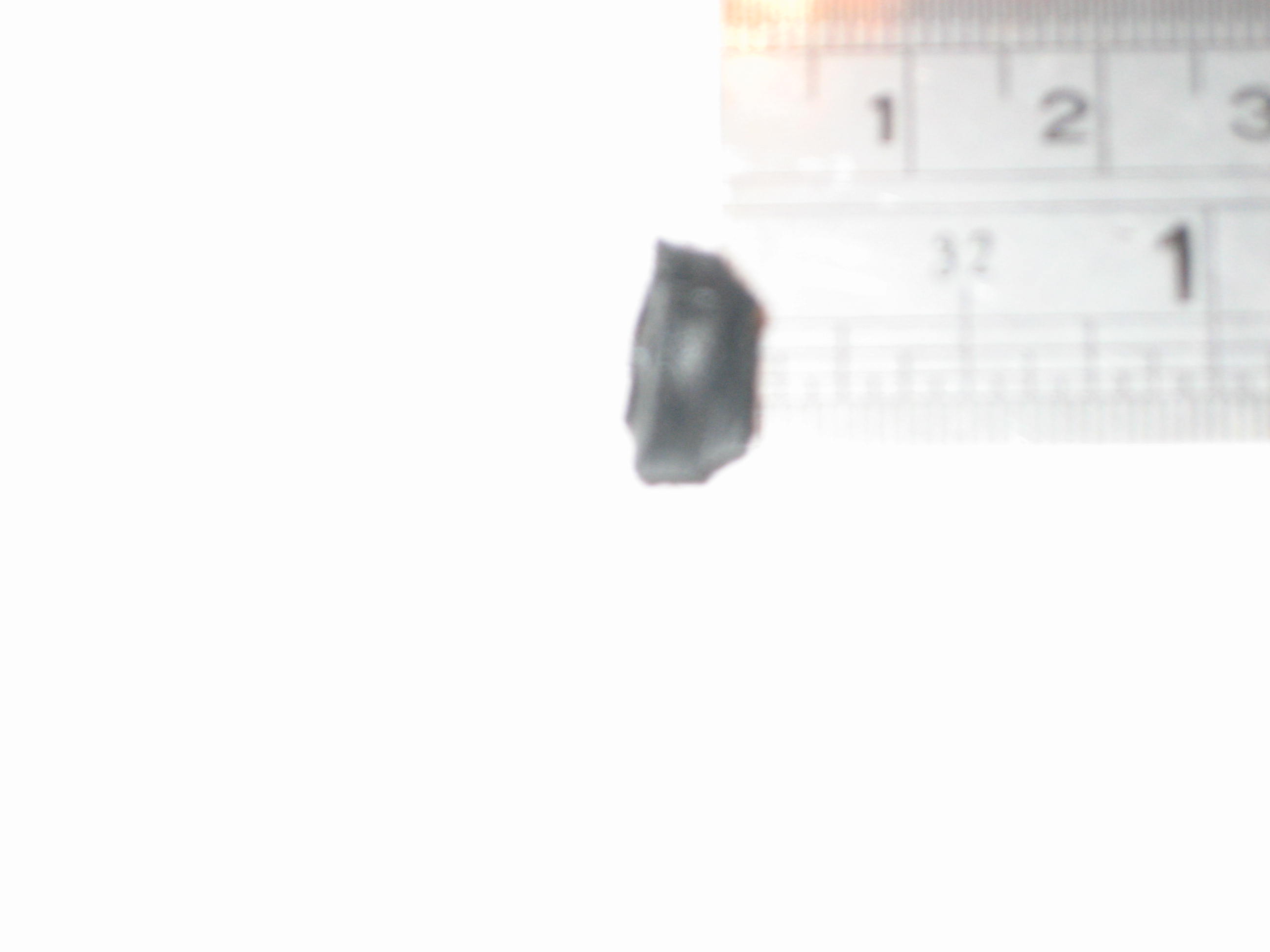

OK I got a MF30 industrial tractor, AD4-203 Perkins engine.
The fuel fittings have a 1/4" flared steel tube, with a rubber "gromet" next with the nut next, see rough pic for the gromet.
All the auto parts stores have come up with zero, where do I get these guys, I did use 2 A/C washers to replace the last ones when I did the fuel injector pump.

I just cut some 1/4" rubber fuel line real straight with a razor blade. Has worked good for me

Have had good results as well doing this.

These rubber olives are a standard Perkins engine component, available from any "Perins Engine" agent. ,!

What are they called, or do you have a part number?

They are called "rubber olives " !!!!! Dont have any part numbers , they were also used by IH on the 475 tractor.

Thanks that was the lead that I needed, they are also know as "fuel line sleeves" P/N 376525X1.
