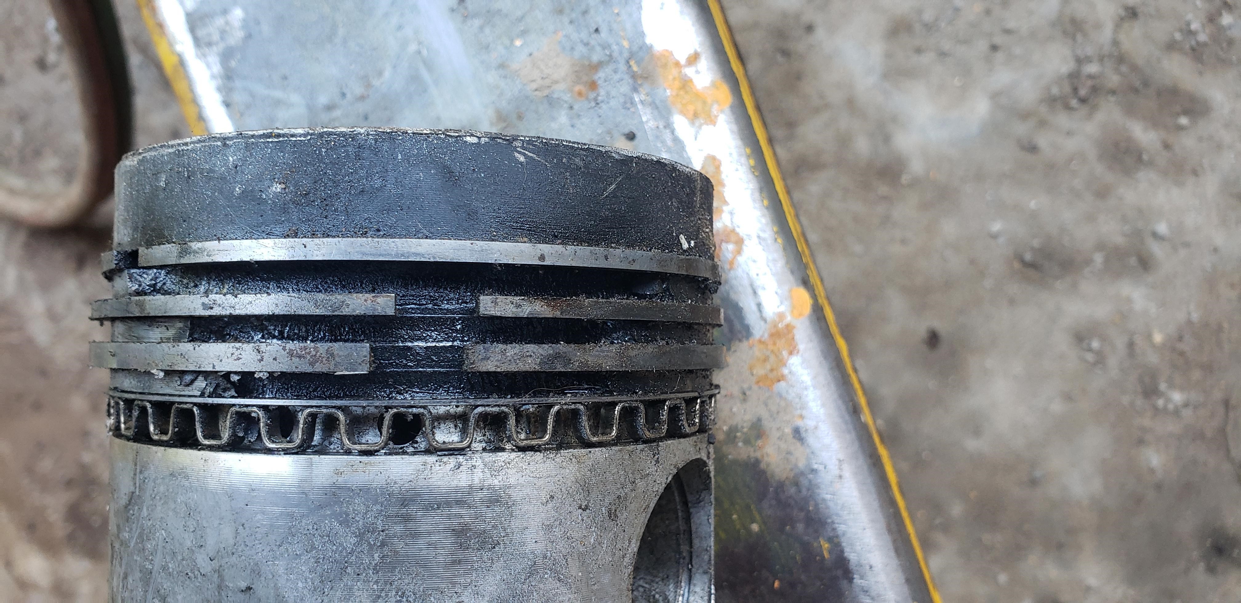

In the photo below the damage to the piston was caused by thee previous owner using starting fluid. Two of three cylinders had cracked lands and rings. I'm not sure if wd40 could also do similar damage.
Does your manifold heater work. If its working properly you can see diesel vapor at the intake manifold after 15 seconds holding the switch with the air cleaner disconnected. It will start if you have diesel fuel vaporizing. In warmer weather a good engine will state without the heater. You may want to do a compression check.
Avoid using fluids to start the engine. Its doing nothing to solve the starting issue.

The piston rings weren't lined up like that when it was removed. I turned them to show damage to the lands.

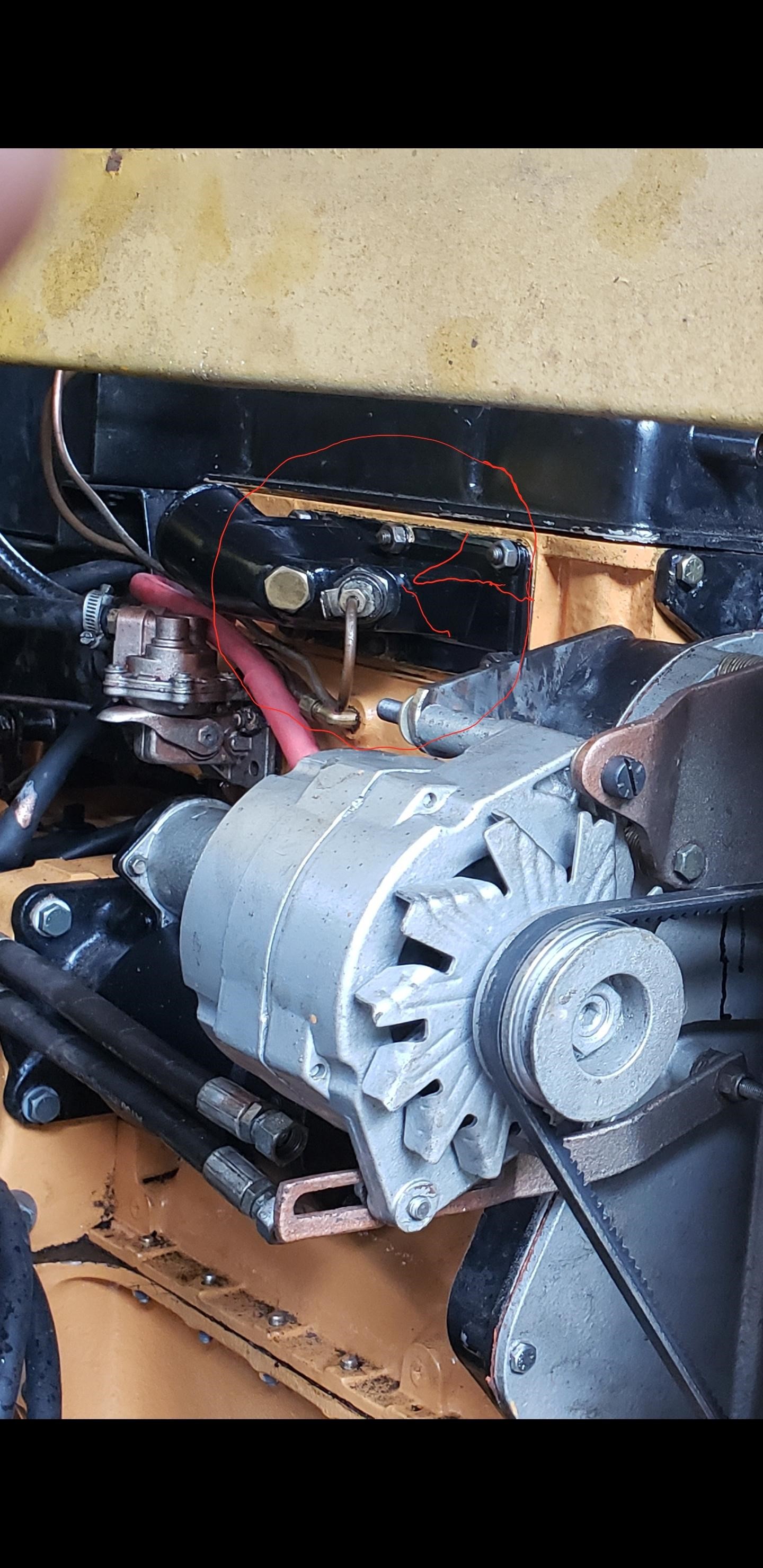

No heater ??? Look on the intake for a wire connection and a small fuel tubing going too it
   / Massey Ferguson 135 issues #19
Yours could very well be different. Inside the red circle is a manifold hearer that's fed by diesel fuel. Not a block heater. The wire is off of the one pictured
