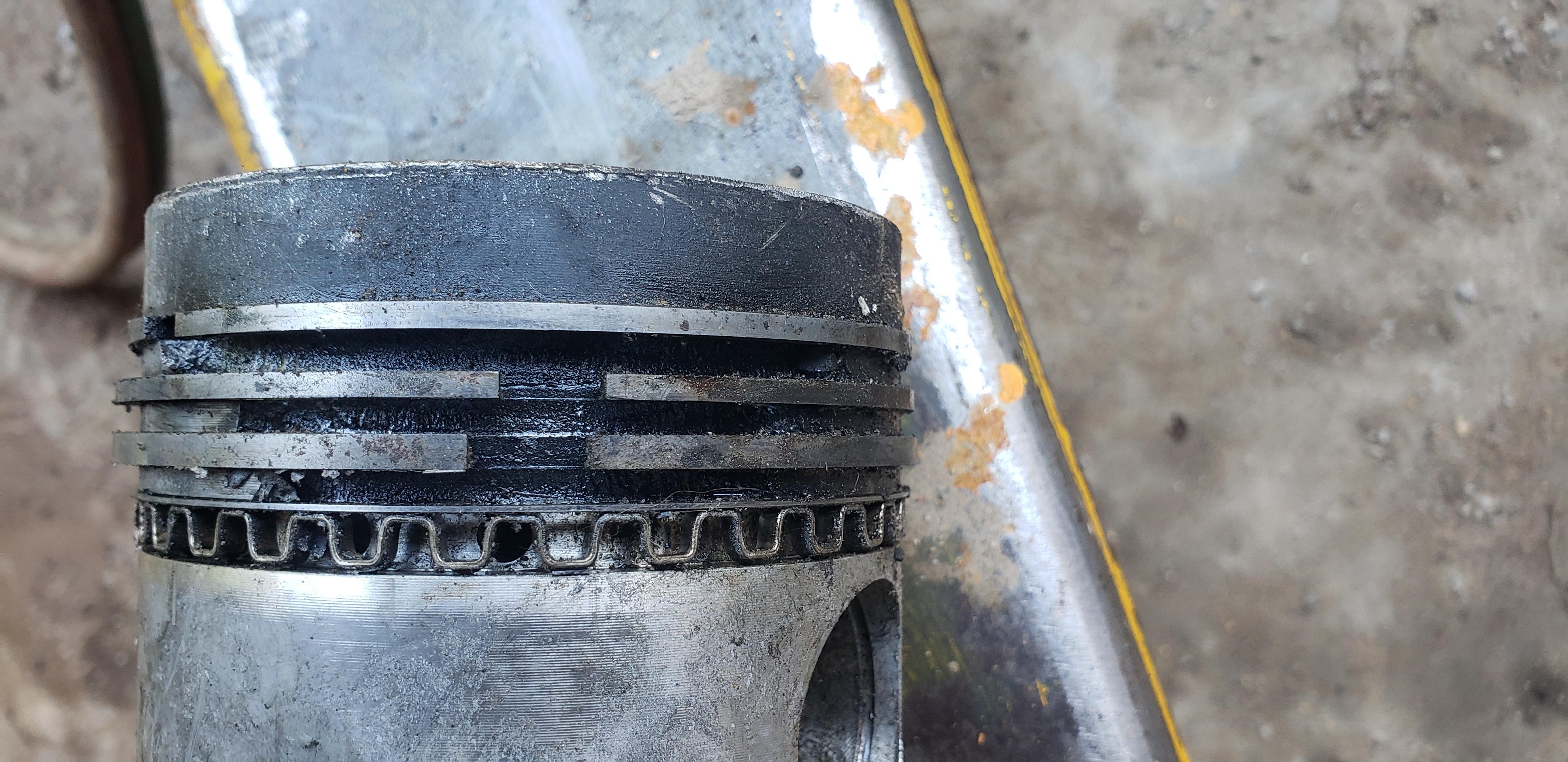

In the photo below the damage to the piston was caused by thee previous owner using starting fluid. Two of three cylinders had cracked lands and rings. I'm not sure if wd40 could also do similar damage.
Does your manifold heater work. If its working properly you can see diesel vapor at the intake manifold after 15 seconds holding the switch with the air cleaner disconnected. It will start if you have diesel fuel vaporizing. In warmer weather a good engine will state without the heater. You may want to do a compression check.
Avoid using fluids to start the engine. Its doing nothing to solve the starting issue.
Will the engine restart on its own after its warmed up?
Your fuel will bleed down out of the injector lines and loose prime if you have leaks at the filters or in any lines.
The piston rings weren't lined up like that when it was removed. I turned them to show damage to the lands.

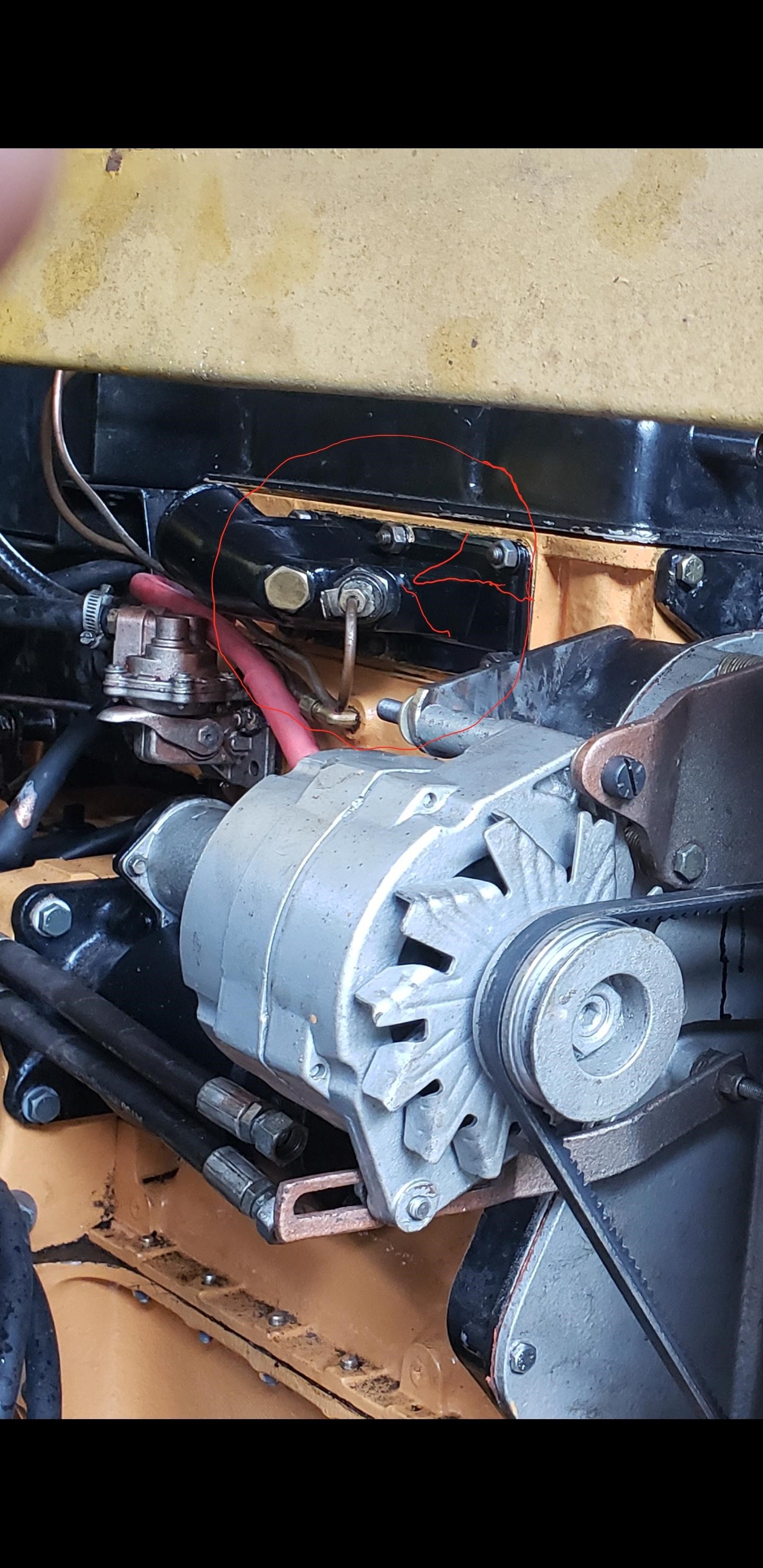

Mine doesn't have the heater on it. No it won't start on it's own after warmed up. I let it run about 10 minutes and it wouldn't start back up on it's own.
/ Massey Ferguson 135 issues #18
Your tractor sat for a time and has unknown history. The injection pump is a lot more complicated than a carb.. It controls timing of injection. If you want to have dependable starting and running , start with an injection pump rebuild. The fact that it will run is a plus. Even if your engine ends up needing a rebuild you need an injection pump that you know is working right. Its money well spent.
There is a forum member thepumpguySC that rebuilds pumps. You wont find a more trustworthy fair guy to rebuild your pump. Google him.
No heater ??? Look on the intake for a wire connection and a small fuel tubing going too it
/ Massey Ferguson 135 issues #19
Yours could very well be different. Inside the red circle is a manifold hearer that's fed by diesel fuel. Not a block heater. The wire is off of the one pictured
