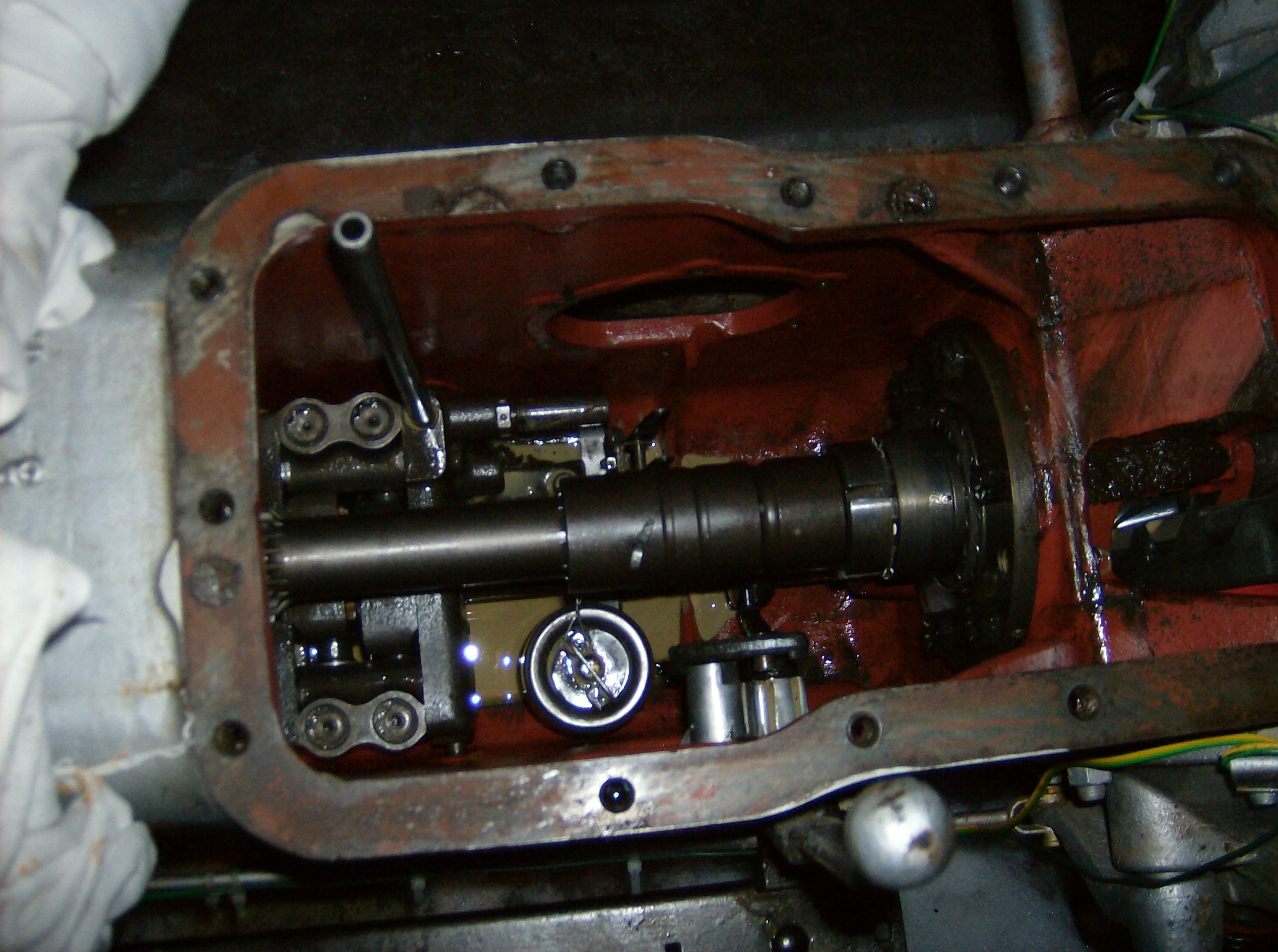

I have a 135 MF 1970, my problem is the three point it will lift but lowers itself back down with the eweight of the rear blade or just me standing on the lift arms, Im sure its a seal or gasket maybe a check valve, obviously my 41 Farmall H has no three point so this new to me any and all ifo would be appreciated.
   / Massey Ferguson 135 or 150 #43
Is it lowering after you shut down or while the tractor is running? I asked a similar question after I bought ours and was told it is not uncommon for the older MFs to do that. Mine will lower to the ground within 15-20 minutes of shutting down with a 7 ft blade. So long as you have good control while running and it isn't dropping quickly after shutting down I wouldn't think you have a serious problem.
   / Massey Ferguson 135 or 150 #44
This one will raise the back blade about a foot then it stops and slowly lowers down with the lever still pulled up and engine running.
   / Massey Ferguson 135 or 150 #45
Apologies MasseyWV for hijacking the post.

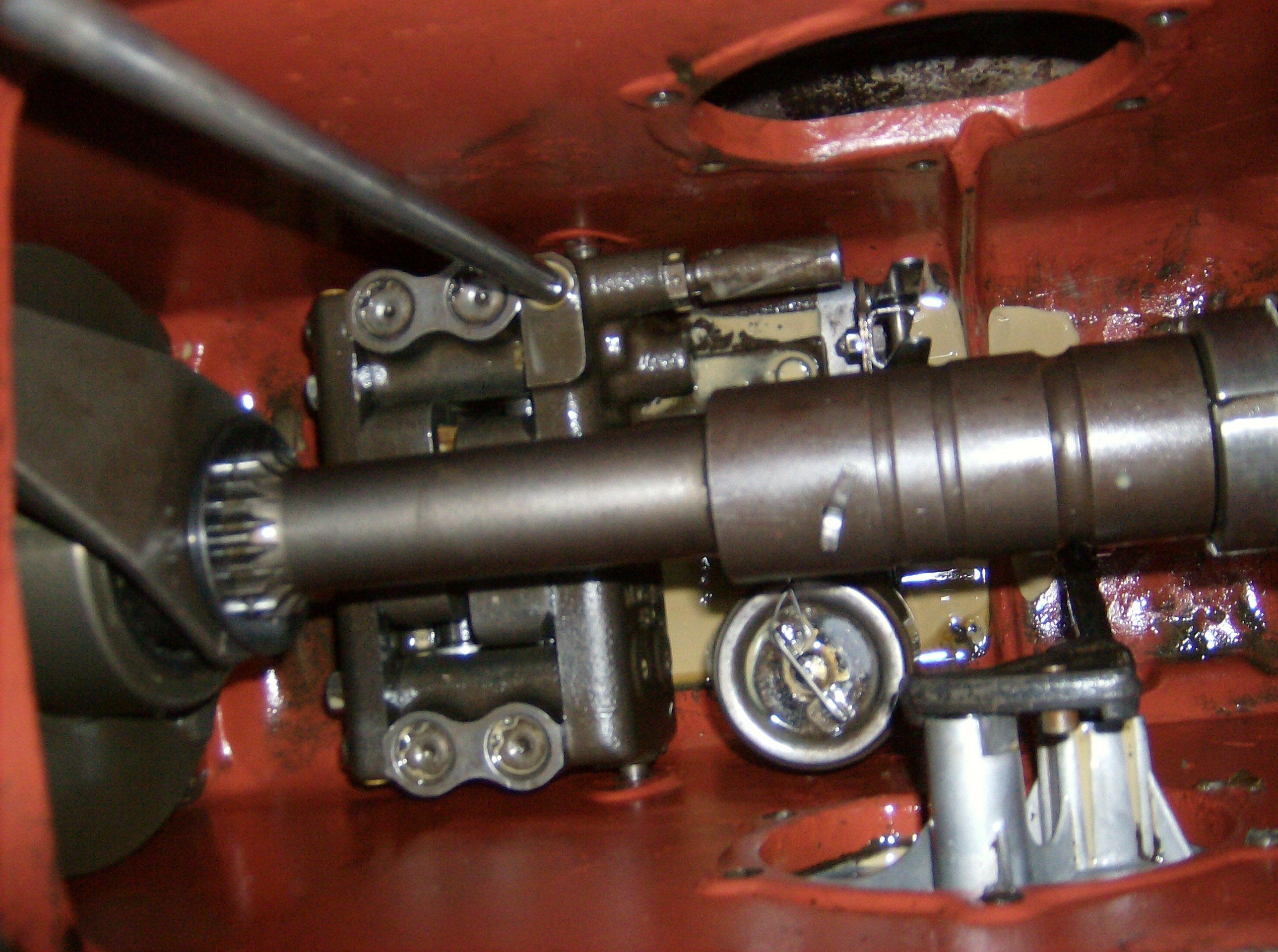

This is the third time this week I've responded to people with MFs experiencing 3PH problems. I would suggest if you have a small inspection mirror, remove the hyd filler cap and look into the case to see if you have a fountain of fluid spraying down from the standpipe where it sits in the divertor valve like mine did. There should be no fluid coming from it at all.
I don't like telling people to run their tractor while standing beside it, exercise caution as it is VERY dangerous. I'm too old to fold down that far and see what I needed to see from the seat, you may be able to.
If you see fluid then you'll need to replace the seals. You can do it with the valve removed without having to remove the top cover. When re-installing the standppe into the pump be sure to stop once you feel the o-ring seat into the groove in the pump. If you bottom out the standpipe into the pump you will restrict the fluid travelling up the standpipe and not be able to get a good seat of the seal into the divertor valve.
If there isn't fluid leaking fro the top take note of the colour of your hyd fluid, mine was contaminated with both water through aged and cracked shift lever boots (mine is outside under tarps at all time but I do use it when raining if need be) as well as excess grease from my excessive greasing of the 3PH levers, that's right, the excess falls right into the case. The hyd oil was brown and soapy from the water, my filter was clogged with grease. It was a wonder my 3PH was working at all. Changed the o-rings, shift lever boots, filter and replaced the oil and it works better than it had since I purchased it.
Hope the attached photos help orient yourself, let us know how you make out.

Thank You Mike:
The pics are a great help in seeing the stand tube and where to look. This tractor has sat outside year after year uncovered and may be the water in the case is whats going on I'll tie into it this week.either way it runs and has some implements diesel power steering ,and good tires for 2000 I cant go to far wrong. I am anxious to look in there.
