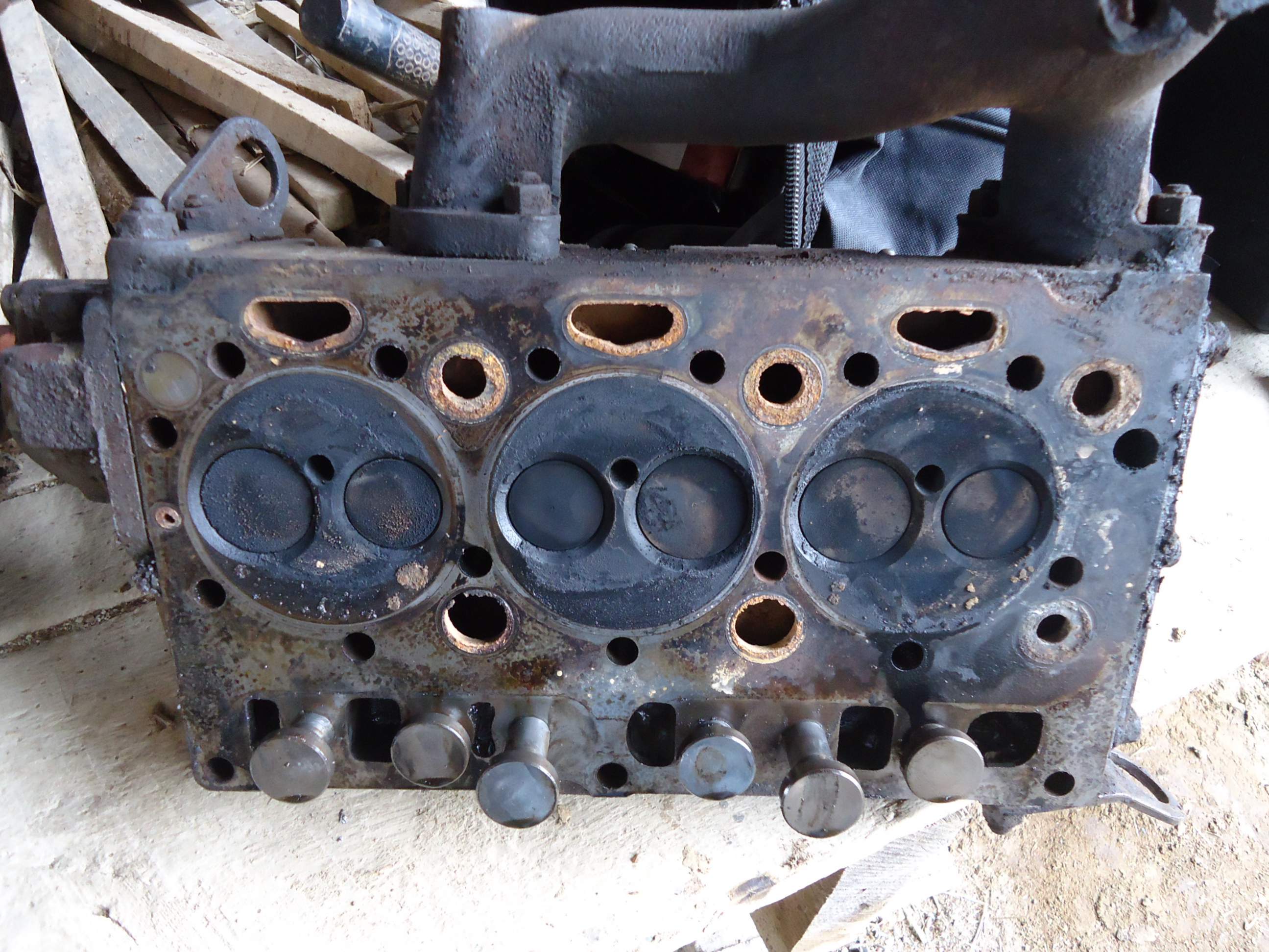

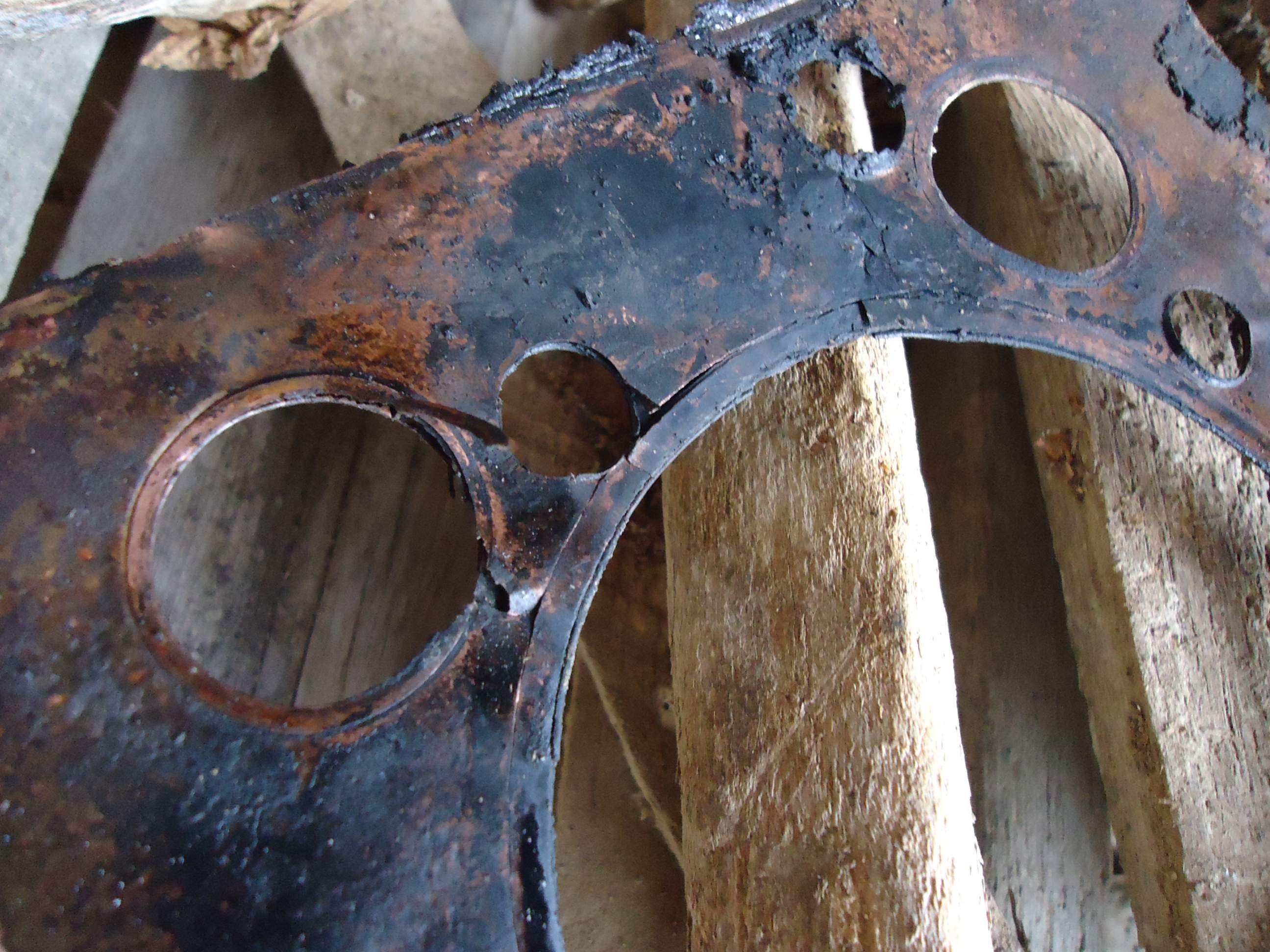

Perfect. The picture you posted was just what I needed. I got them all out and the cyl. head is OFF! :)
I found the offending area. It burned from the fire ring to a hole in the water jacket. WHEW!
I'm glad it was the gasket and not a crack in the block! SO after I get it all cleaned out, Im going to have it tested for straightness and get the valves reseated or replaced. Will have to see how bad it is.
I will then move to the water pump, oil pump, front crank oil seal and then also, I have a leak between the cylindrical part of the injector pump and the rectangular portion that sits on top of the main body. (the part where the throttle goes into) Fuel oozes out. There are the two studs coming up (the part with wire and lead seal holding them as tamper evident)

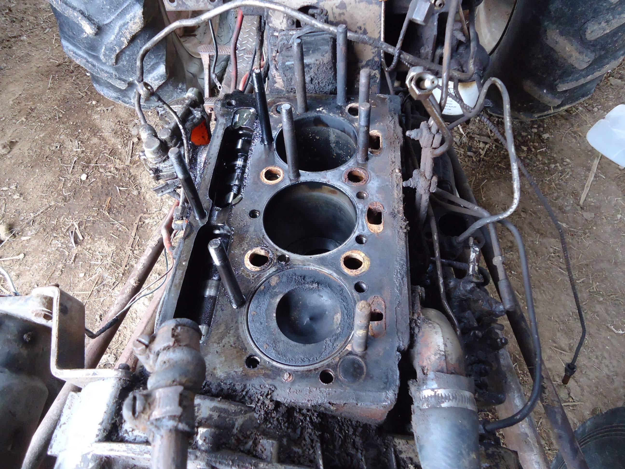

The appearance of the cylinder walls really doesn't mean much unless they are scratched. The only way to be certain of their condition is to use a bore gauge to measure them in four places ("X" cross-section) at the top, middle, and bottom of the bore, noting each measurement as you go, for a total of at least 6 measurements for each cylinder. The cylinders tend to become tapered or out of round as they wear. How do the ridges at the top of each cylinder look? Did you measure the compression for each cylinder prior to dis-assembly?
The blue smoke is caused by poor oil control, either due to the valve seals, valve guides, oil control rings, or any combination of the three. The valves themselves would not cause poor oil control unless the valve stems were heavily worn, which would necessitate the need to replace the valve guides anyway.

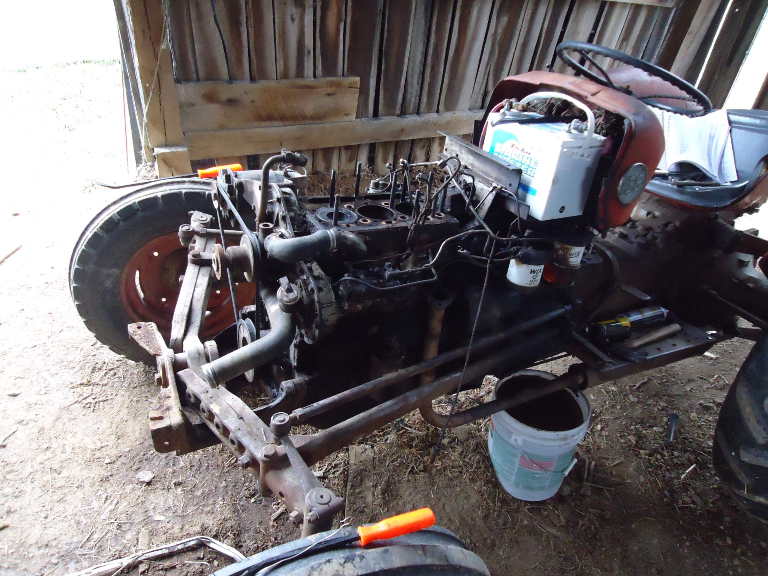

Massey, Yes TONS of carbon build up. Prob due to burning so much excess oil. A vicious downward cycle. I am posting pictures of the progress and how far I am in the tear down.
I do not plan on removing pistons at the moment because I dont want to drop the oil pan. Again, I am going back to my poor working conditions. As you can see I am in a dirt floor barn.
I am going to take my entire head to a machine shop and have it checked for straightness and also to work my valve seals, guides and such. I am just going to pay to have it done because of time and also lack of some of the tools needed.
Here are some pictures and I will also post the serial # in the next day or so
