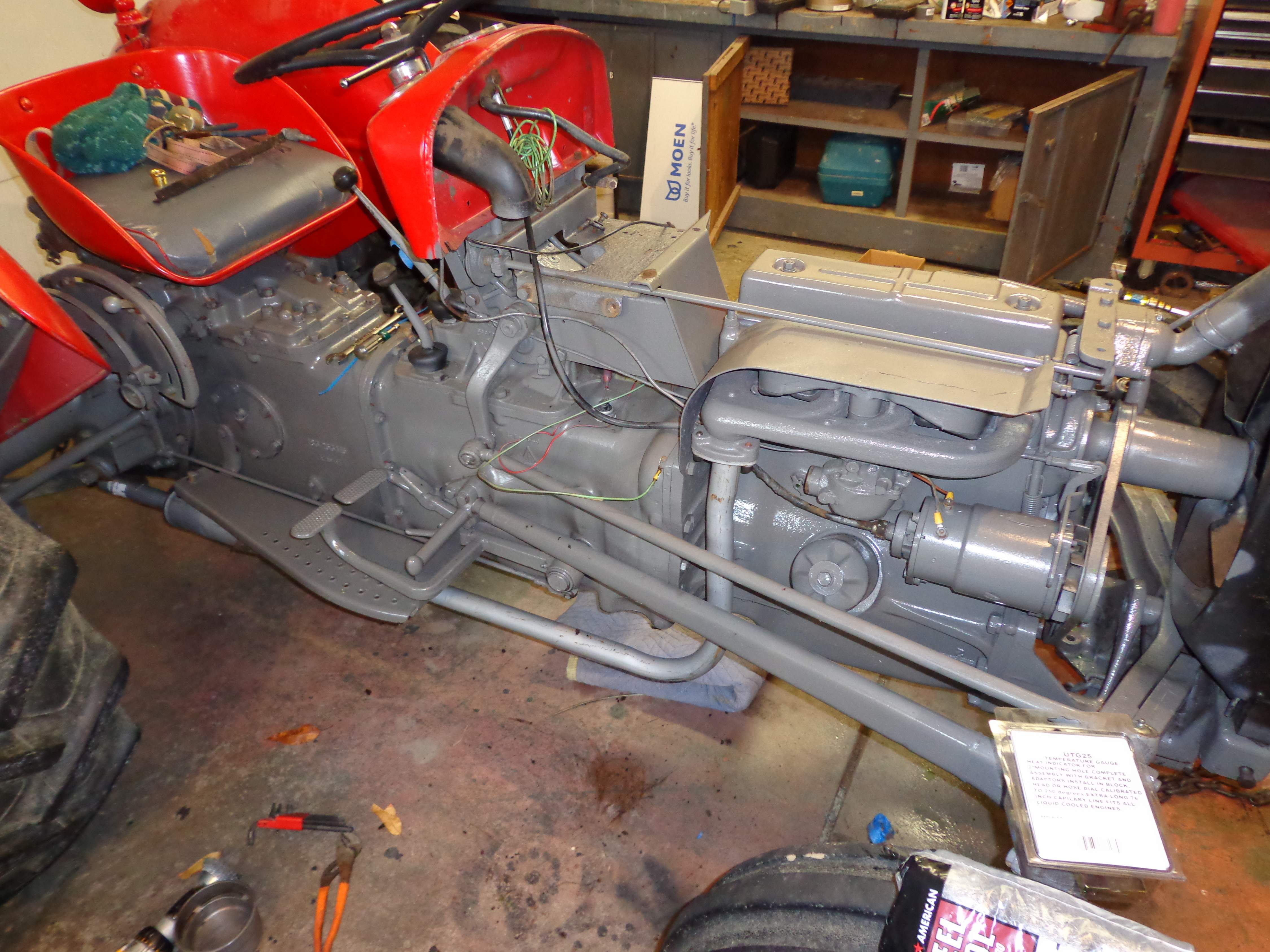

196.jpgAt this point just support the center of the tractor and drop the front end, remove the motor, set up a semi clean work bench /floor and do the whole thing.. A machine shop can resize the rods, check the crank and even reassemble it. Then you just put her back together.... Finished my mf35 last fall 182.jpg

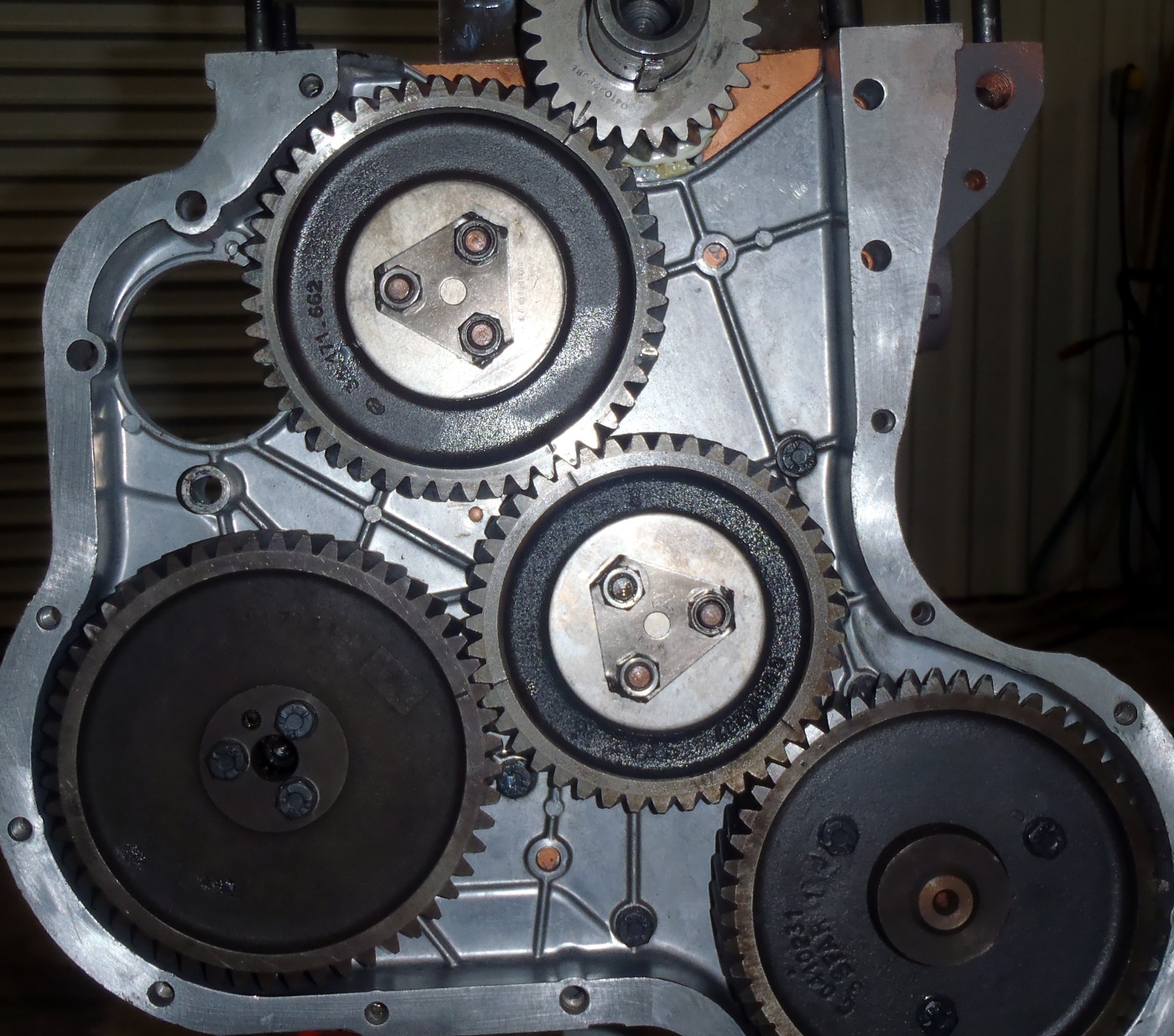

   / Massey Ferguson 135 Rebuild Journey (diesel) #30
Timing of my AD4.203, big brother to your engine
