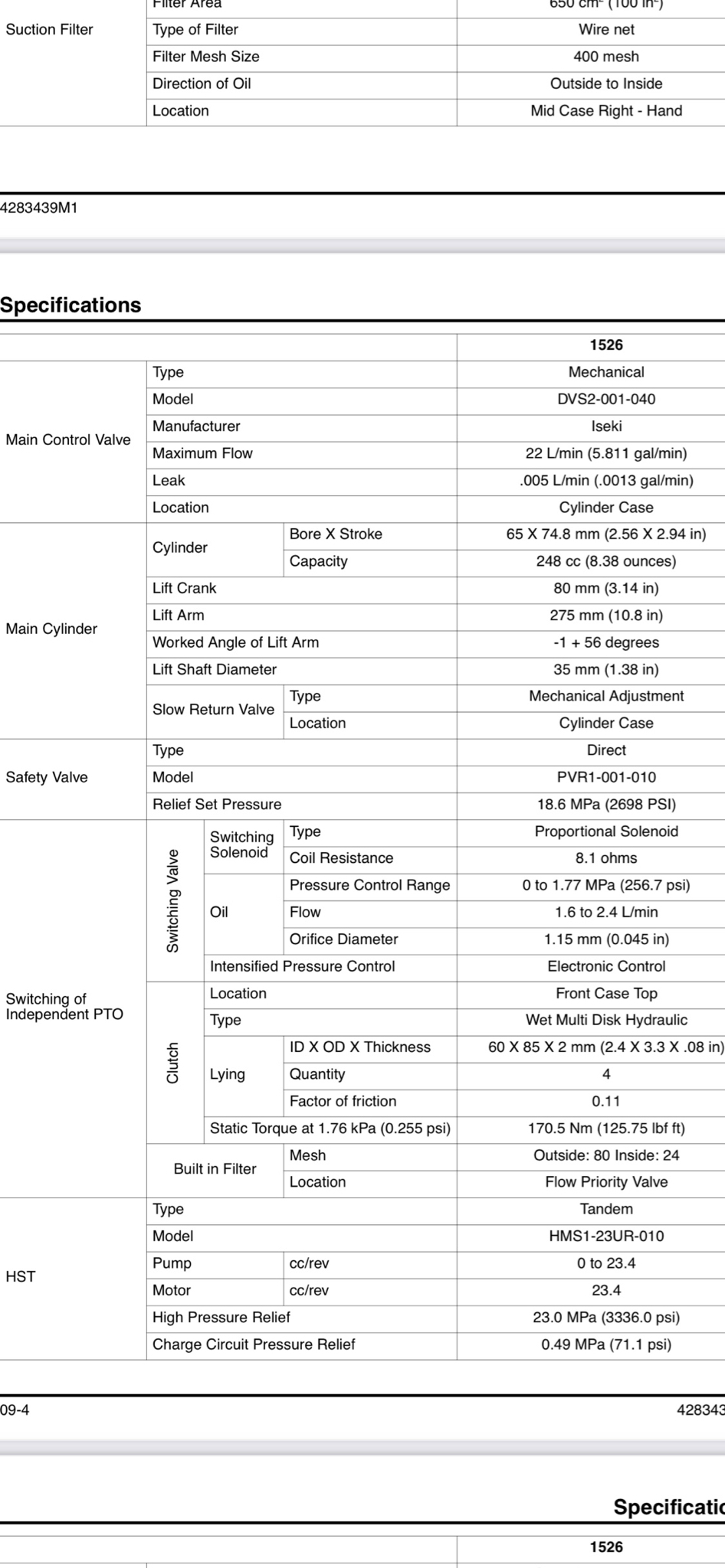

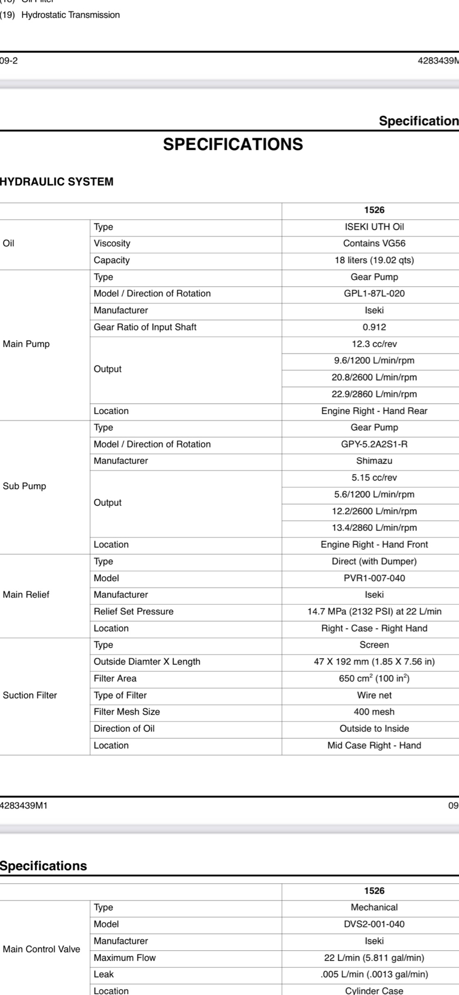

I just spoke to Nimco apparently they say there is no main relief valve in my loader valve it was hard to understand him he had a strong accent but I said I removed a cap and there was a spring in it on the left side of the joystick so I’m gonna send them some pics tonight and see what they say and they said they will NOT share any schematics or drawings so how would I get parts for it ?? Then they said to order a new valve would be $766 plus shipping and it’s 16-20 weeks smh anyone have a good replacement valve I can get a little cheaper and quicker ?it’s a CV-112 and the number on my valve is 11817-2S
