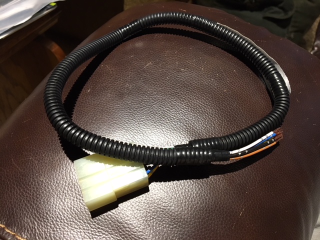

I tipped the seat up and found a small compartment on the back wall they seem to call a tool box. I found a short wiring harness with a plastic connector on one end and 6 bare wires on the other end. What is this for? It has a number on the harness 17276669000-0, but a search of the online parts manual resulted in no matches.

My best guess is I believe that is your harness to connect a radio that does not have a plug which matches what's prewired on your tractor.
