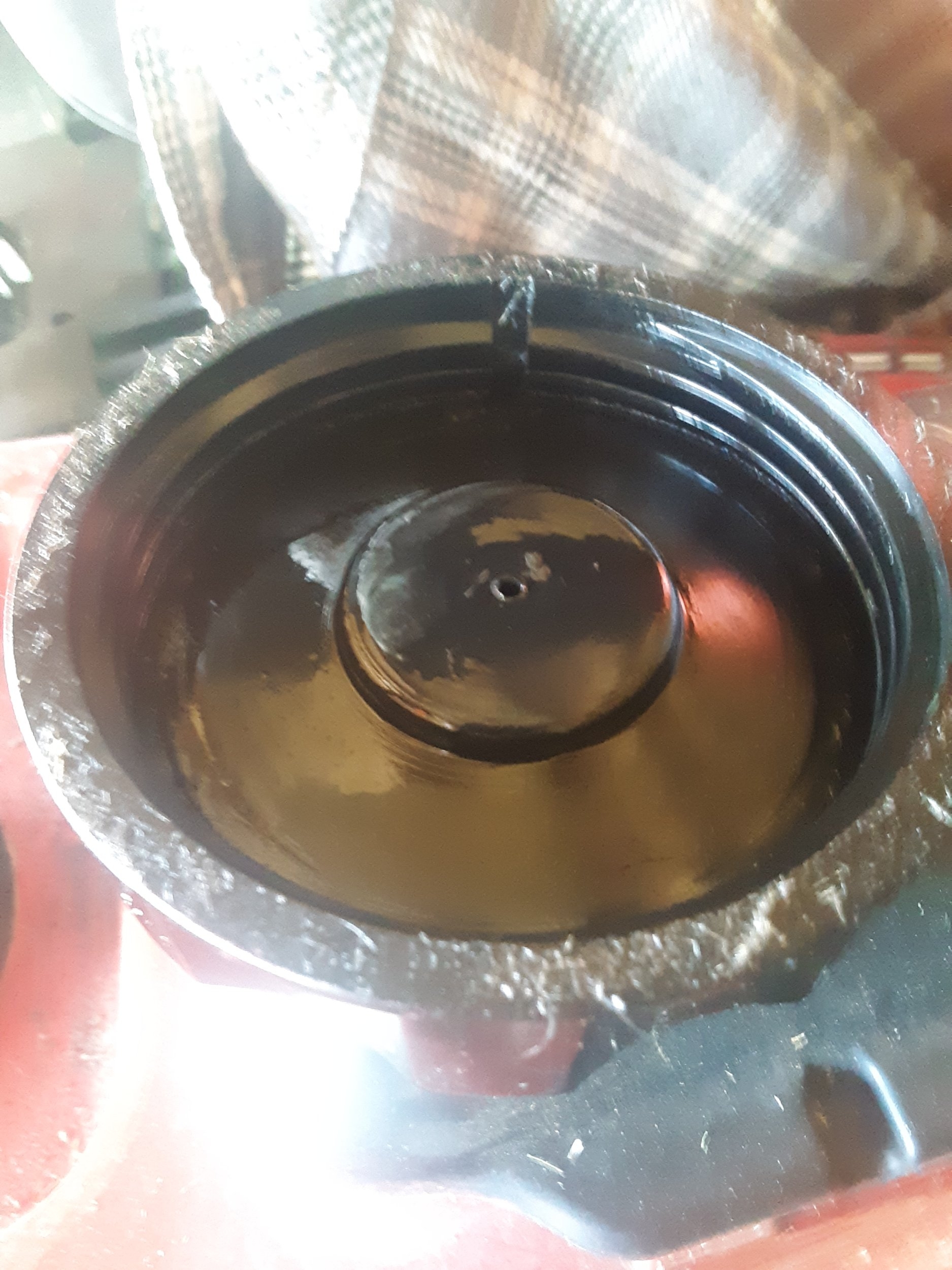

I went out and looked at the fuel tank and cap area. I see the overflow (back into tank) opening but I don't know where or what to look for as far as a vent goes. Is it built into the cap? I see no openings on the top of the cap.

should be built into cap and most likely is hard to see.
run it, when it starts to fail leave running and pull fuel cap. wait moment then try working it. will rule out (most likely) vent issue.
as wranglerx mentioned could be collapsing /porous fuel line.

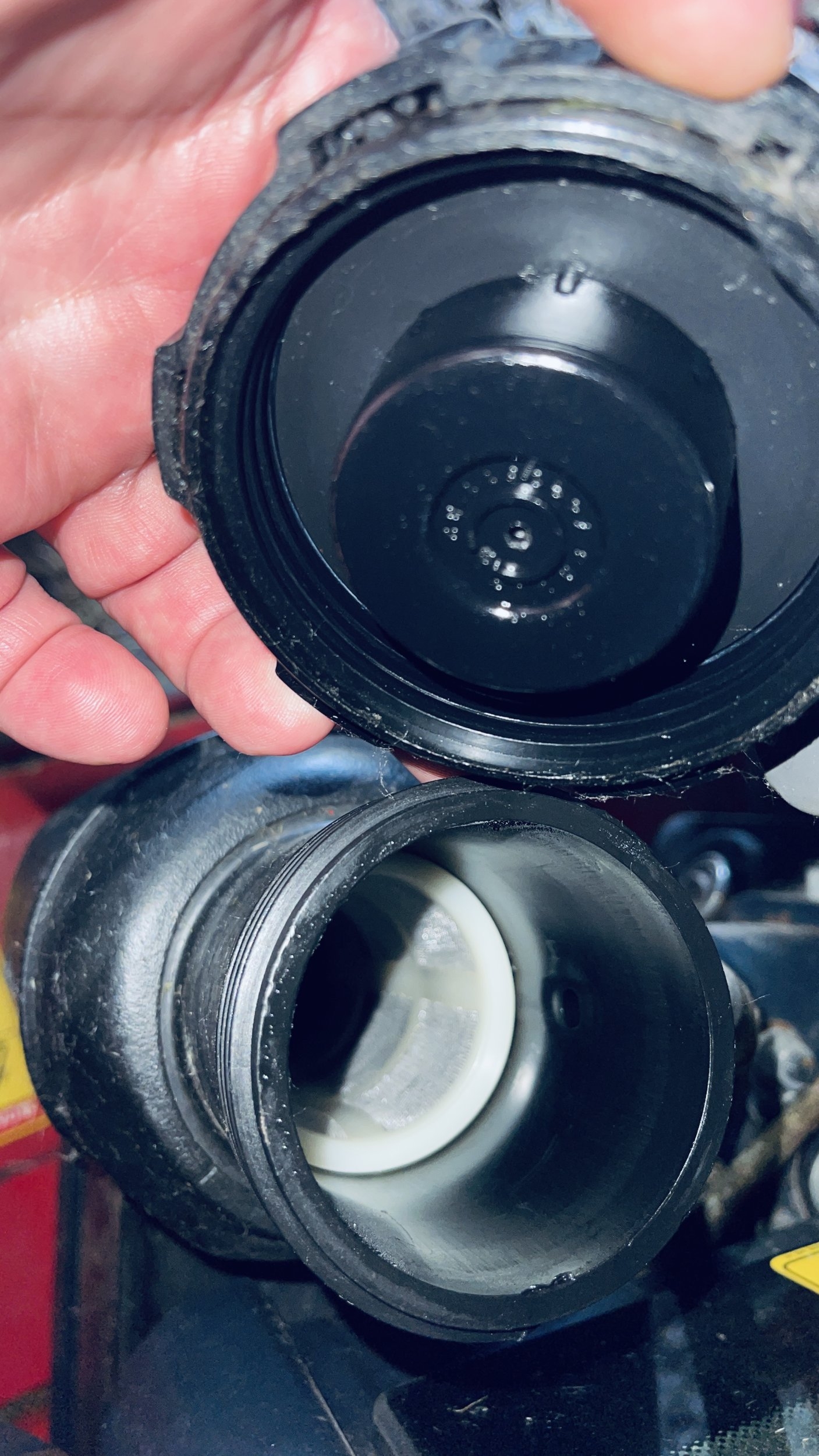

Your cap is different than mine and I can't see the entire thing. Looking at the picture of mine, see the shallow grove in the cap at the top of the image, this allows air up under the cap and above the rubber seal. The hole in the center of the cap allows the air to flow into the tank.
But Dave is right, to eliminate a blocked vent, if you unscrew the cap when the tractor acts up and power returns then the vent is blocked, or even partially blocked.
