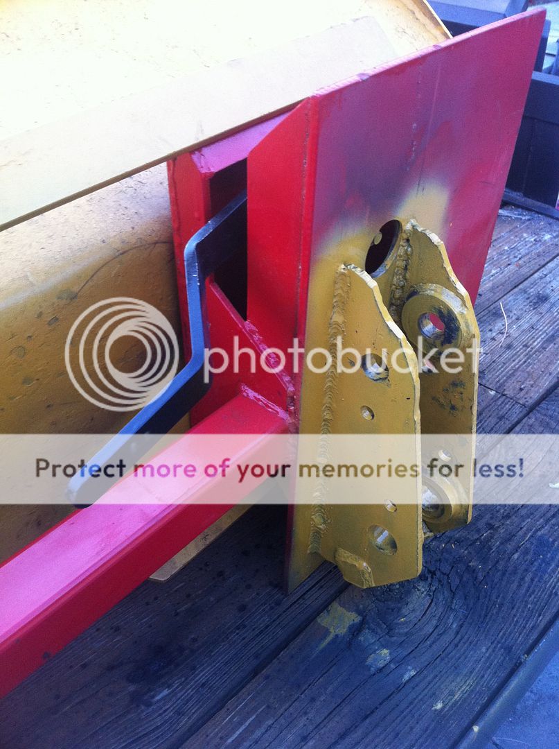

Attachment is all welded up and rattle caned for now.
This side was tricky cause there was a 1/4 inch gap between the ears and the attachment. Had to go over it a few times to add metal.
Down the road when I get my new place setup ill come back and make a new set of ears and do a better job on it.
