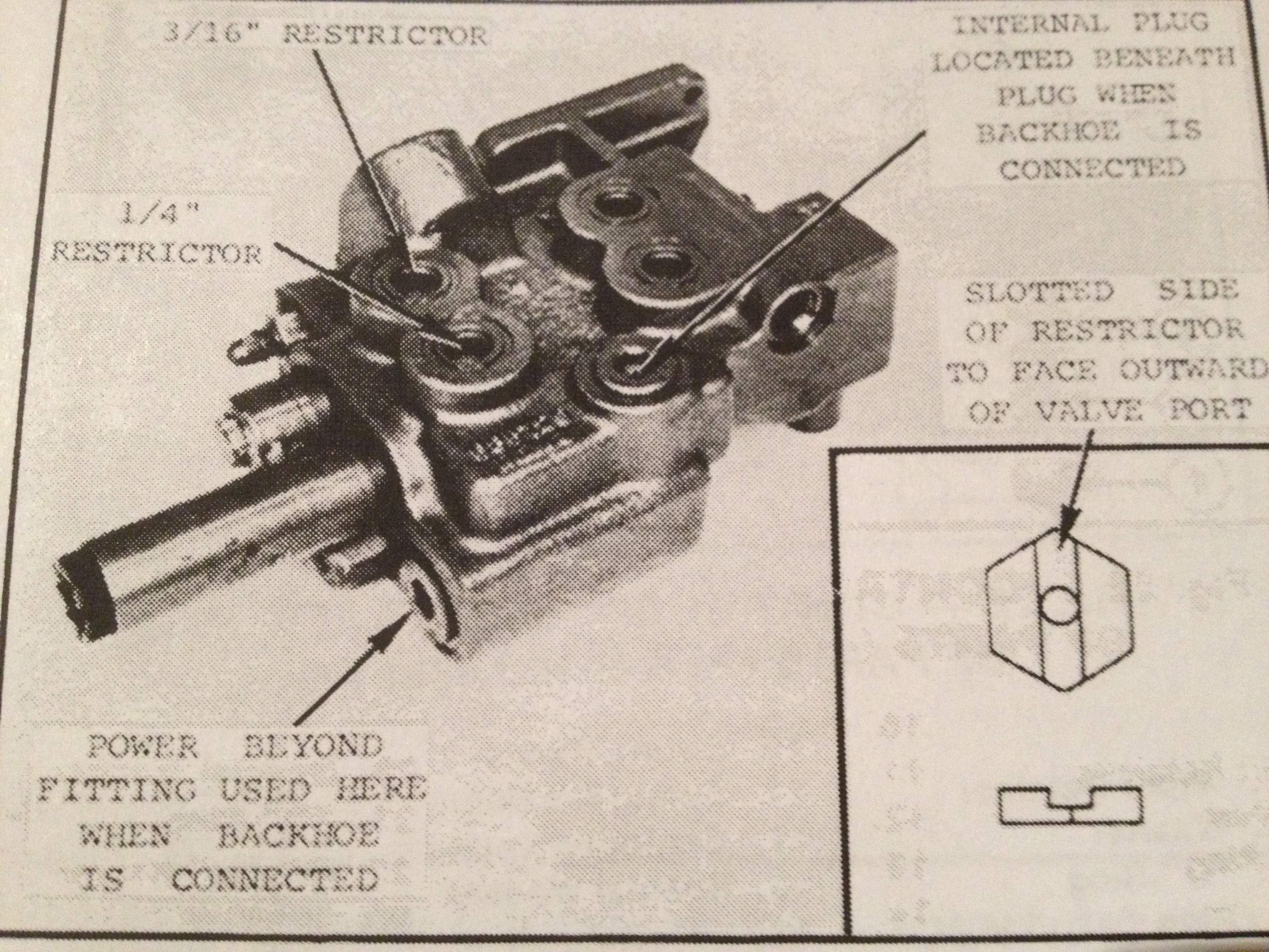

The port is just a straight cylinder no holes at all as far up as I can reach with my finger. There is an internal plug (actually only threads for an internal plug at this point), behind another plug, all the way at the top of the PB port cylinder.
So, I think I just need the plug and the fitting, which I have ordered. Maybe, I am confusing you with the terms Adapter and Fitting. I don't think this one uses an "adapter" like your picture only the plug and fitting.

Let me chime in here, I had a similar problem when I was changing the remote valve on my MF50c with a 300A Loader. http://www.tractorbynet.com/forums/hydraulics/235635-replacement-directional-control-valve.html
I found that my old remote valve was connected to the PB port on the loader valve by a SAE14 ORB to SAE14 JIC connector.
As you pointed out, finding a SAE14 connector or fitting is near to impossible. To make things even more complicated, the Parker Hannifin valve used on my 300A loader, doesn't use the kind of PB adapter that JJ posted a pic of, in one of the posts above. 2013-09-27 20.51.46.jpg
It seems to use a standard connector,while putting an internal plug in another port.
I hope I was clear in my explanation. And I do hope it was helpful.

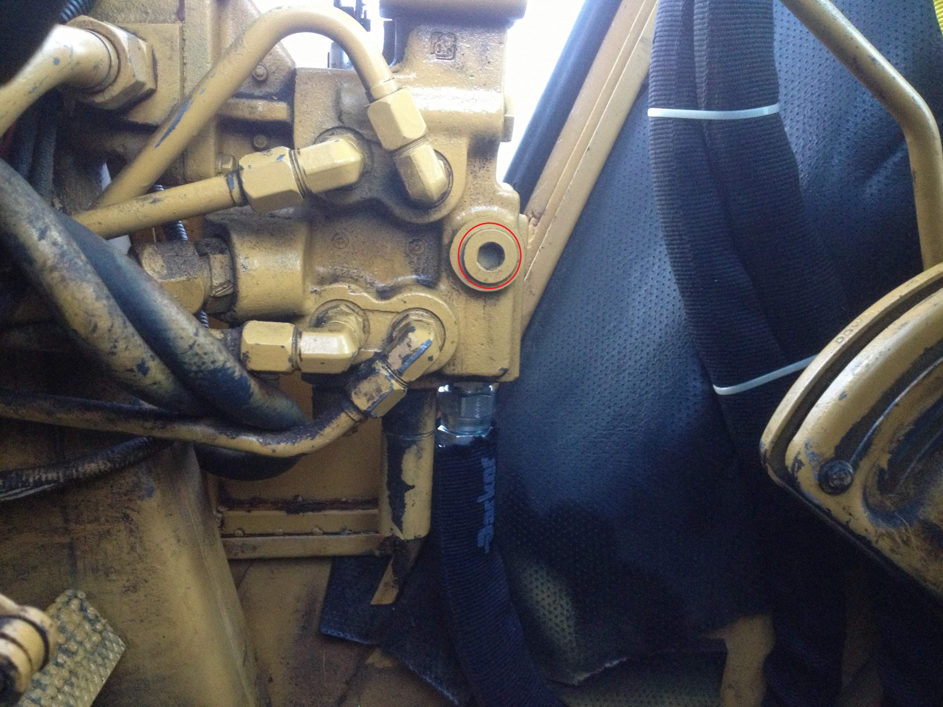

Seeing as you haven't found the plug (if one is installed), have you tried looking in one of the other ports, like the one shown in this picture.
If the power beyond port was used there should be an internal plug under here. I highlighted the plug in the second pic.
Hope this helps

Yeah, I have already opened that plug. The internal plug was not in there, just the threaded hole for it. I have the PB fitting and the plug on order. Just talked to the dealer today, he had them in his hand so I asked him to mail them to me.
Everything is good, just waiting on my parts to come in. :)
