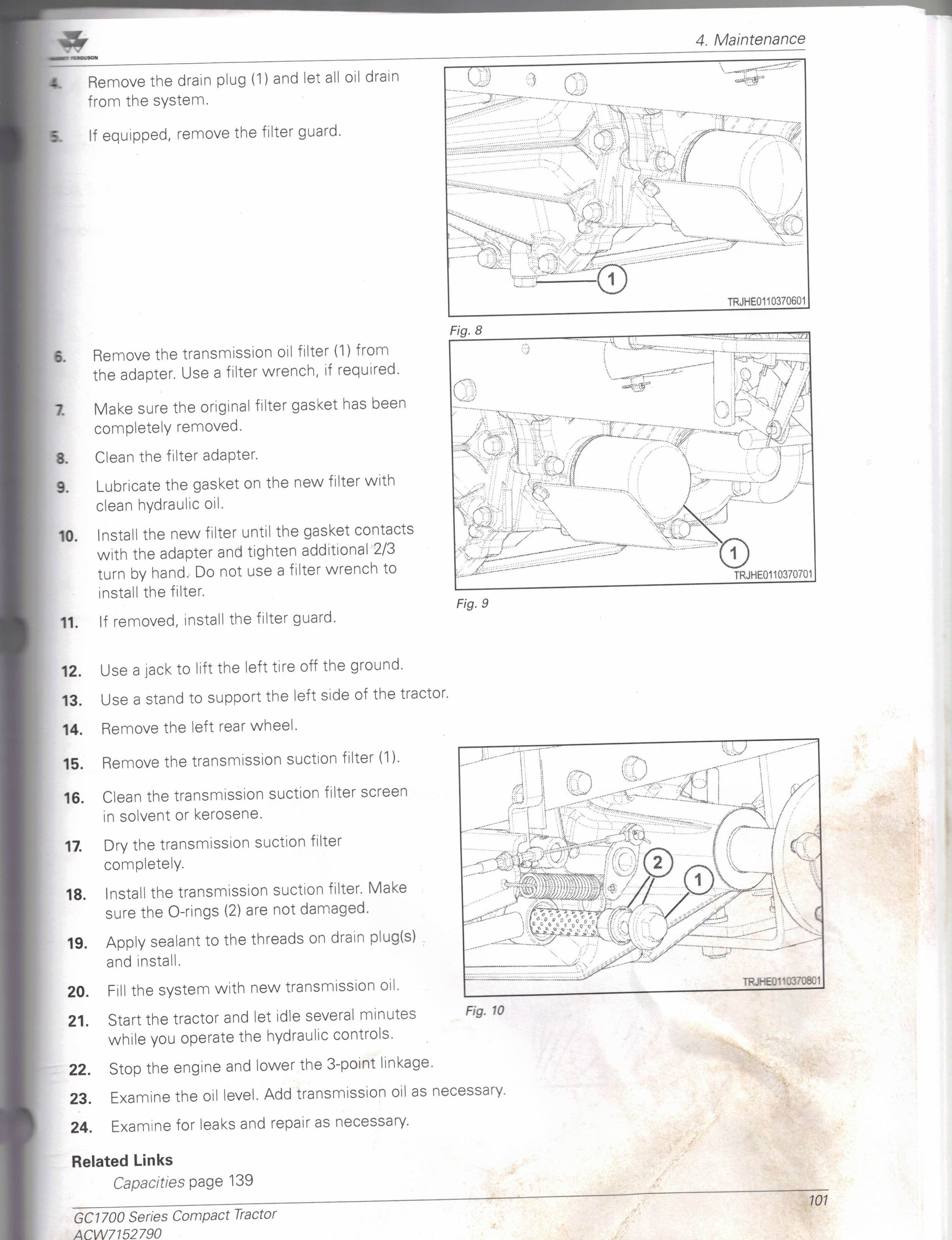

Drove over 110 miles today. The only Massey Dealer stocking Permatran 821XL Fluid. OUCH Cost over $120 for 5 gallons which was a bargin compard to Amsoil for $233 (AMSOIL Synthetic Tractor Hydraulic/Transmission Oil SAE 5W-3)
