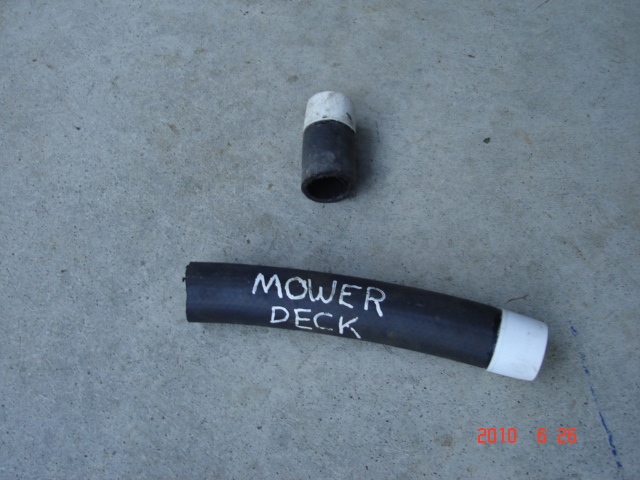

I did the same thing for my other PTO shafts-- used 1" heater hose with a plastic spray can top glued to the end. The slight curvature of the heater hose holds it on nicely.
