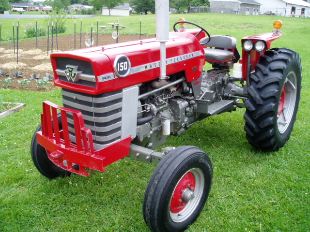

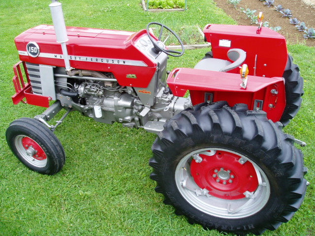

Here's a few pics of my 150. 1971, Perkins diesel, 4X2 tranny, just over 3500hrs, owned it since new. Most reliable, efficient piece of equipment I've ever been around!

Your tractor looks great!!
