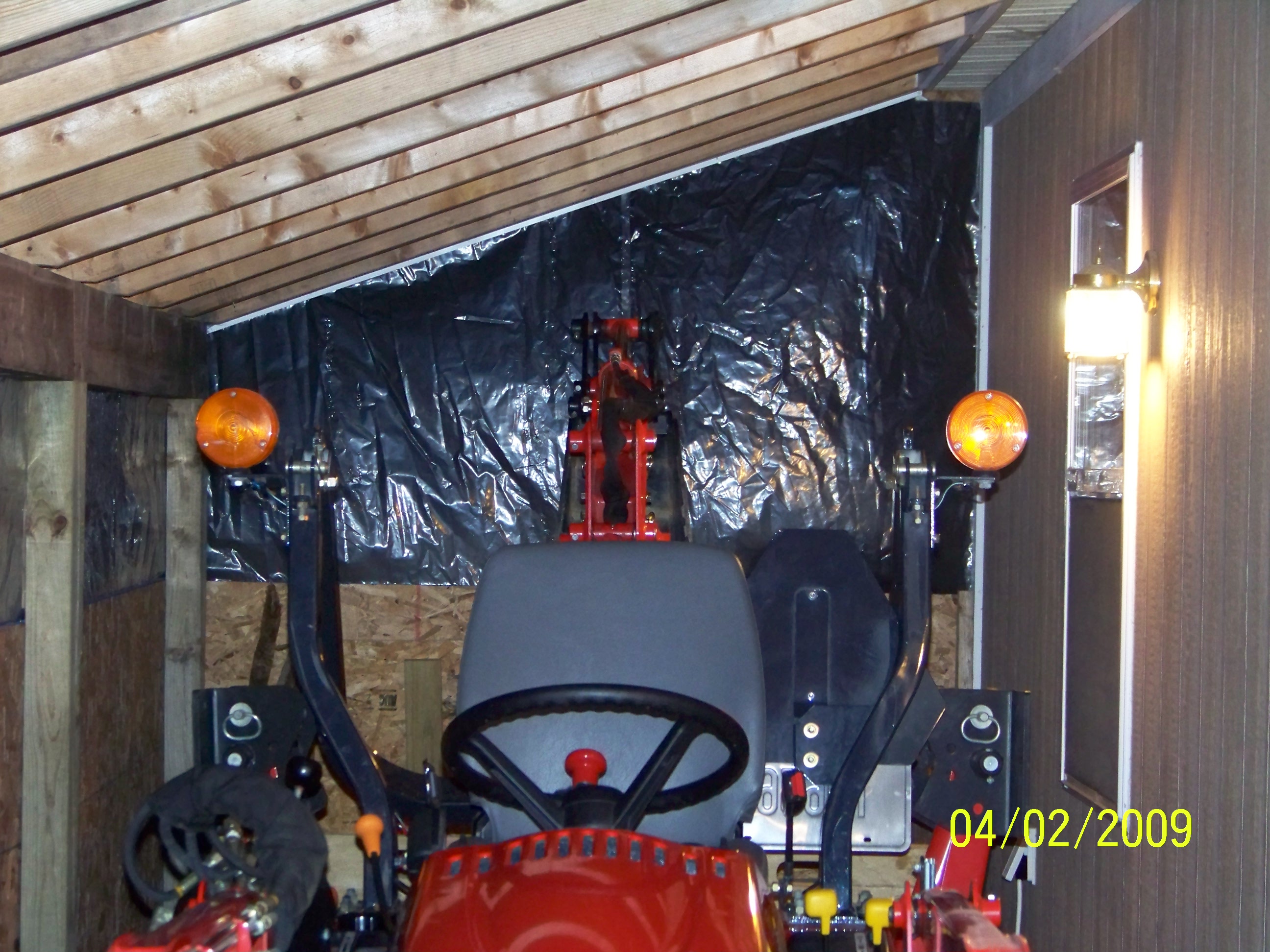

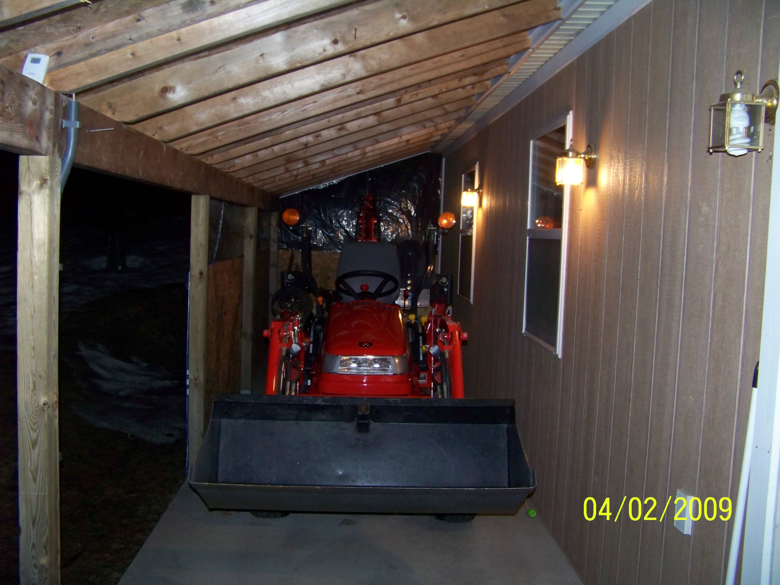

JMynes-- obviously, you've stirred up some interest here....
Yes, I have the 2310 also. The place where I park it is under a shed-roof attachment to my garage, and it LOOKS like it might just fit!
However, the ROPS has to be folded down in order for me to fit the tractor in there. There's about about 78-79" of clearance from the floor up to the roof rafters on the left (lower) side, just inboard of the ROPS.
It doesn't look like your cab attaches to the ROPS, but is that the case? How is it supported? I'll take another look at your pics.

Irvingj,
A picture is truly worth a thousand words. Now that I've seen what you're up against, I will take another picture with a tape measure in it that should give you a real good dimension on that right side.

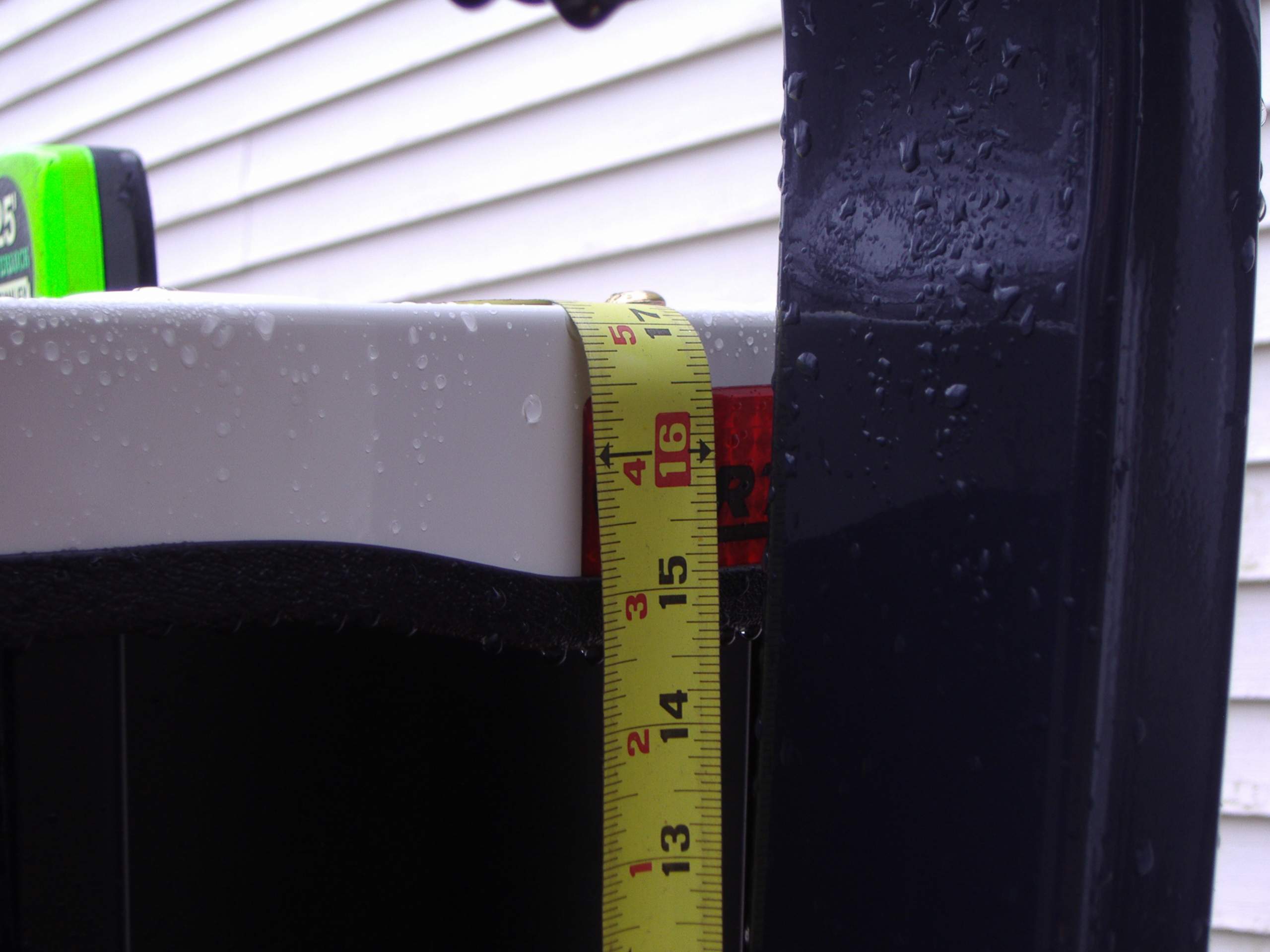

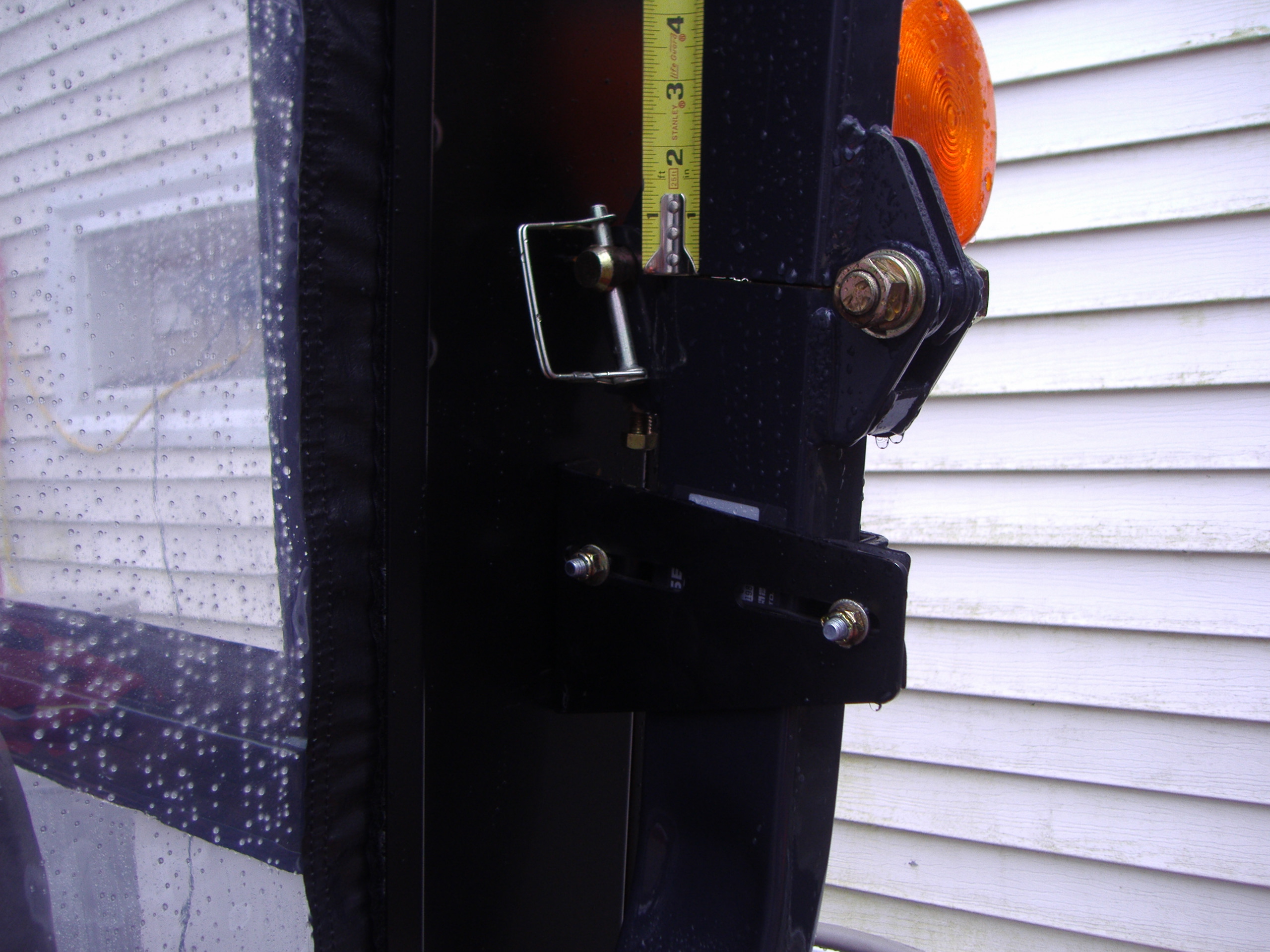

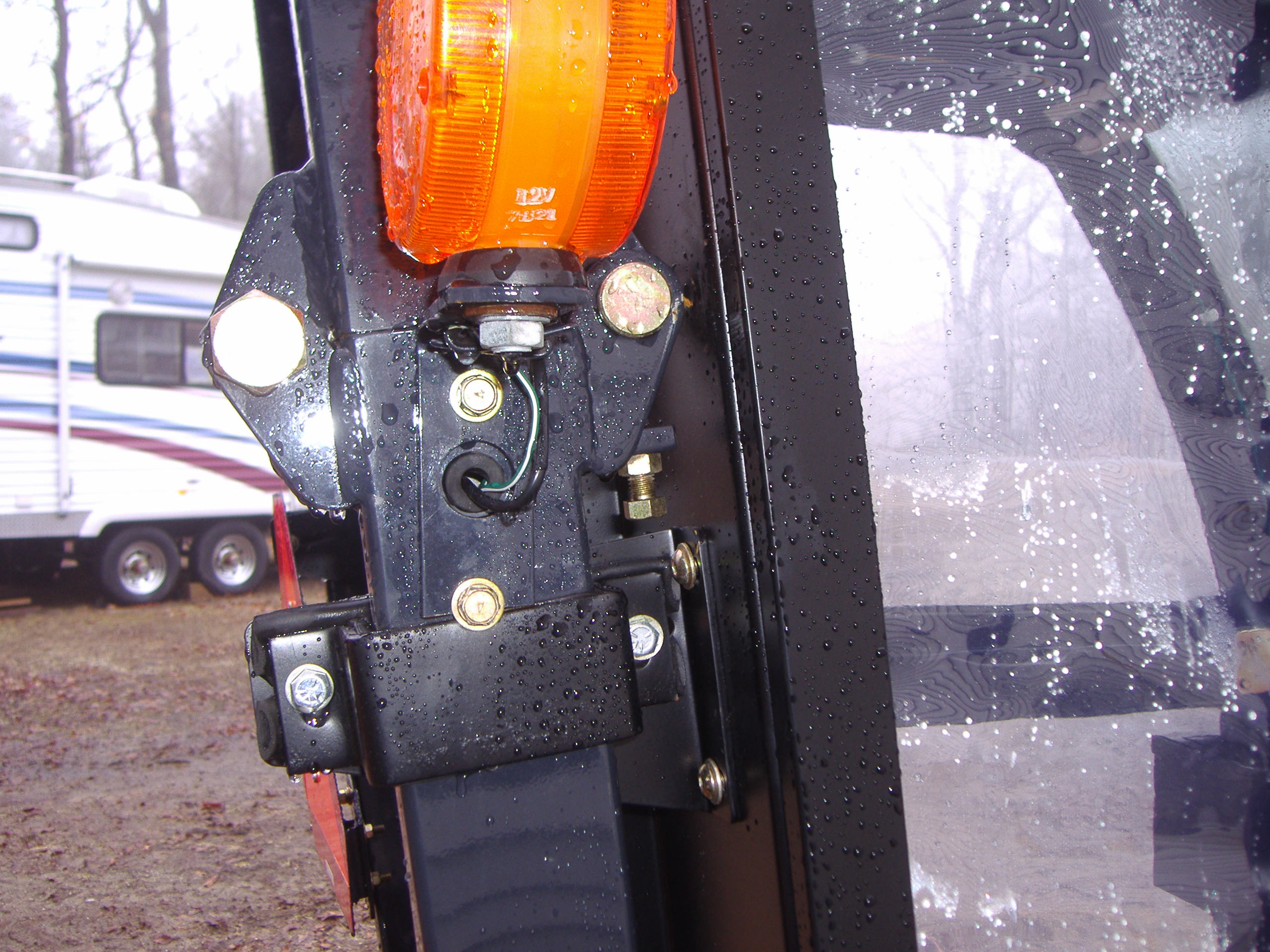

Irvingj, a few pictures that should help.
Bottom of the tape measure is at the ROPS hinge. Roof of the cab is at 17".
The cab is officially for the non-backhoe version, and mounting brackets to clamp to the ROPS are higher and further inboard. New holes were drilled lower to get below the hinge and, of course, further outboard.
The roof extends 2" beyond, wider than, the outer edge of the ROPS. Door hinges and door handles are wider yet, but the widest part of the tractor remains the flasher lights.

I'll check to see if I have clearance to the rafters 17" above hinge line and 2" outboard of the ROPS. Tomorrow. (Dead tired at the moment.)
Thanks for the pics-- I see how the cab top is mounted, "clamped" onto the ROPS. Which new holes did you have to drill?
