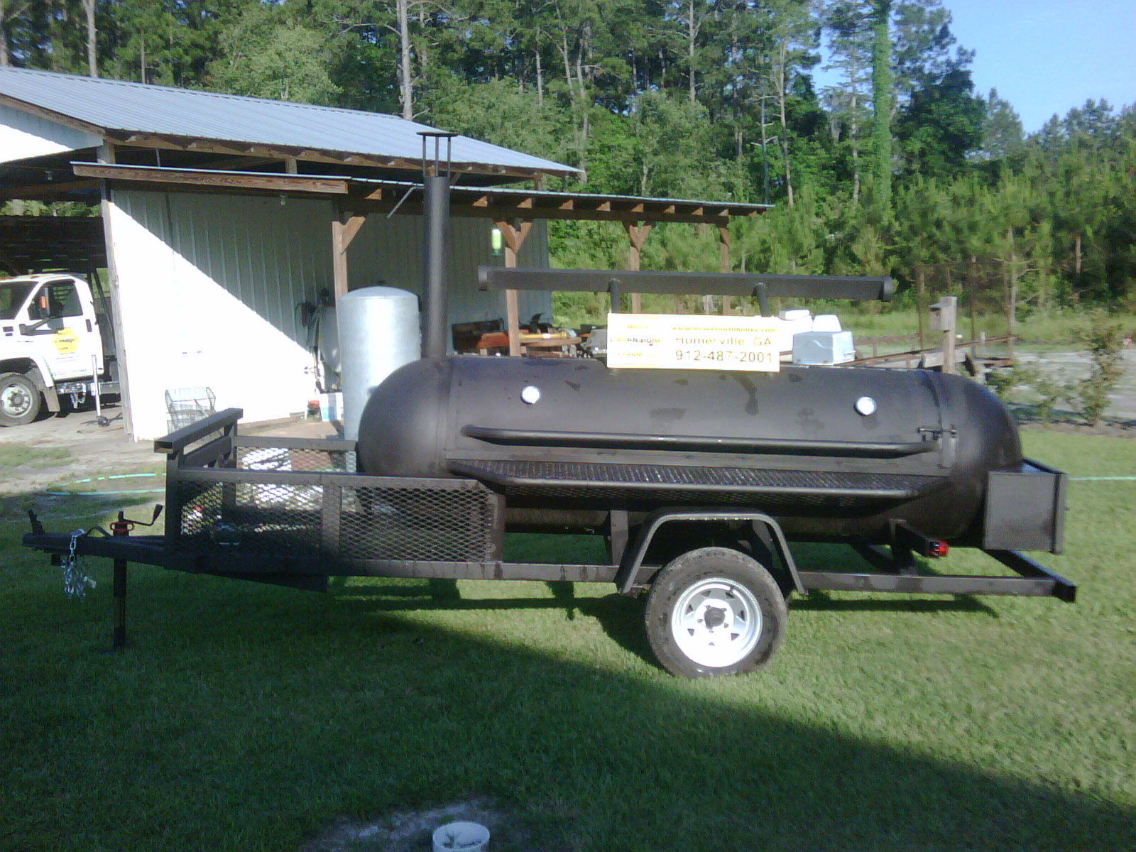

Did I mention BBQ? Well, now I have to post up this...:licking: This is a recent grill I made to a customers specs. But before finishing, it had to be field tested.lol.
