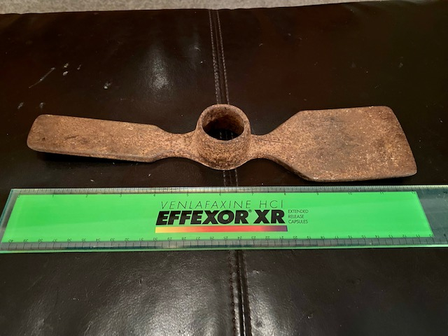

Why are mattocks not fixed on their handles? In other words, why aren't they fitted like axe handles, pick handles and sledge hammer handles? The old mattock I have has two nails in the handle under the head to keep it from slipping down. Been that way since I was a child.
I'm asking because I recently got a mattock head from my father-in-law's garage. It is less than half the size of a normal mattock which is really cool. It has some surface rust but is otherwise in great shape. I'm going to clean it up and make a handle for it. I have a lathe.
The opening for the handle is round but slightly cone shaped like a normal mattock so that the handle is installed from the top and is supposed to snug down on the handle which is also slightly cone shaped.
I'm just wondering if I should install the handle that way or should I consider wedging it like an axe handle.
Any advice appreciated.

Here is a picture of the head. As you can see it is about 12" long. I'm assuming this is a little mattock and not some sort of wood working tool. The edges are not sharp like an adze or something like that. I will probably turn an 18" handle so it can be used with one or two hands. I think it will be handy in the truck tool box or my wife may be able to use it in the garden.
I do not have any hickory but I do have several freshly cut ash logs waiting to be cut on the saw mill. I think ash would work okay. I'll cut out a rough blank but I'm not sure how long the blank will need to dry before I put it on the lathe?

Round handle? Uncommon, pretty cool looking tool.

With no taper in the eye, I don't think that the OP's head was designed for what we consider to be a standard maddock handle. I think that he's right; he needs to build it like an axe handle. By making the handle himself, he can build it with the grain rather than cross grained the way that so many handles seem to be made now.

It is hard to see but there is a taper in the eye. Very gradual. I will try to duplicate it on the lathe and can use the method @etpm mentioned to get it really snug. At that point I may add a wedge like an axe. My son-in-law (who is into axes and such) soaks his axe handles in some sort of oil rather than water to keep them swollen and tight in the eye of the axe. I'll ask him about that.

Ash will work fine, there's no need for it to be dry. If you were closer I'd give you a stick of hickory. The ash will be significantly lighter....
/ Mattock Handles. Why? #20
If he doesn’t dry it first, more shrinkage will occur and the handle will loosen up. I thought the purpose of this thread was to decide the best way to keep that from happening.
