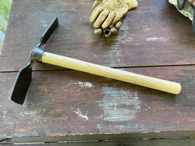

Follow up to post #9 above. Cut a blank from the ash slab. Dried it over a heater vent for a week or so. Turned handle on the lathe. The handle hole is round and tapered. The ash was very hard. Took a long time to cut it down. Got a little tear out in a few places but sanded it smooth. Made handle long enough to use with two hands if needed. It is a fairly small tool and I gave it to my wife for her gardening. The handle is in the head firmly but I put a stainless screw in just in case.

I thought about narrowing it in the middle down through the grip for better appearance and lighter weight but figured I’d keep it thick for better strength.

That came out good! 👍

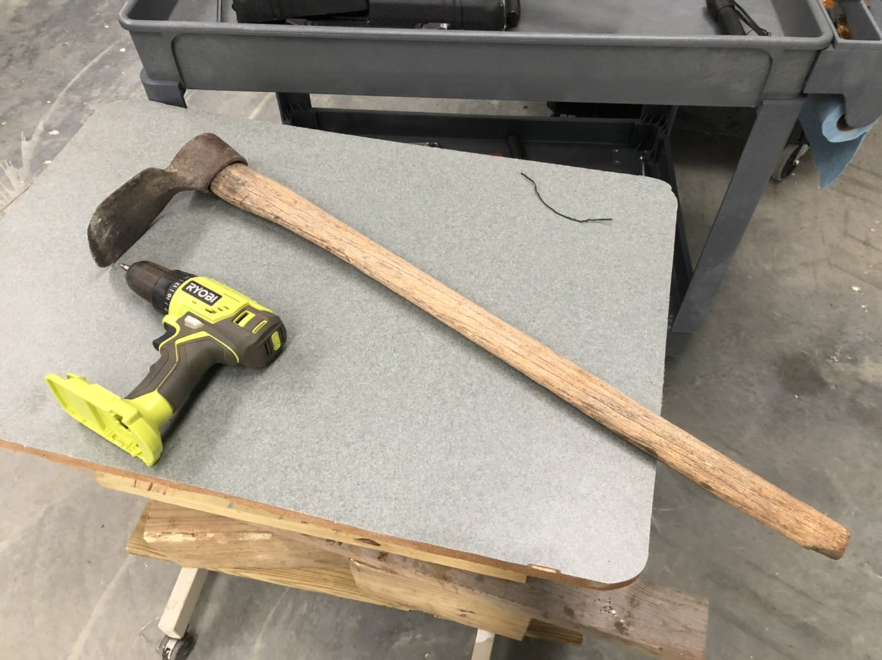

I think this is called a grub hoe. It has probably been in my family for 80+ years. The handle is pretty loose and looks fragile. Sort of want to keep it as is.
