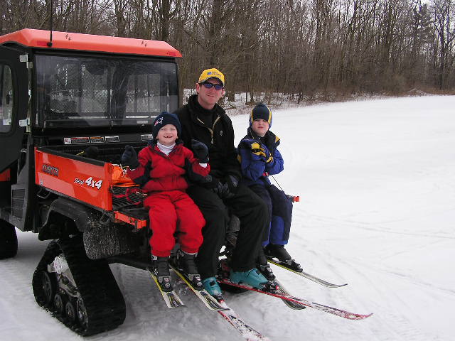

Please post a picture of the tracks you have. Are you sure they are Mattracks and not some cheap copy. I have sold many sets of Mattracks and have NEVER had this happen to any tracks Ive sold. I also talked to the factory and this is news to them. I am currently getting ready to put a set on M3 Mattracks on a 1100. I used a 900 to groom snowmobile trails with all last year and the tracks were flawless. Here is a pic of me and the kids using the RTV to bring us back up the hill
