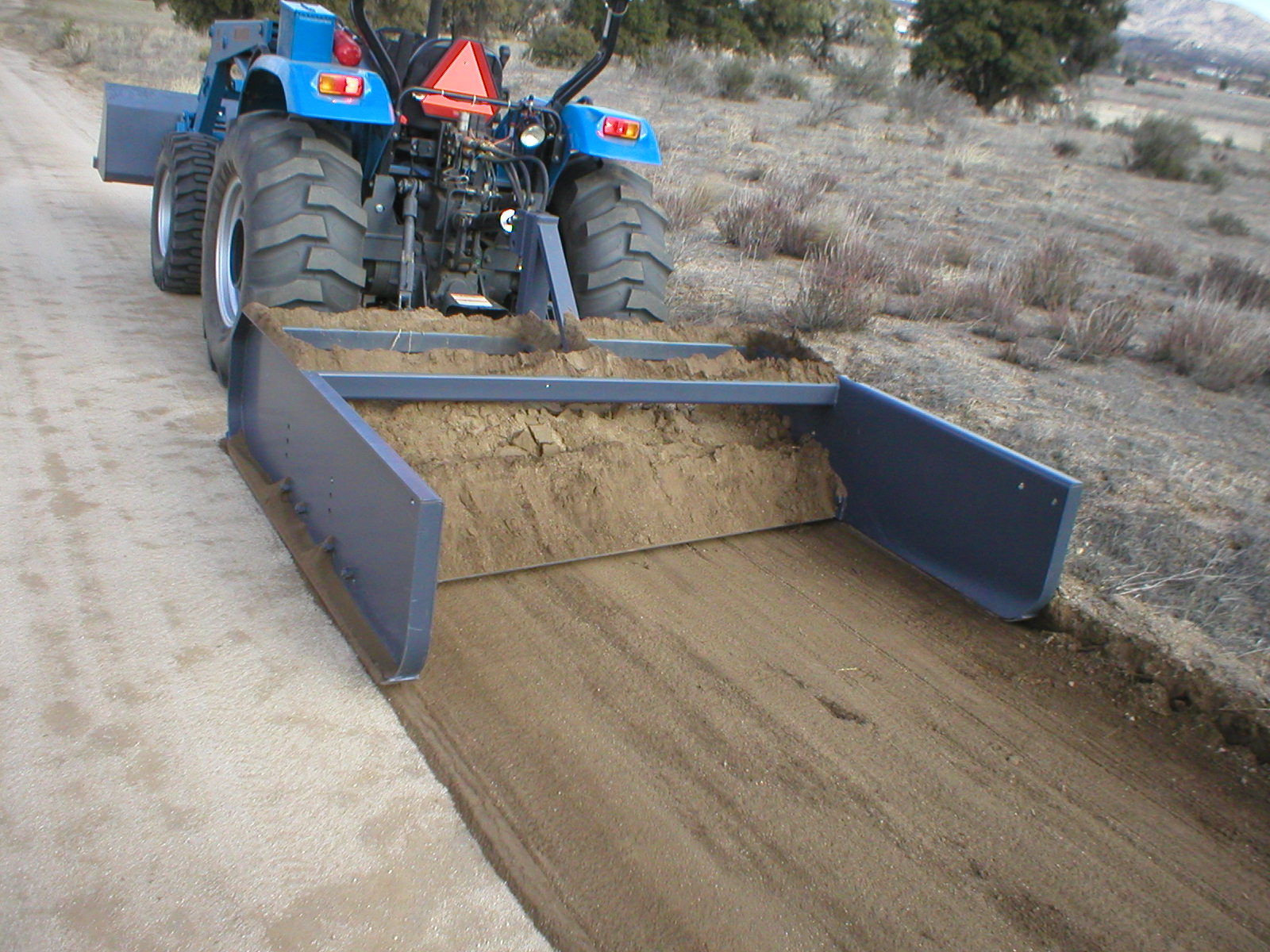

Here's what the blade looks like;
I was asking about vertical angle. I was thinking more along the lines of a shovel... if you try shoveling with it vertical it won't dig, but the more horizontal you get the better it cuts in.
