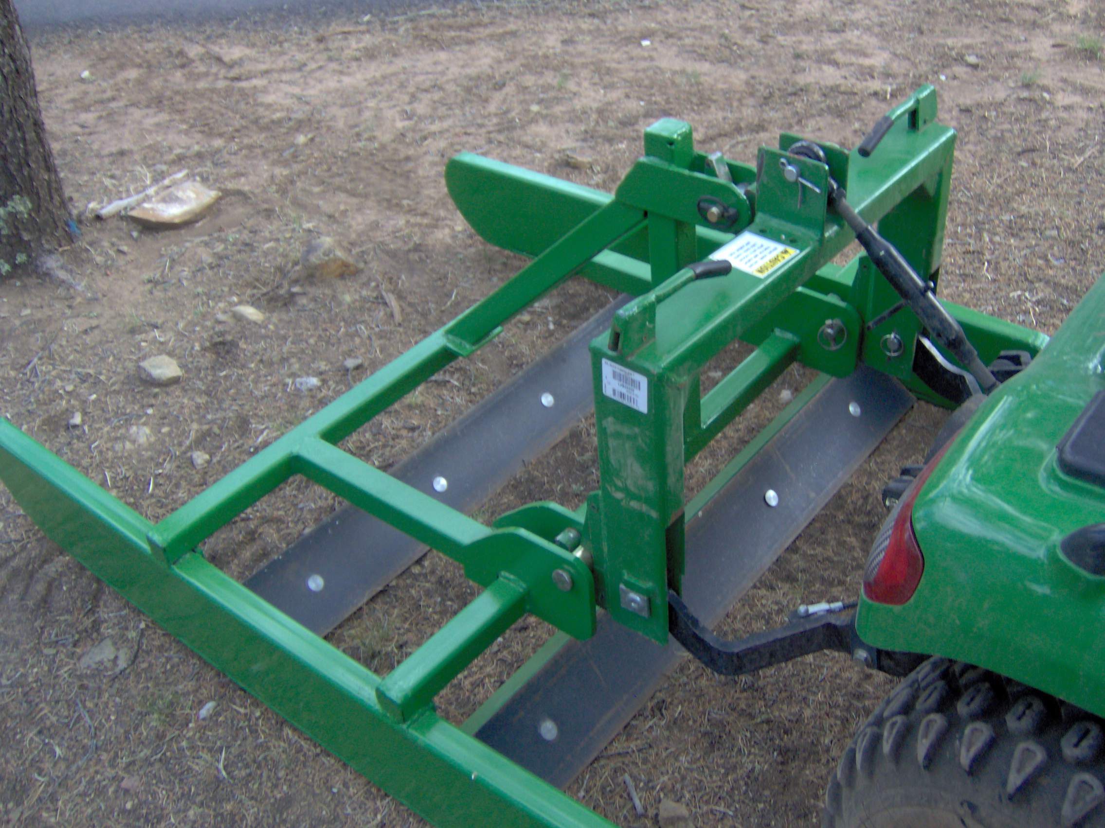

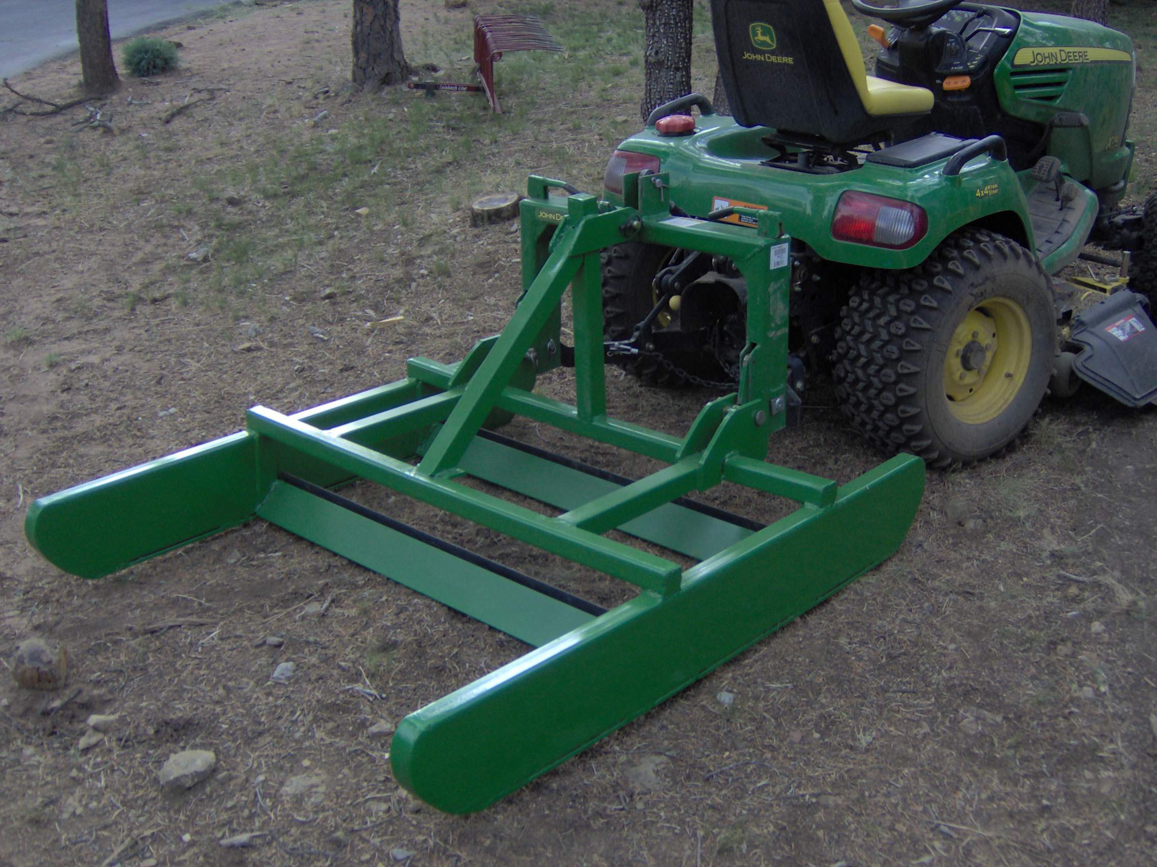

Here is a 4 ft landplane I built for my garden tractor, I suspect you could put chains on the top front of the skids with a tow ring and pull it with one of your vehicles. This is a good match for a scut sized tractor. Without the need for the 3ph it should be a quick and easy build.

4' long X 4' wide? Looks good to me. I'll have to acutally pay for one length of C channel. LOL Oh well.
This one is 4' wide with 5' long skids about 420 lbs.
