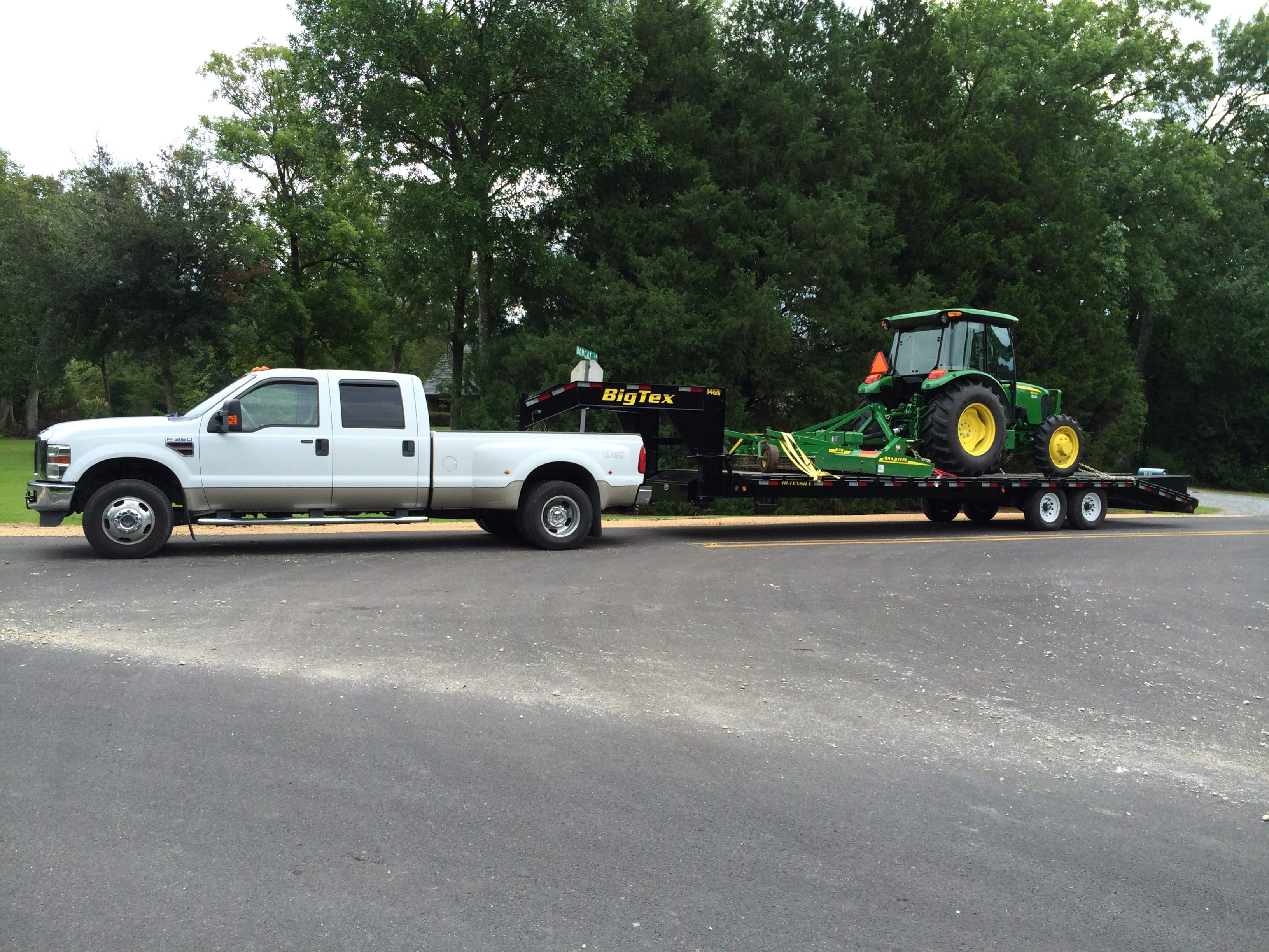

Well here is my setup.
I went with a Big Tex 14GN single tandems. I found this one second hand that's is a 2014 that was used three times and only paid $5000 for it. The trailer handles the load and pulls great.
