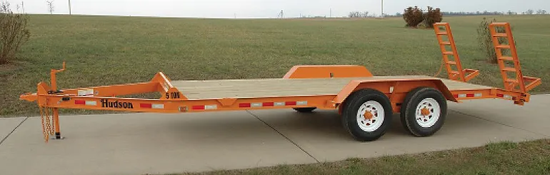

I have a Tye-Bro Metals equipment trailer with a label which says:
GVWR 12,000 lbs
GAWR 6,000 lbs
I understand that the above lists "Gross Vehicle Weight Rating" - Meaning how much it can handle, including its own weight. I also understand that "Gross Axle Weight Rating" refers to what each axle can handle (well, duh, 2 axles and a GVWR of 12,000 should equal 6,000/axle).
Does anyone have any ideas on how I can determine the weight of the trailer, absent taking it to some scales somewhere?
I'm researching purchasing a mini-X and the one I'm looking at has a weight of 9,158 lbs. I want to make sure this trailer will handle that much weight. Otherwise I'm going to have to go down in size or get another trailer.

12K trailer (steel frame) should be between 2650 and 2850 empty depending on length and floor material (wood vs metal). so you are probably at your limit or close to it with the mini-ex. add chains/binders/toolbox/etc. might toss you overweight. Best bet is run it through a scale ... if you have a truckstop near you, they should have scales

I've a "Hudson HSE Deluxe 5ton",GVWR 12,000lbs, it weighs 2K. According to their web site

My trailer sticker also lacks the curb weight number, but I found it pretty easily on the manufacturer's website. Later, I realized it's also in the manual they gave me when I bought the trailer. Definitely quicker and easier than hooking up and driving to a scale location.
Also, if using a scale, you might get away with just parking the trailer axles on the scale and dividing by 0.9, as most trailers are set up for about 10% tongue weight, when empty. If that yields a payload number with margin for your planned load, and you're not real interested in getting the exact number, then you can call it good enough. It's the axle rating that dictates the trailer weight rating, anyway.
