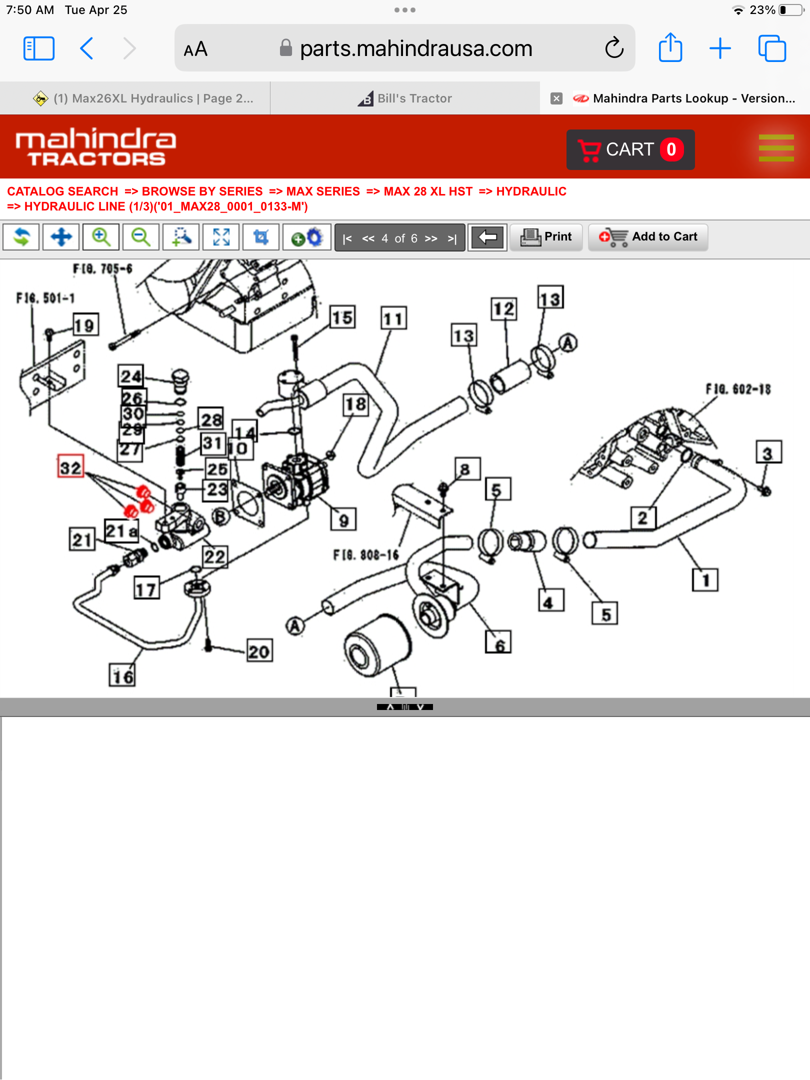

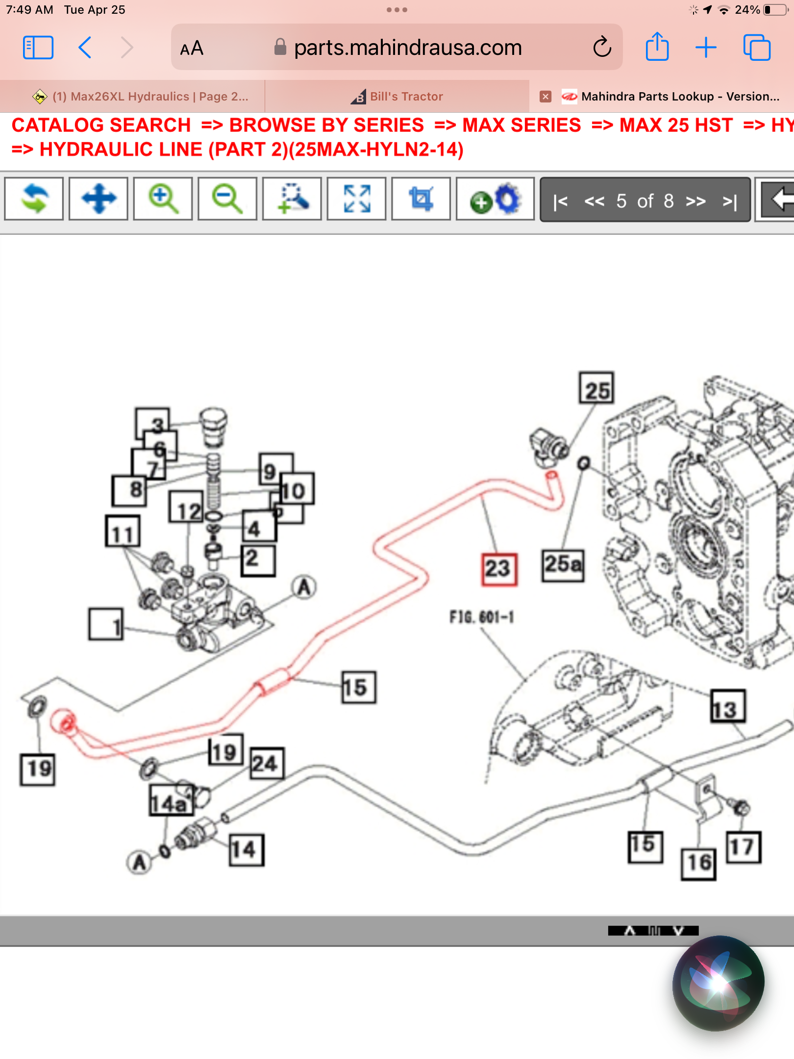

I had to replace the hydraulic pump and metal pressure line going to the block. After about 5 minutes of running, I get a squealing sound from the pump area. I had that sound before the metal fluid line ruptured at the fitting which is why I replaced the pump. Do I need to vent/bleed the line or is something else going on?
   / Max26XL Hydraulics
#2
I'm wondering since the two pumps are in series, gear driven off the engine, if my problem might be the steering pump or the gears themself? I should also mention the 3 point is not working.

"The block"? is that a diverter block with a spool on one side you can rotate with a screwdriver? If so, and you didn't rotate it when you removed all the loader plumbing, that's how you messed up the pump and line. You might be about to mess up another one.
Good question, I don't recall seeing a spool that can be turned. I'll take a picture tonight and post.
