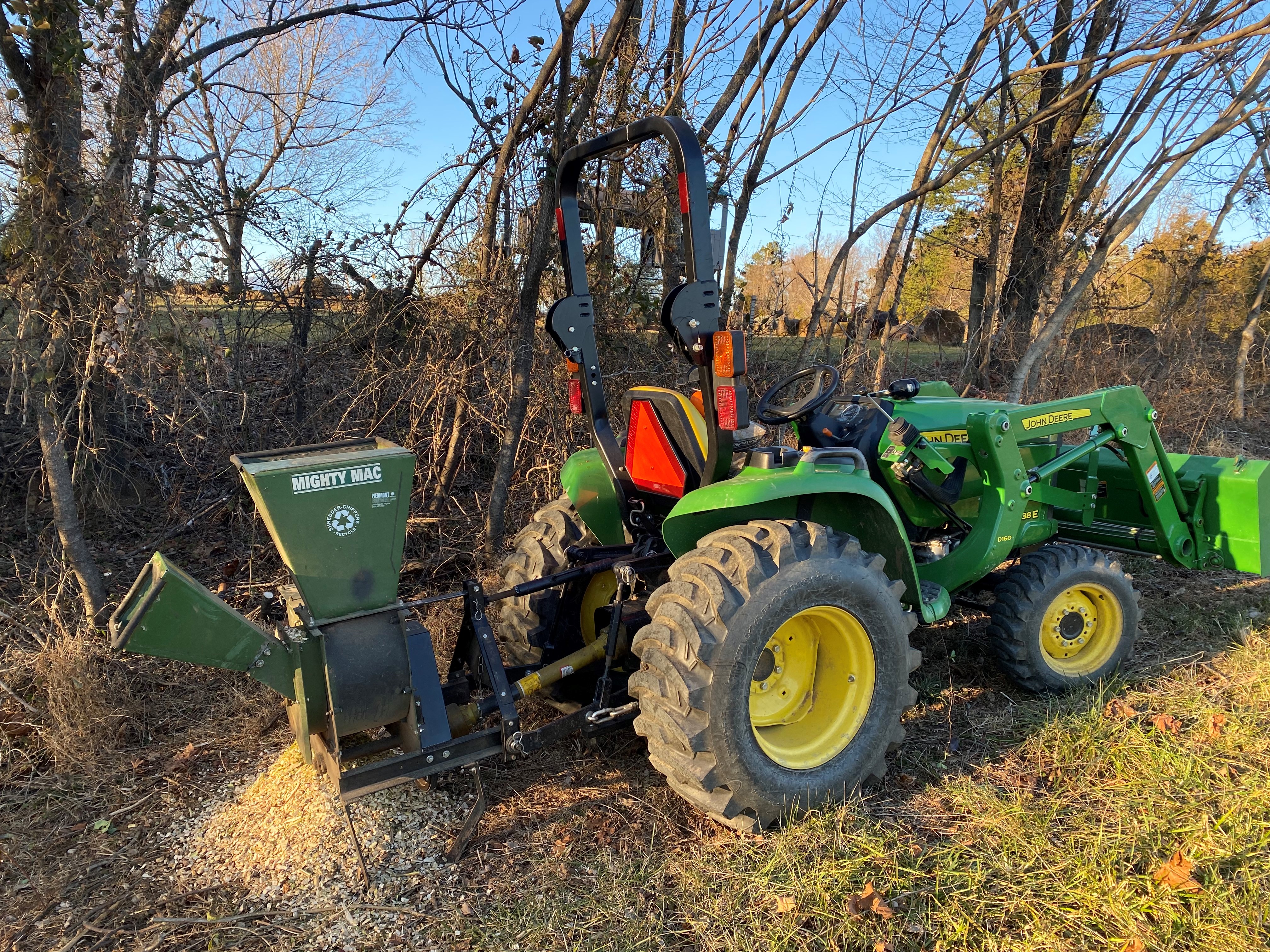

Here's the buyer's JD 3 series with our old Mac on it. Told him he needs to buy some pins to convert the Mac to Cat. 1 to continue to use his QH on it. It's Cat. 0.
Ralph
