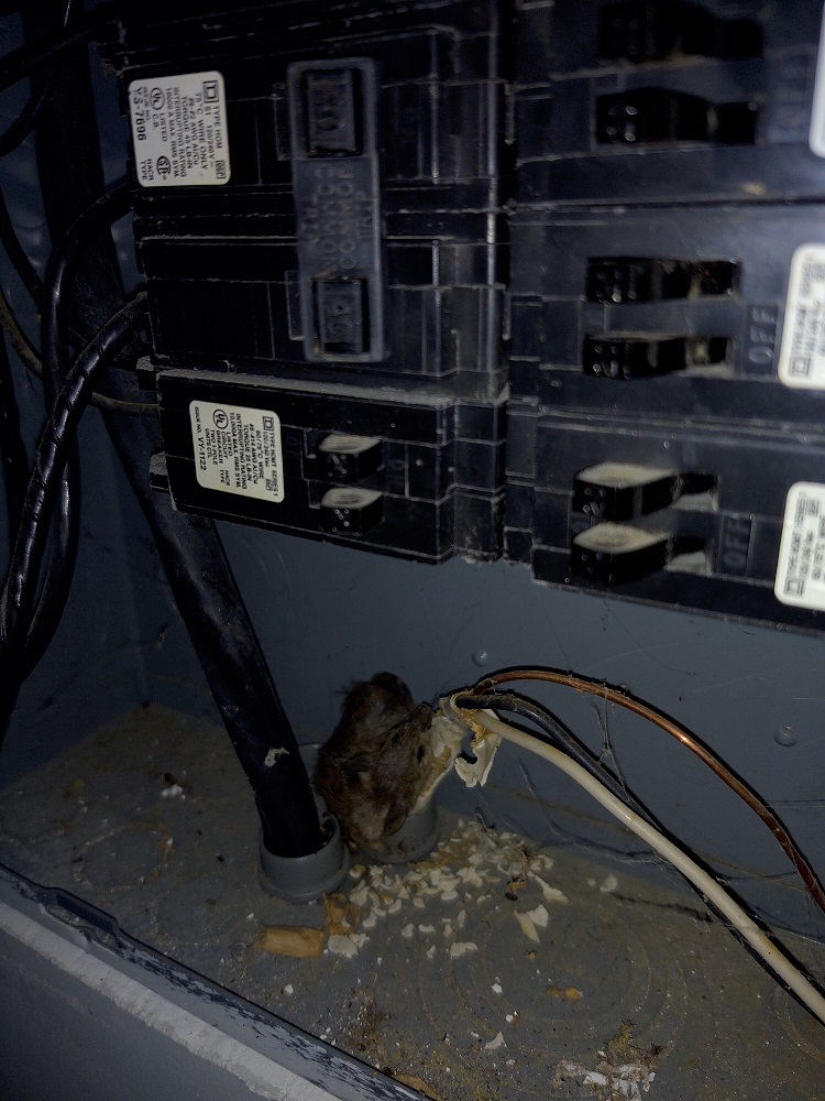

Well, I might be screwed. I'll cut to the chase.
After checking/probing a couple things, (and admit I had NOT thought about double checking power) I went to the beginning.
Long story short:
1. I've got power at the breaker (pulled out, checked for tight wires, continuity through the breaker and then after reinstalled, repowered and checked each leg and they both are 120 volts)
2. Go to the outlet again, now that I'm confirmed at the breaker and the outlet STILL only has power on one side. Hmmm...
3. Turned power off, pulled outlet out and checked for continuity and outlet checks fine.... turned power back on (wires exposed) and tested each wire in the box. ONE wire is 120 and the other wire is dead.
4. I've got to conclude that I must have a broken wire between the two. FORTUNATELY this is in the basement where I have drywall. (upper floors are solid logs so would be more difficult to find a break)
One thing I noticed while in the main panel (power off) was.....I had a critter. He/she (or would it be a "Hir/Zim"??? Gotta be pronoun proper nowdays!!)
When I saw this I figured it was fried....but that didn't seem to be the case. He was stuck. The wires next to him are still covered. Looks like he gnawed at the sheathing a bit before he transformed into his higher being.
It DID however, kick start my head to think (fear) that maybe he or another has gotten to the wire for the dryer that's in the wall/ceiling.
I DO know I do NOT like that prospect.
OMG, I just realized.... I have a big roll of 8-3 in the garage. I can scab that together to see if everything works if I totally bypass the current wires.
(not that I like 220 8-3 laying about.... but for diagnostic purposes I think it will give final conclusion to it being the wire or not)
   / Maytag (dryer) repair question.... works but no heat #18
Nice detective work.
Good luck with the wire tracing! Do you have a fox and hound type tracer? It might make finding the break easier.
I have critters around here, too. You have my nightmare scenario as the wires here are routed...who knows where. Replacing any of them would be a big undertaking, as very few circuits are accessible. ("Oh, the wires are in that wall? Kiss two rooms of wallpaper goodbye, along with the trim...") If more than a circuit or two goes, I'm resigned to pulling the entire outside of the house off, rewiring, reinsulating, adding insulation, and new sheathing. Yuck.
