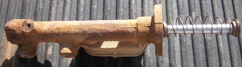

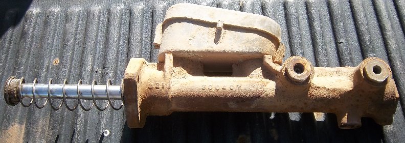

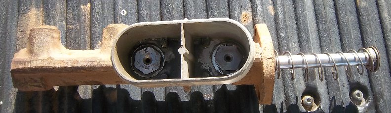

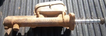

Men, women, boys & girls, I sure could use some suggestions on where & what to look for.
Have gone to well over 100 web sites or pages. Can't find anything even close to the right master cylinder.
Looked under Dodge D500 truck, M500 motor home (same chassis), even looked at the 300 series.
Checked out several auto parts & truck parts stores, looked under Midland brakes, Wagner brakes, Bendix brakes.
Vintage & antique Dodge parts
2 Problems, MC is an oddball, (Picture tomorrow) brake lines attach on passenger side of cylinder. Front brake line is 5/16" & rear 1/4".
Running out of ideas.
   / Me A Happy Camper - 1975 Dodge 500
#30
2 Days of internet searching. Actually found a replacement cylinder, a rebuilt direct from Halex / Midland. "Only" $313 + $120 Core charge (refundable).
Still a ridicules price for less than an hours labor & a few seals.
Think I will adapt a Bendix 12008 brand new cylinder $47.99
See pictures & please tell me what you think.
