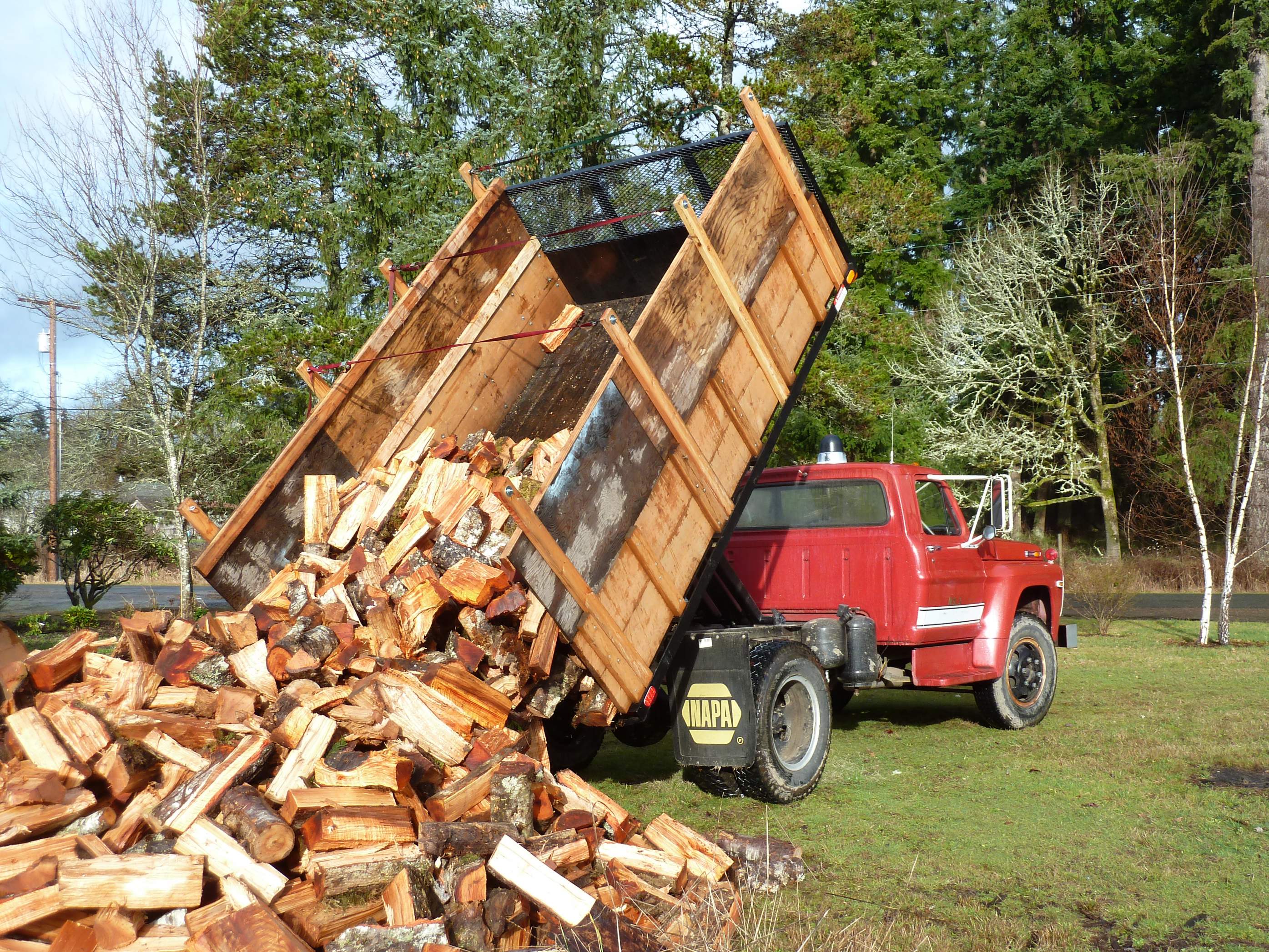

I picked up this one many years ago. It has 6542 miles original on it. It was a tanker and I pulled it off a few years ago and put this steel bed on. Has a 14t hoist with a pto unit. It is totally stock with a 361 and a 5sp. It had a rockwell rearend with 6.83 gears. I did change that out because it was just too slow. Has a two sp rear now and is comfortable at 55-60 turning about 2800rpm.
It is a ford 700 1972. Anyone interested it is for sale. Have to many toys and retired.
Nice looking truck & fire wood. Like them both. Were you closer I'd steal them. :D
Some day if I ever come across a transmission with a PTO, I'd like to make the old Dodge a Dump sell the old 1974 Chevy dump.

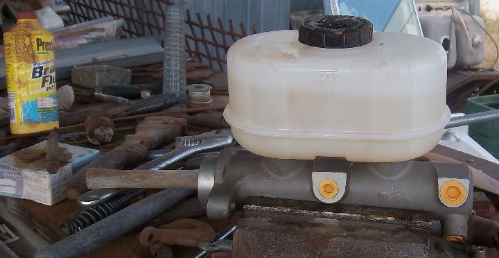

Some amazingly good luck.
Call U.S. Auto parts to check deliver status. Should be there on the 2nd. That be today.
Went out to paint numbers on sign. Here comes Fed X, even knew the driver, he has a box for me.
Behold brand new Master cylinder. Luck gets even better. Bolt spacing, size & boss diameter exactly the same. No adapter needed.
Very minor problem, need a pressure switch. Old Dodge has a mechanical switch on the brake pedal. May just run some wire & hook up 2 more brake lights.
Next minor problem. 5/16" & 1/4" Brake lines on opposite ends & at a slight angle. A little bending & they will work fine.

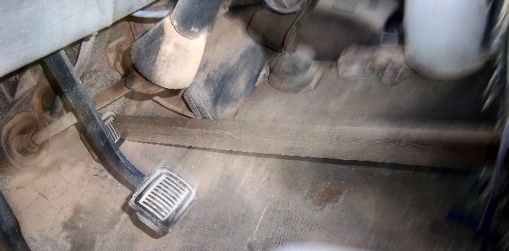

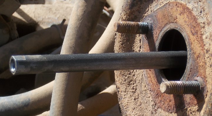

Real problem push rod is too large to go into master cylinder. Idea 1, grind out piston. Idea 2 Cut off push rod (Its hollow) and fit with an insert the right size & length. At this point like #2 better. 1/4" should fit into push rod, if threaded a nut can be used to adjust length if needed. Cylinder end of rod will need to be ground down slightly. Will also make a gasket to better seal vacuum chamber.
Any thoughts or ideas would be much appreciated.

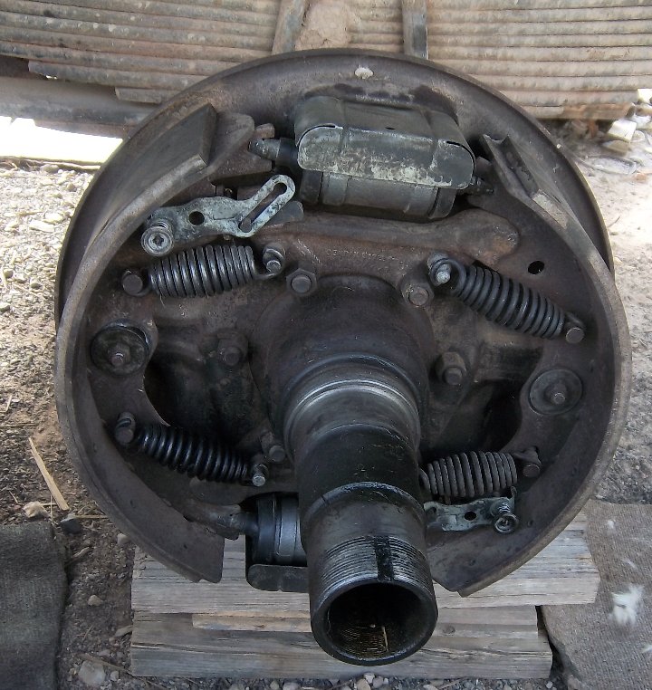

Brakes back together on rear wheel.
Wheel seal is at parts store in town. Different part # than seal removed, sure hope it fits.

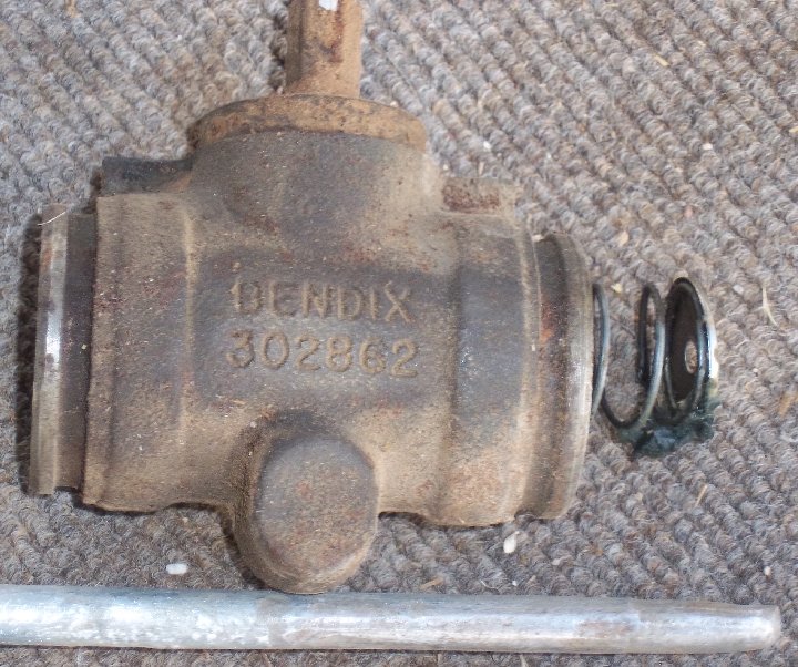

For all the good things about the new master cylinder, a big problem has come up. Push rod is actually solid, ends drilled & tapped. 2 Things planned, reinstall old MC & get brakes working. Then pull it off and see if it leaking out the rear & will also be able to feel if it is bypassing internally. Do some local driving & check all wheels for leaking fluid. In town, will try to find some 1/2" ID stainless tubing. It will be used to splice the MC push rod if needed.
Lots of rust to clean off vacuum chamber & will also install a gasket for a good seal.
When the right side brakes were done I made a spring installation tool out a giant nail. Could not find it, so ground down the actual brake tool and got it to work. It was too fat and got in the way of the spring. Well after everything was back together, up popped the tool I had made. The bad wheel cylinder was the Bendix cylinder shown.
bendix cylinder.jpgbrake MC.jpgbrake together.jpghelper stick.jpgspring tools.jpgvacume.jpg
Some progress pictures.
