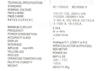

. . . The only thing I'm wondering about is whether it would be accurate down to nearly zero amps. My HVAC mini split runs the indoor unit fan constantly, even when the compressor is off, drawing about 0.3 amps according to my amp probe and would like to capture this in the KW tally also.
The picture shows 20(100)A and wondering if the 20 is the minimum amps at which it will record accurately?
No way to tell. Neither the Amazon info nor the Baomain.com website provide sufficient information. The Daomain site has a FAQ page but it is empty.
Since you already have the indoor unit’s running amperage and Voltage and it runs continuously, you already have all you need to determine its energy individual consumption.

Looks like its good for down to 40 milliamps:
Baomain Single Phase DIN-rail Type Kilowatt Hour kwh Meter 22V 6Hz 2 (1) A - Voltage Testers - Amazon.com
Edit: The "running continuously" occurs only when the unit reaches the preset temperature and the compressor shuts down. The fan continues to run but draws less than 0.5 amps. The compressor draws as much as 4 to 5 amps when its running.
What I'm wanting to determine is the cost of running this unit for a period of time such as an hour, day or month. An amp meter alone will only tell me what the current draw is at any given time and not the kilowatts consumed over a period of time.
