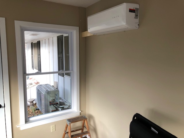

Ours is a Lennox MLA one ton with MWMA inside wall mount unit. It is 240V and inverter technology which I assume to be AC motors. There is a parameter controlling whether the inside fan motor that circulates when the compressor is not running and have considered setting that to "off". The idea, from my understanding, is to give a more uniform air temperature to the sensor which is internal to the air handler.
The irony of that is I've been having an issue with the internal sensor picking up hot air recirculating right back up into the unit and shutting off the compressor (short cycling). That is what instigated checking amperage with a recording amp clamp to see how often the cycling was occurring.
The short cycling can be prevented by using the hand held remote as the temp sensor and placing it at distance where its not susceptible to false readings. Its like a TV infrared remote so has to be aimed and then left in that position to communicate with the air handler which talks to the outside (compressor) unit.
The MLA model number identifies it as "Low Ambient" and is supposed to extract heat from the atmosphere as low as -20F degrees.

We have three Mitsubishi Hyper Heat Mini Splits 2 - 9K and one 12K (1 Ton) installed powered by the separate garage service and meter with installed 7.2KW Solar and the 9K units are 30 SEER and the 12K is 26 Seer they are very efficient units.
We have the solar edge optimizers/inverter which provides output by day/month and I use this to compare against the electric bill. It's pretty easy to determine month to month KW usage of the Mini Splits as i know the historical base line energy KW for the garage is 130KW/month without the mini splits - the balance goes to the mini split heat/ac in summer/winter.
As far as Npalen and your Lennox MLA unit - it appears your indoor head is mounted close to a window/door in the corner of the room which could lead to uneven distribution causing the cycling. Generally speaking you want it on a wall close to the middle of the room for even air distribution. Does the Lennox MLA have a air directional flow capability to send more air to the right/left?
The Mitsu units you can set up the directional air flow to left/right etc. in case of a comer mount location, so if they have this capability try this to minimize short cycling.

Yes, the Lennox has directional flow which is now set to direct airflow to the center of the room. It also has the louver on the front of the unit which can be auto cycled to oscillate full down to straight out or manually set with the remote to any position.
I'm a bit concerned that the one ton unit might be a bit oversized for summer cooling. The room is only 168 square feet but it does have double pane glass all the way around the 10'x14'. The glass is certainly nice with the south sun this time of year and/but the southern exposure won't see any sun during the hot months.
The inverter technology might alleviate the oversize concerns hopefully. My contractor recommended a 1.5 ton unit but that would seem to be way overkill for the small room.
   / Measuring Power Consumption Of 230VAC circuit? #48
Wow - that's a big unit for that small of a space - our 9K units heat/ac 700 SF on average, and the 12K unit is on 1000 SF area.
That might be the reason for cycling.
