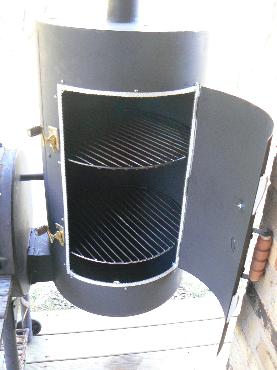

Most hot water tanks are about .090 thick a little under 1/8" (.125). I have made 5 stoves and the smoker pictured out of them and 90+% of the welding was done with 1/8" rod.
Your smoker will most likely last almost forever. Smoker is over 4 years old and my little inside stove is on its third year. Lots of time on both of them.
I use a propane burner, mostly to get things going and as a backup if I forget to add charcoal on time. Have had good luck with ham, turkey, ribs & roasts.:licking:

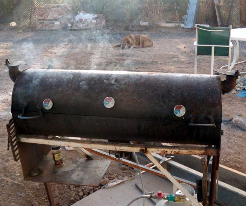

I made one about 19-20 yrs ago out of 1/4" wall X 20" pipe. If my memory serves me right the smoke chamber is 36" long and the fire box is 18" long. Mine is horizontal and I used one piece of pipe and cut the fire box from it and dropped it where the top is a little below center of fire chamber. Mine is similar to "TheKids" smoker but without the vertical chamber. I can see where a vertical chamber or smoker would be handy as well. I fabricated a sliding shelf that the meat sits on in the chamber and I can pull it out to mess with it and then slide it back in and shut the door. Put dampers at each end as well on smoke stack. In the firebox I put in a expanded metal false bottom for the wood to sit on and the damper below it, at the end of the firebox, also serves as a clean out hole for ash. Above the fire area in the firebox I made a shelf out of expanded metal for my water tray to sit on. I'll have to round up some pics of it, seems I don't have any here on this computer. Probably the only thing I'd do differently would be to use a larger diameter piece of pipe to make it from. This would give me a little more head room in the chamber.
Looking forward to seeing pics of yours and hearing how it's working for you. :thumbsup:

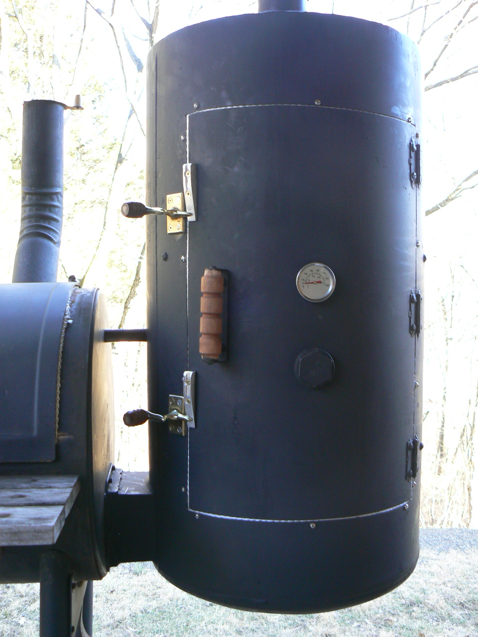

pics taken with my cell phone of the almost completed smoker
/ meat smoker
#32
sorry i forgot to say its a reverse flow.The heat and smoke goes into the smoker under the steel place at the bottom to the other end , then goes back across the grills then out the smoke stack by the fire box
