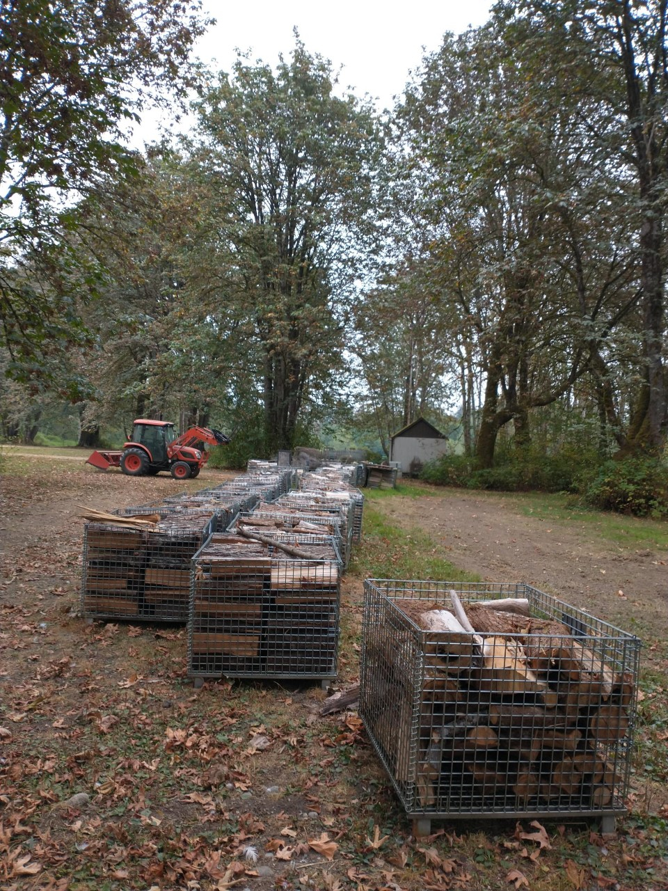

Three years heating (only heat the house- I don't do a lot in my garage during the heating season; anything that I do is quick work [I'm not retired, so not a lot of time anyway]):
I only put the current season's wood under cover (next year's gets covered out in the field [above picture- had not gotten cover on it yet]). Roughly 15 crates. Stacking takes nerves of steel: I'm getting better; smoothing out the access helped!
About 1/3 cord per crate. Lasts anywhere between 8 to 12 days on average, with the first and last crates on the edges of the heating season going for several weeks (not all that cold). Grab a crate (with the Kioti) and drop it on our deck where we pull directly from (a few steps outside). Most of the wood comes from blow-down or stuff that I've selectively cleared (a tree here and there- most all within our homestead area- out on the greater property I rarely cut anything that's standing): I'm always out on the property with the dog in which case I know where ANY available firewood is. Go out and cut wood and then place crates out such that I then come along with the splitter and the split wood goes right into the crates (shuttled back via the Kioti) and I don't touch it again until I'm pulling it from a crate on the deck to go into the house.
Plans were a long time in the making: LOTS of thought.
