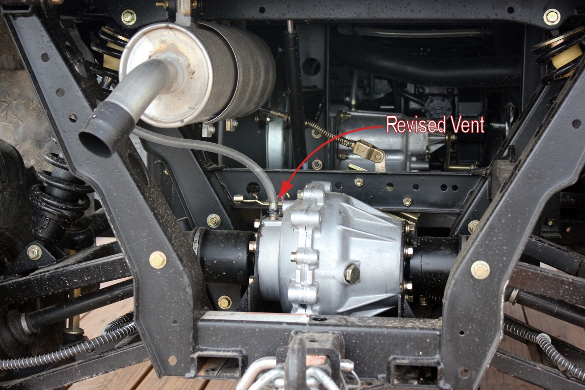

Great! Can I ask you to post a picture of the new style that I can forward to the dealer?

I just checked my machine and I have the same issue. Do you know if the new covers will be replaced under warranty?
Thanks!
   / Mechron Differential Vent #13
Mine were replaced under warranty, and I believe that there was a Service Bulletin issued by the Daedong on the issue. I will try and get pictures of it next time on the property.

   / Mechron Differential Vent #16
My right axle boot is showing "oil shine" too. Is yours leaking???? I'm asking the dealer to send someone to look at mine. No drip, just suspicion a weep, seep or such.

#17
It looks wet but doesn't seem to be leaking. Right after I got it, there was some lube dripping from the boot. The dealer sent a new vent (tube and fitting at outboard end) but that changed nothing. Since then the drip has ceased but it still looks wet all the time. Does your vent look the same as in the photo I posted? If not, please post a picture of yours..

#18
The Mechron is fixed :)
Kioti did replace both the front and rear differential covers under warranty just as somguyss predicted. The vent locations are relocated away from the ring gear as shown in the attached photo. Compare that photo against the photos I previously uploaded to see the change. I did notice that a new Mechron sitting on the dealer's lot had the revised vent design.
