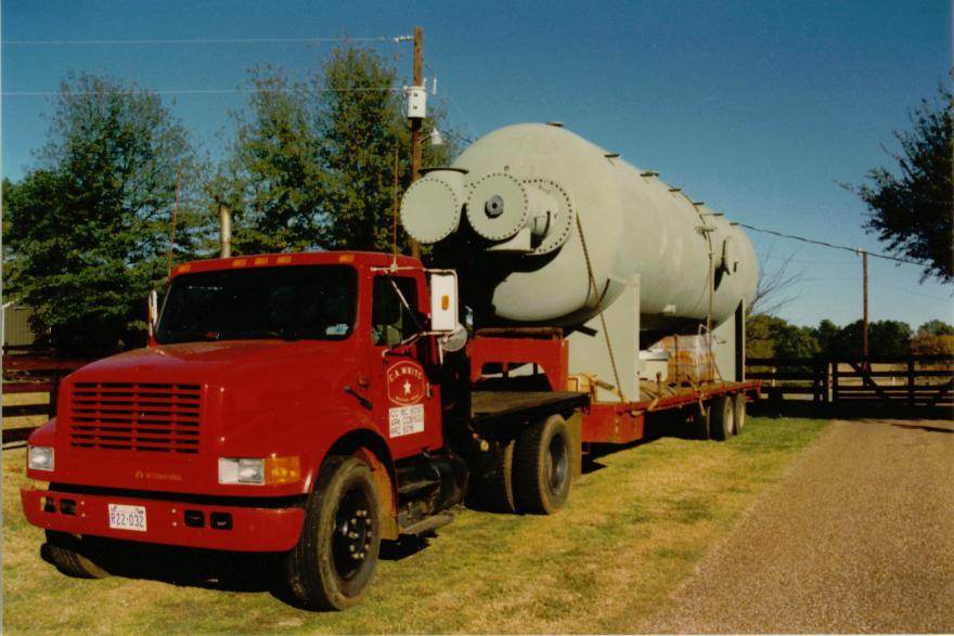

That DT466 is a real good engine and that model year probably still has a mechanical injection pump. We bought a new '90 4900 with a DTA 466 245 hp and seven speed Spicer trans. We used it for oil field hot shot work for about five years and never had any engine problems. Wish I still had it for farm truck use.
