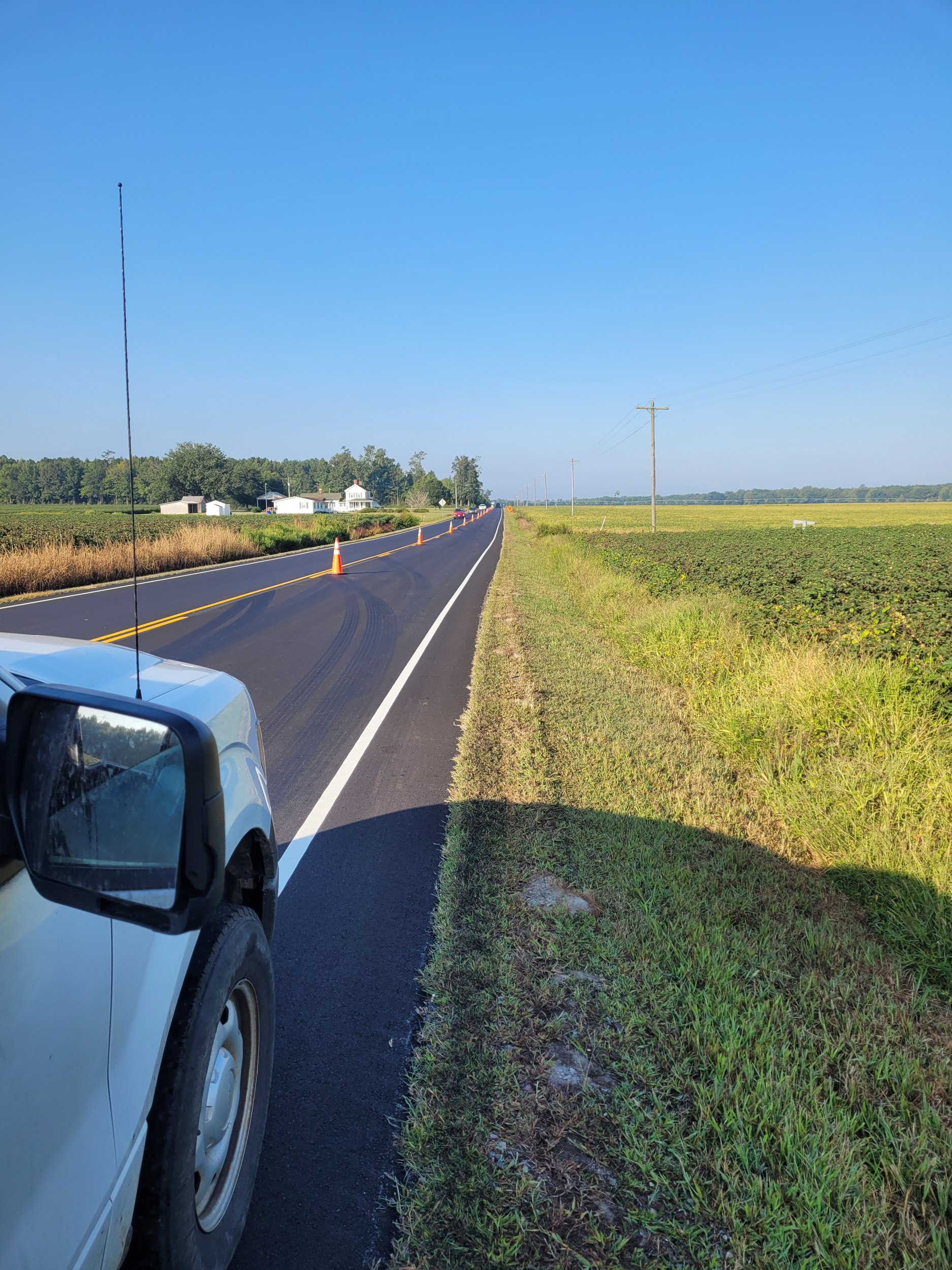

Heres another video.
The machine had been a great purchase. I timed it yesterday, put in 915ft of 2" conduit 30" deep in 27minutes. Ended up getting a little over 2500ft in would have done more but my helper is sick so I was running solo and can only work on this highway 10am-3pm because it gets so much traffic. The picture is what it looks like after I drive over it twice with BB after plowing. Sure beats trenching.

Doesn't even look like you've been there.
Great machine and glad it is working out so well for you..
Thanks. It's been crazy dry this summer and the dirt so powdery so some if the areas I trenched earlier in the year I've been back to do restoration on 3-4 times(super dry then a short hard downpore and the trenches sink in) Looking forward to not worrying about that anymore.
