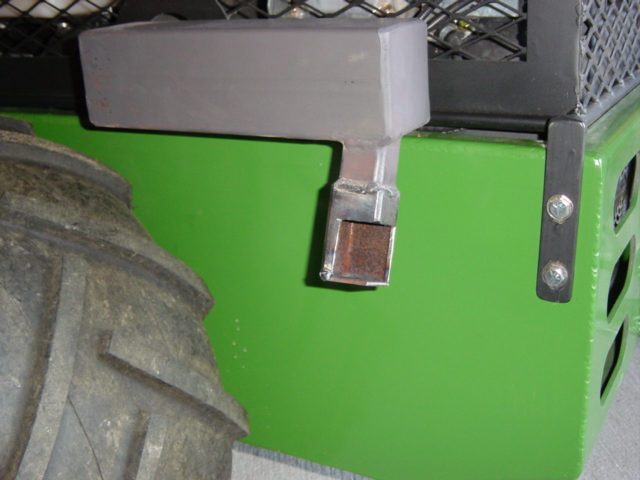

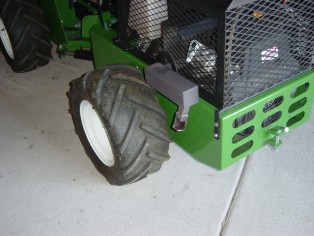

Hey folks!
A couple of mods I came up with.
First mod: I noticed the grass would get burned wherever the PT was sitting and running--bucket work, fork work, etc.
The exhaust was so forceful and hot it would scortch grass and kick up dust in areas where there was none. Didn't want to attenuate the exhaust...hence a diffuser/redirecter (is that a real word?). Seems to work well without adding backpressure. Also seems to direct sound to the rear.
*Second mod in next post.

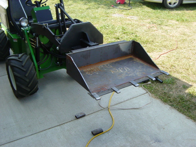

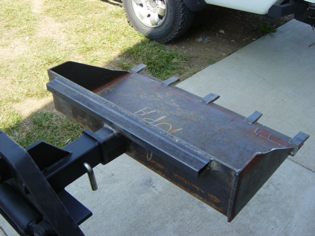

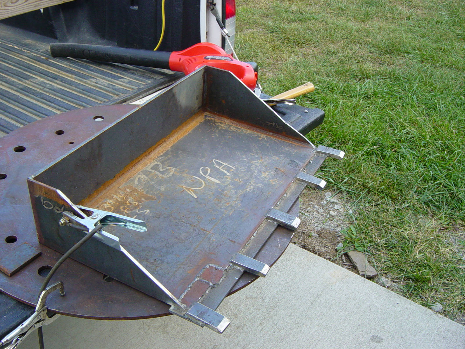

Second mod:
A small excavation bucket. It's 30in wide. With five 1/2"w by 3"L teeth.
The bucket floor and rear are 3/8". The sides and tooth bar mount are 1/4".
The back is braced by 1" x 2" tubing and 3/8" flat stock.
I found the basic bucket at the scrap yard...added the tooth bar and mount....voila = poor mans SMB. Or a "mini' SMB. Because of the 2" hitch mount I'm not sure a wider bucket would be wise...with all the lateral forces.
Anyway a few pics. This is why I love PT...easy mods...whatever you dream up it can be done!

Very clever, and great job. Its amazing how those hitch mounts can add so much more versatility to the ol PT. :) :eek:

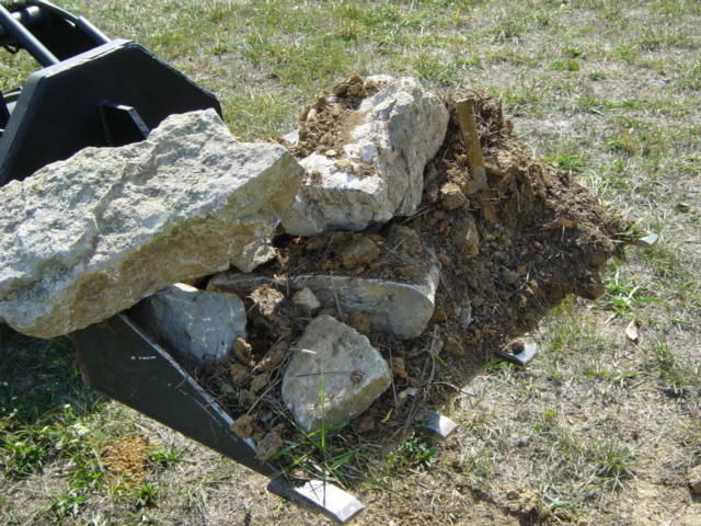

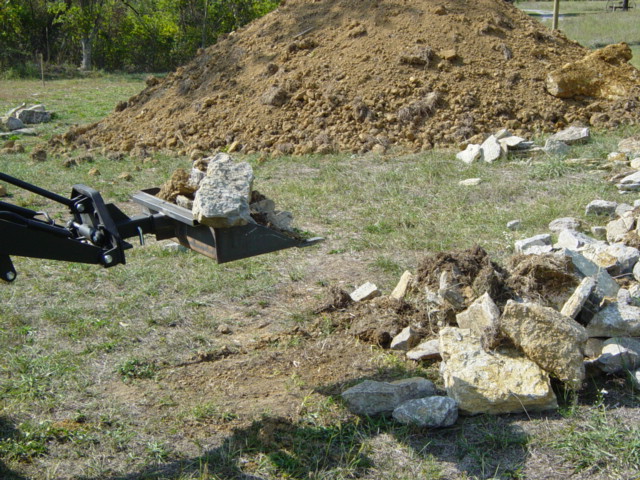

   / Members home made attachments / improvements #188
The mini SMB works well. Really digs into dry clay without much effort if I don't dig deeper than 6" at a time. I can take full scoops of losse soil and rock without problems.
.....And because it works so well:
Next weekend I plan to add 3" tall x 1/4" flat stock along the back and down the side to give it more capacity.
Will try to post new pics if I get it done.
