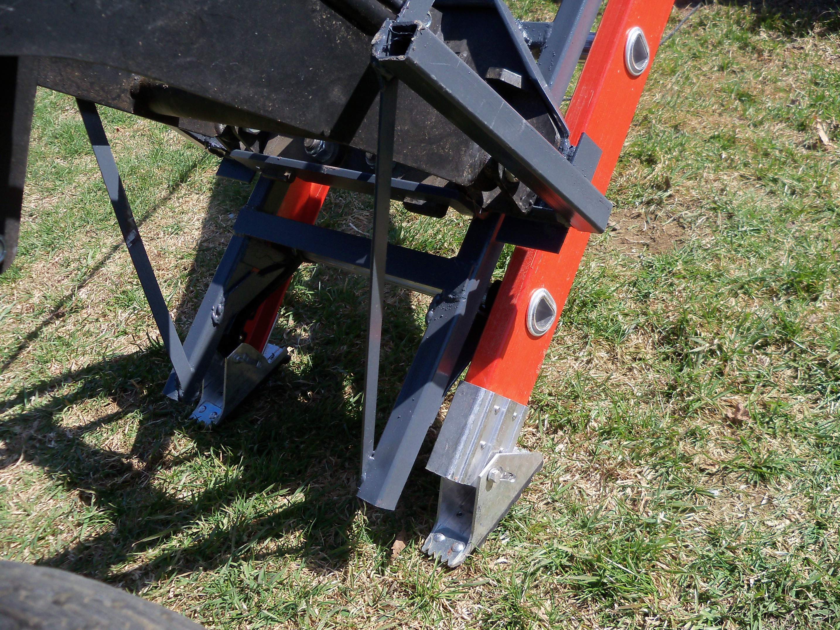

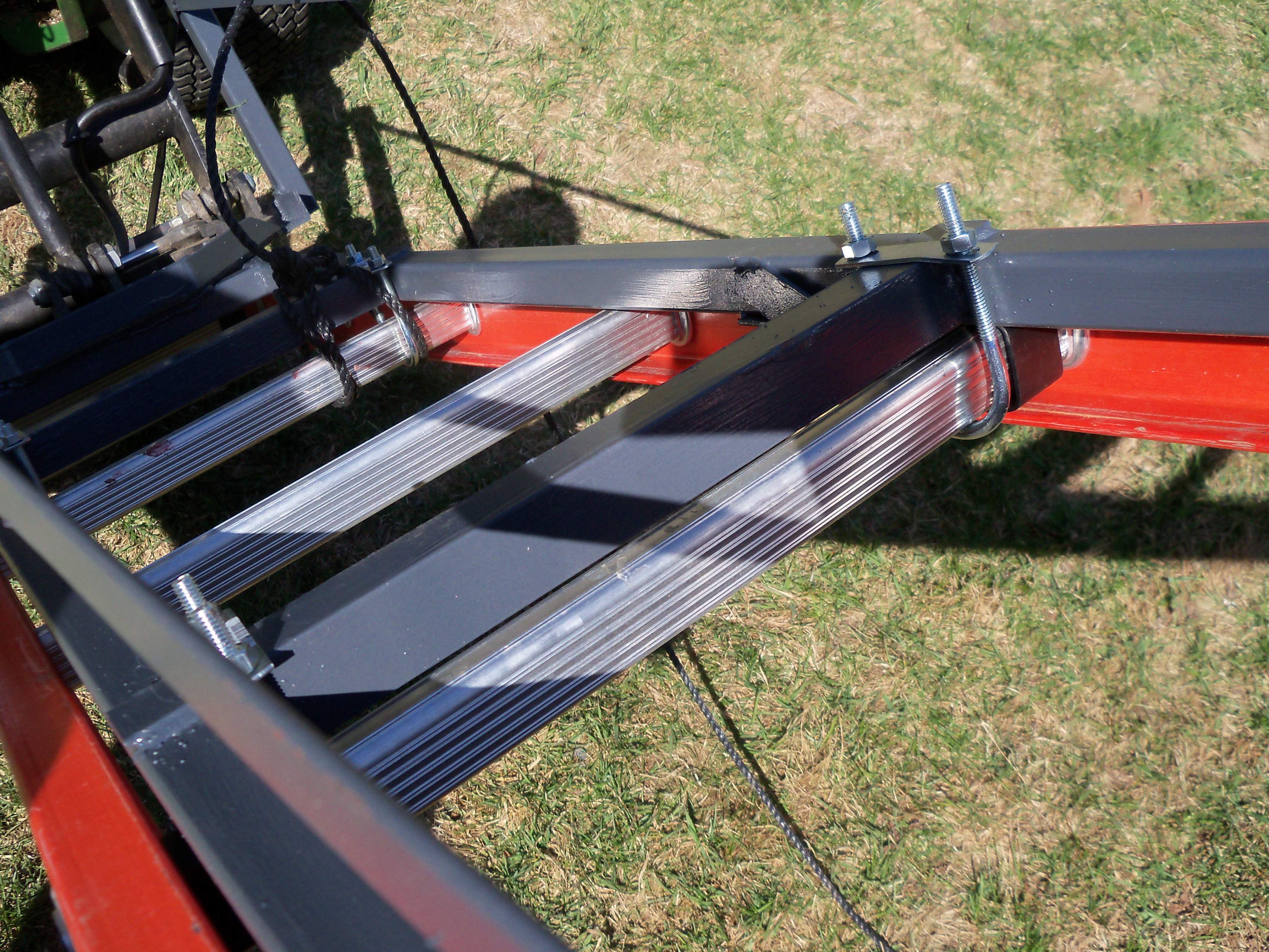

Nice job. How about a few more close ups of the details. I am sure others will want to copy it.
   / Members home made attachments / improvements #253
OK, two more pictures.
Basically the design is two square tubes welded onto an attachment plate. Cross members provide a rigid frame and are lined up with rungs to attach with u-bolts. There are also size dogs made out of bent angle iron to provide support under the ladder rungs when it transitions from the hanging state (carried by u-bolts) to the upright state.
The guy who did the welding suggested the stuts and the flat bars going forward/backward to increase the rigidity and take tension off of the leading weld on the attachment plate. I can say this was a great idea given how much flex those long ladders have anyway! Lots of bounce when driving it around...
I can leave the carrier attached when the ladder is in use, and can detach the whole thing without undoing the u-bolts. The only trick is that the ladder has to be at least about 30 degrees up at one end to detach/attach, as the PT loader cannot curl its attachment plate forward past horizontal/down.
