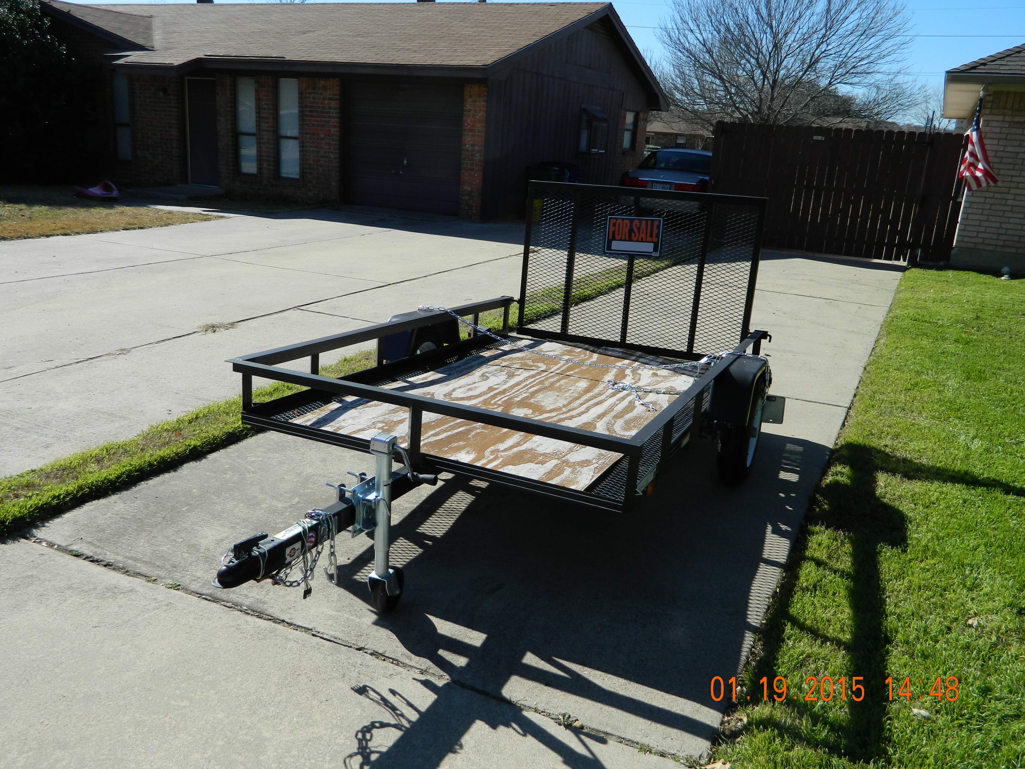

Everyone i know that has a mesh floor, promply covered it in 3/4 plywood. which leads me to wonder... why not just a wood floor to start. (cause most of the trailers in the TSC parking lot are mesh floor)
Instead of 3/4" plywood, I used 1/4"; lighter and cheaper. The mesh won't rot like wood if the trailer is left out on the weather all the time, and the plywood would be much easier, and cheaper to replace than the usual trailer floor boards. I applied a coat of sealer to both sides of the plywood before putting it on the trailer and put a few bolts through it with big washers on the bottom side to hold the plywood in place.

Mesh bends easily and is also limits hauling stuff like rocks, soil, dirt, ect.
My vote is wood.
Chris
My experience also. The mesh bent after a time of just hauling lawnmowers and a motorcycle once or twice. This was in a 5x8 Tractor Supply special.

I like the idea of 1/4 inch plywood over the mesh. Low weight with the advantages of wood. I considered 3/4 inch ply, but the 1/4 may be a better way to go.

Might as well go with 1/2" as they make an exterior grade of 1/2" but not 1/4". I've left 1/4" ply outside and it will disintegrate in less than a year garenteed.
