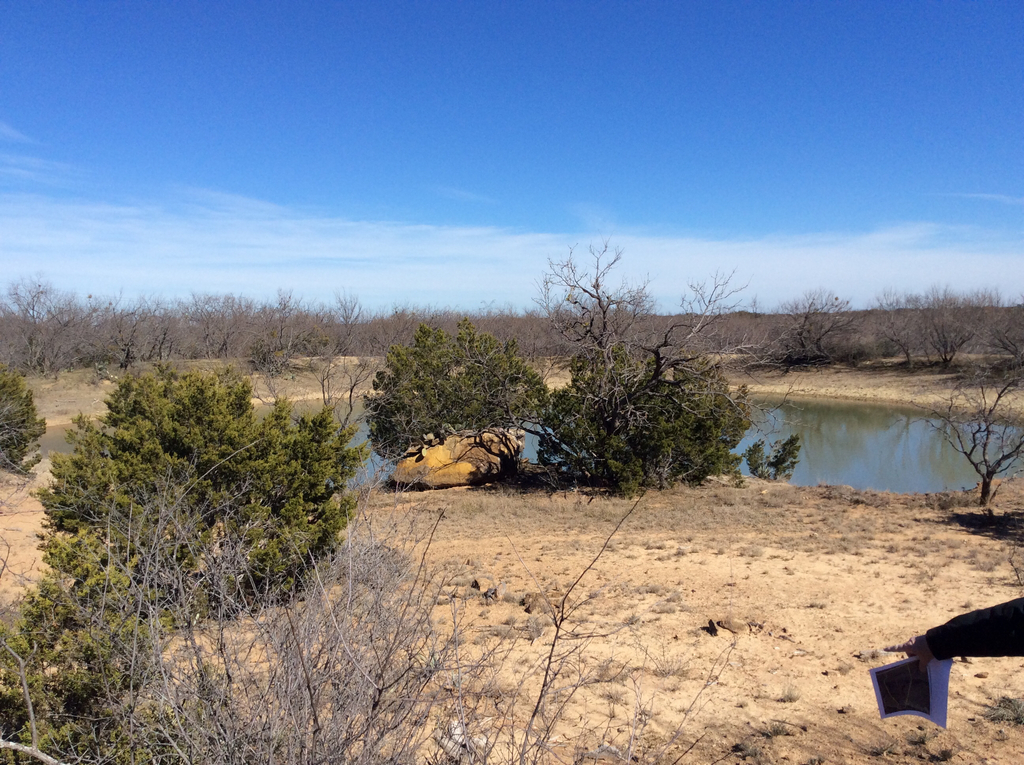

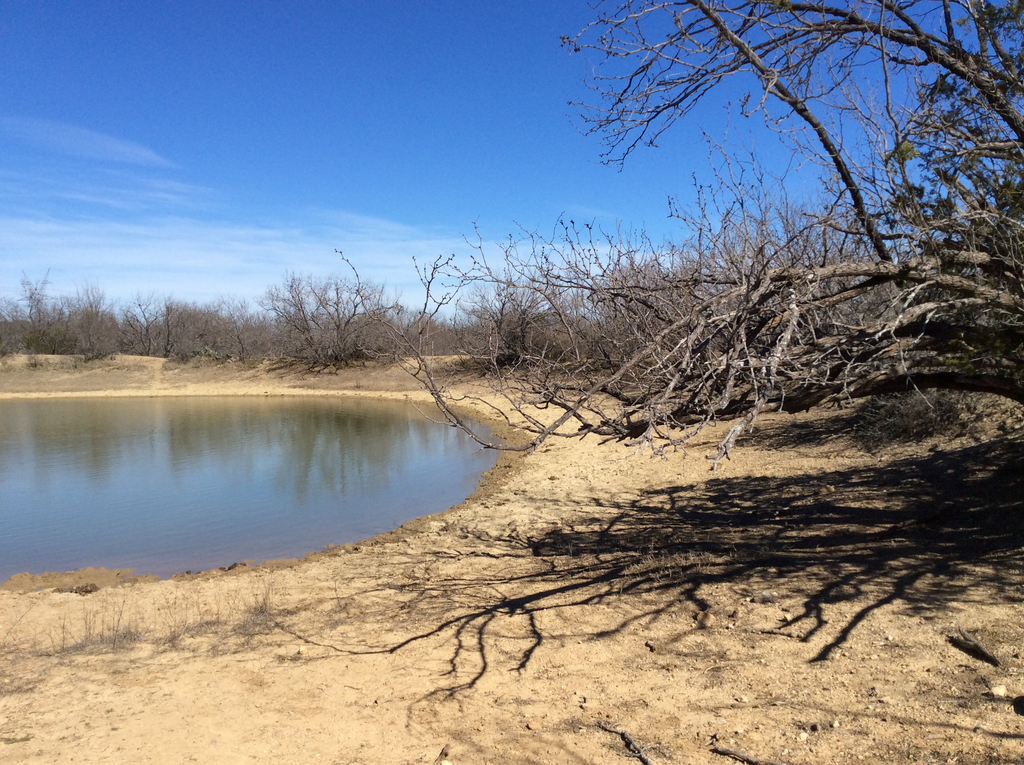

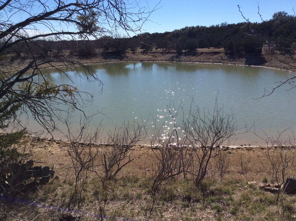

Here are a couple of photos I took earlier this year of the growth on the dam. dam.jpgdam3.jpgdam.jpgdam3.jpgdam2.jpg

Ok, now that I see the photos, I'm less concerned. This dam has less rise than I was envisioning.
   / Mesquite Growing on Dam - other places #15
Hard to tell from the pics, but it looks like most of the problem is above the normal high water level. I'd see about getting a dozer guy to look it over and see what he could do with it. Probably could just push out the offenders, and then re-contour the dam to make it look nice, then get some grass growing on it as soon as possible. Might even be able to pull most of them out and cause less soil disturbance.
