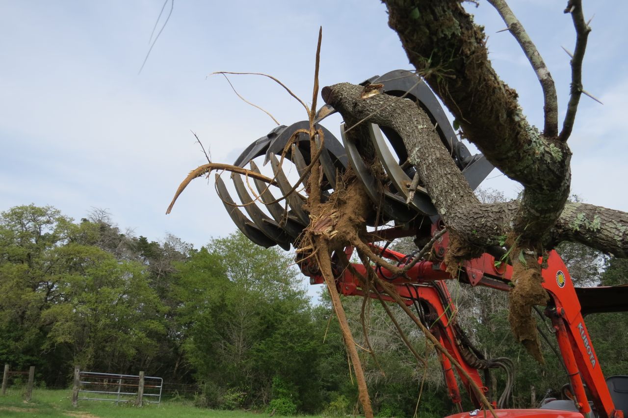

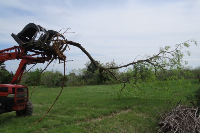

I had some mesquite very near the water line and used the Remedy/diesel mixture. Each time about half would come back I'm on my 4th spraying now (in two years) hopefully in the spring I'll have less than a dozen left to spray. My neighbor had some large mesquite trees that he sprayed on the stump once 3 years ago and now it looks like 90% have come back.
If the ground is wet and has some amount of sand a deep tooth grapple could also work.
