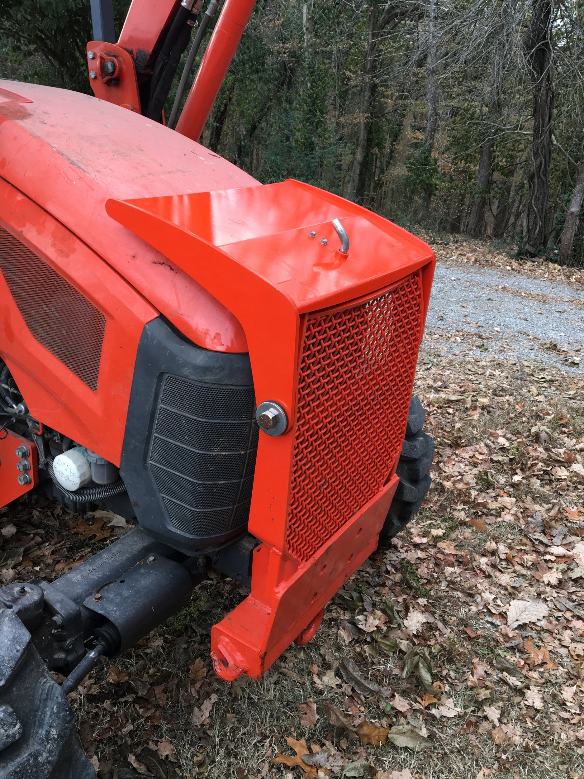

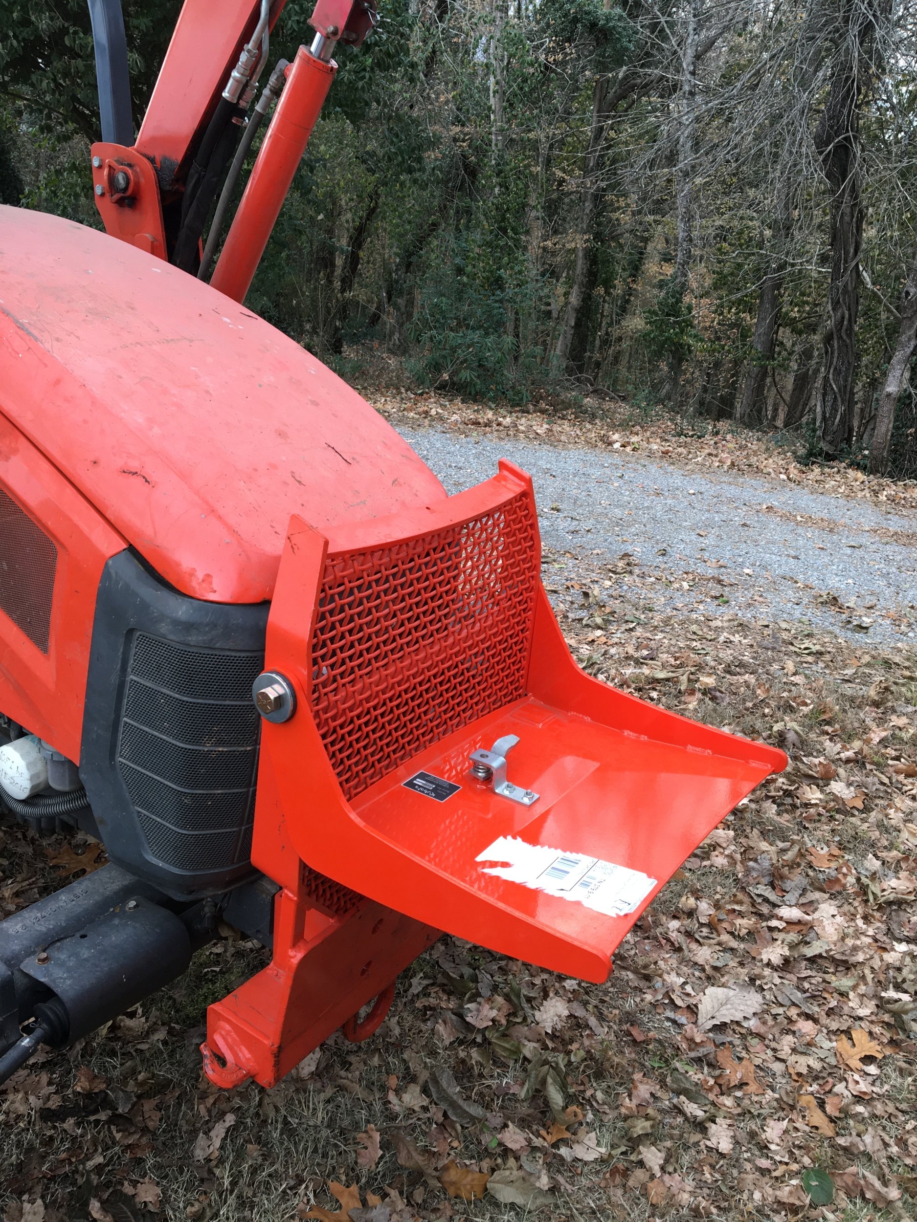

The bonnet protector was optional equipment for the M59. Listed on WholeGoods pricing list. Not available from local dealer but Messicks had one. Like the added protection and shelf for maintenance like oil change.
2019 pricing list. Order from sales, not parts department. Good to see all the options and pricing available. Don’t see it available for the M62.
View attachment 855434View attachment 855435

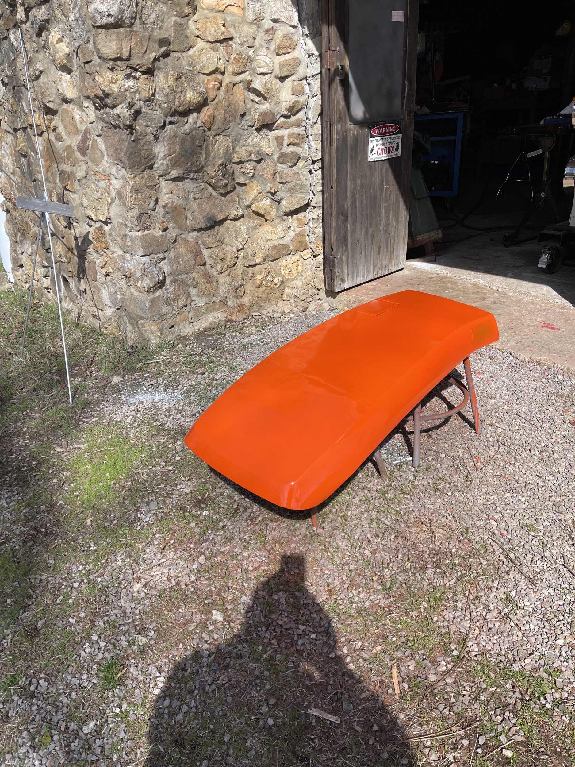

First coat of paint after hammering the dents out. Left hint of tattoo to help remember the event.

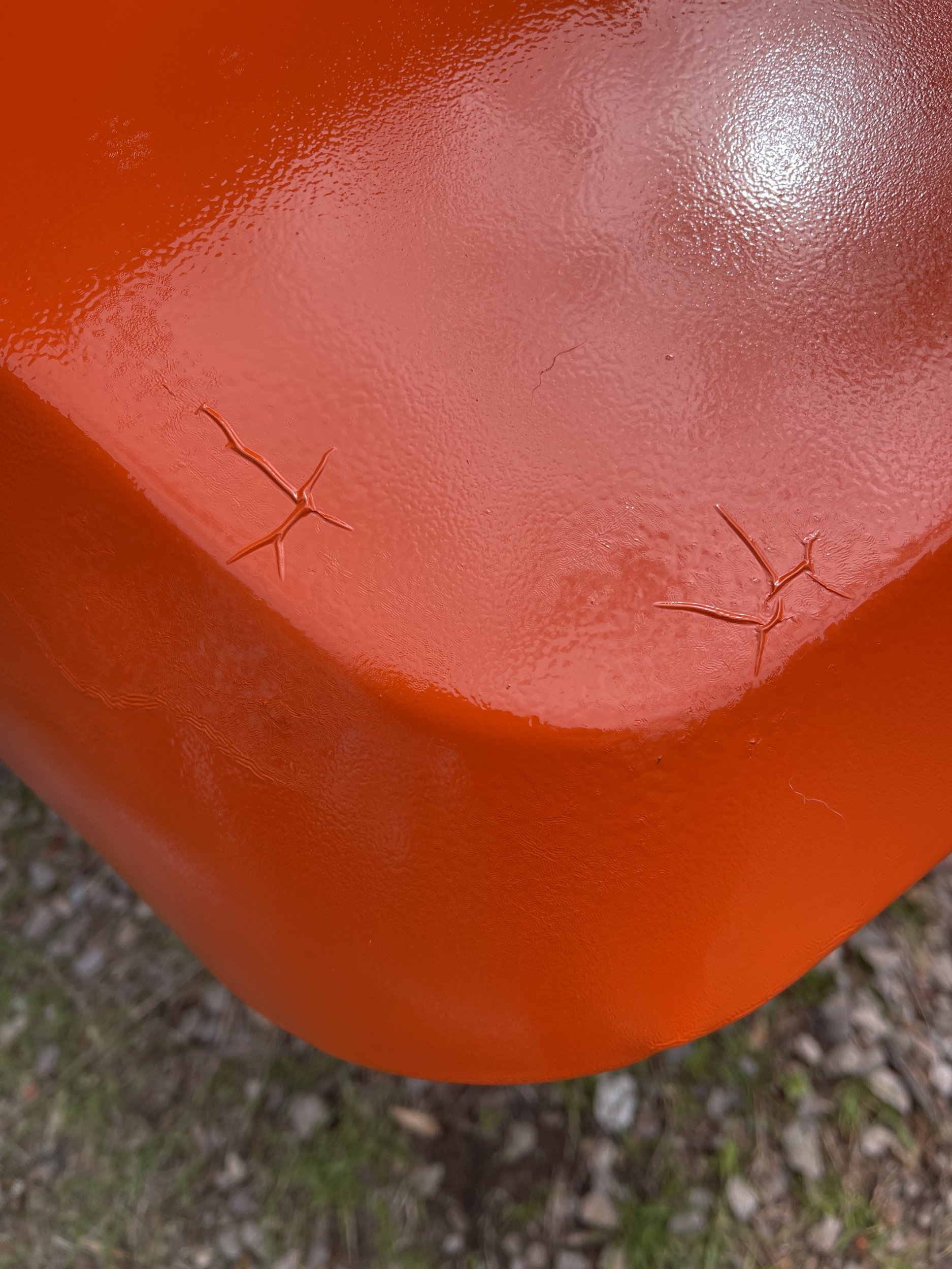

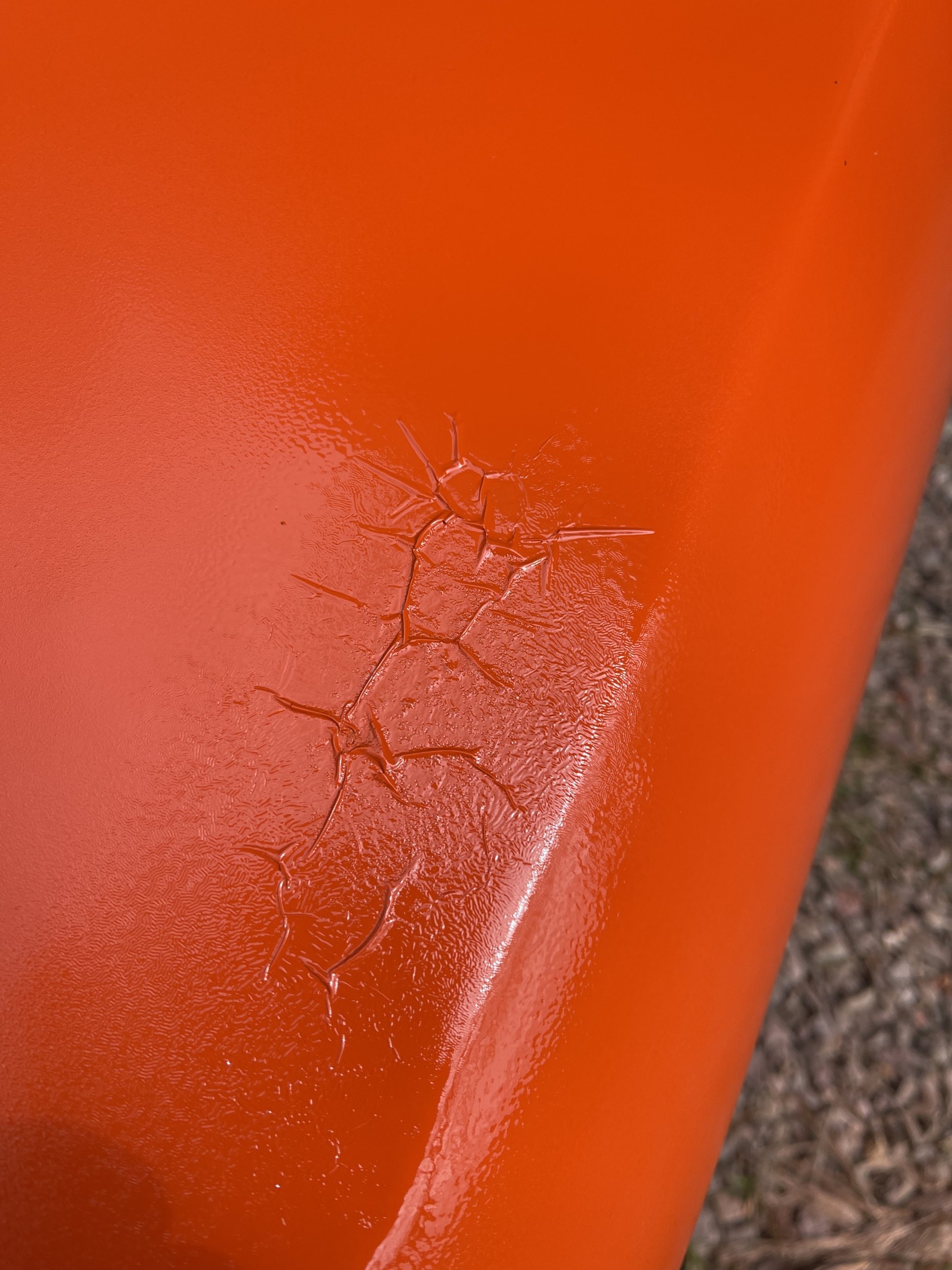

Applied 2nd coat of paint. Mystic, Kubota, spray can. Waited 24hours. Good weather.
Got this! What did I do wrong? First coat was dry to touch but could scratch with thumbnail.
Now have to wait to dry, sand and try again.
View attachment 855656View attachment 855657
Moisture or temps would be my guess. The solvent evaporation can sometimes cool the surface enough to create condensation.
   / Mess with the bull, sometimes gets the horns. #30
Was the second coat using the same paint? If have seen this when lacquer based paint was sprayed over non lacquer.
