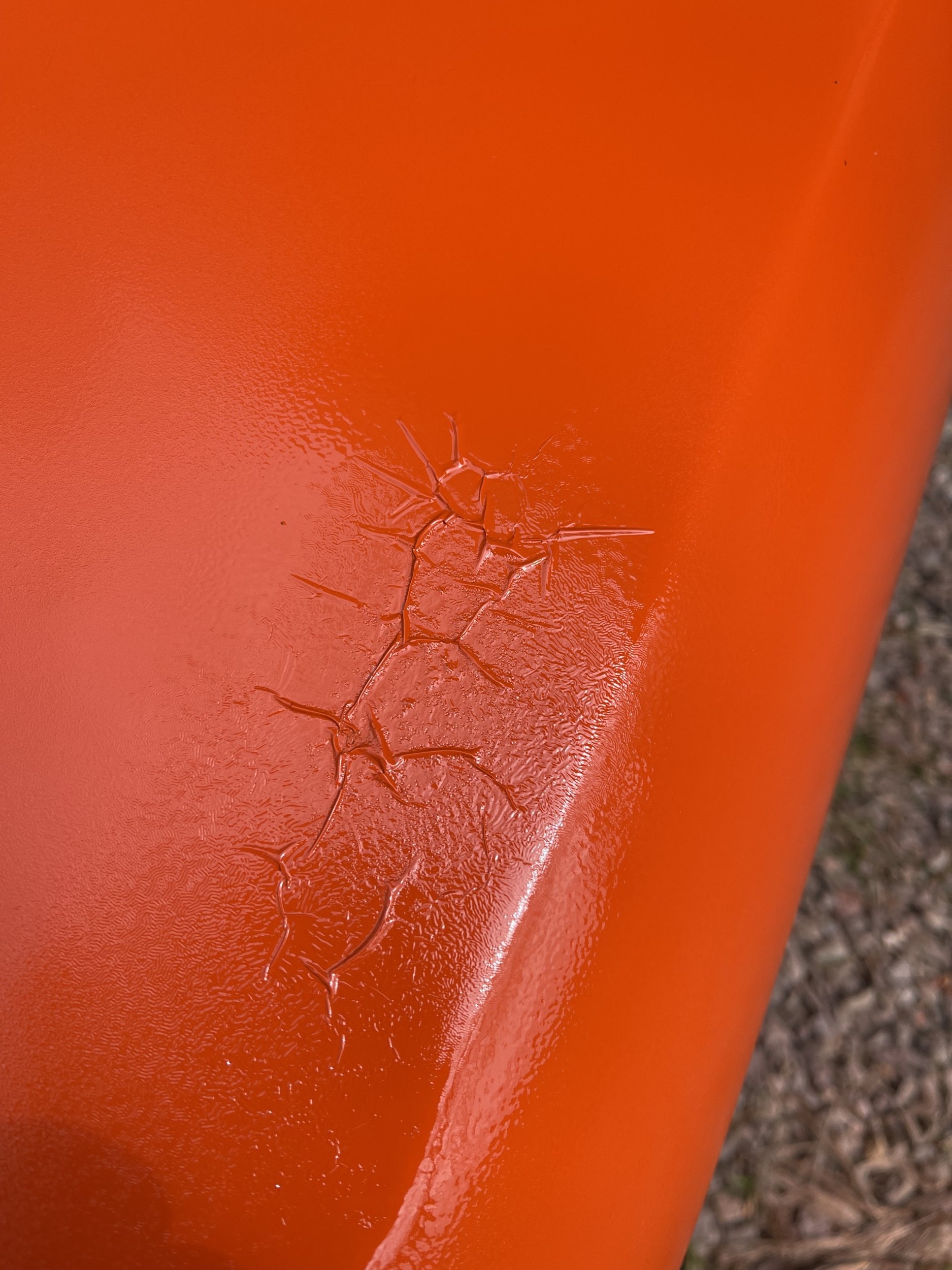

I've also taken a tractor hood to an automotive body shop. When they were done there was no way to tell it had ever been damaged. $300 iirc I thought was a pretty good deal

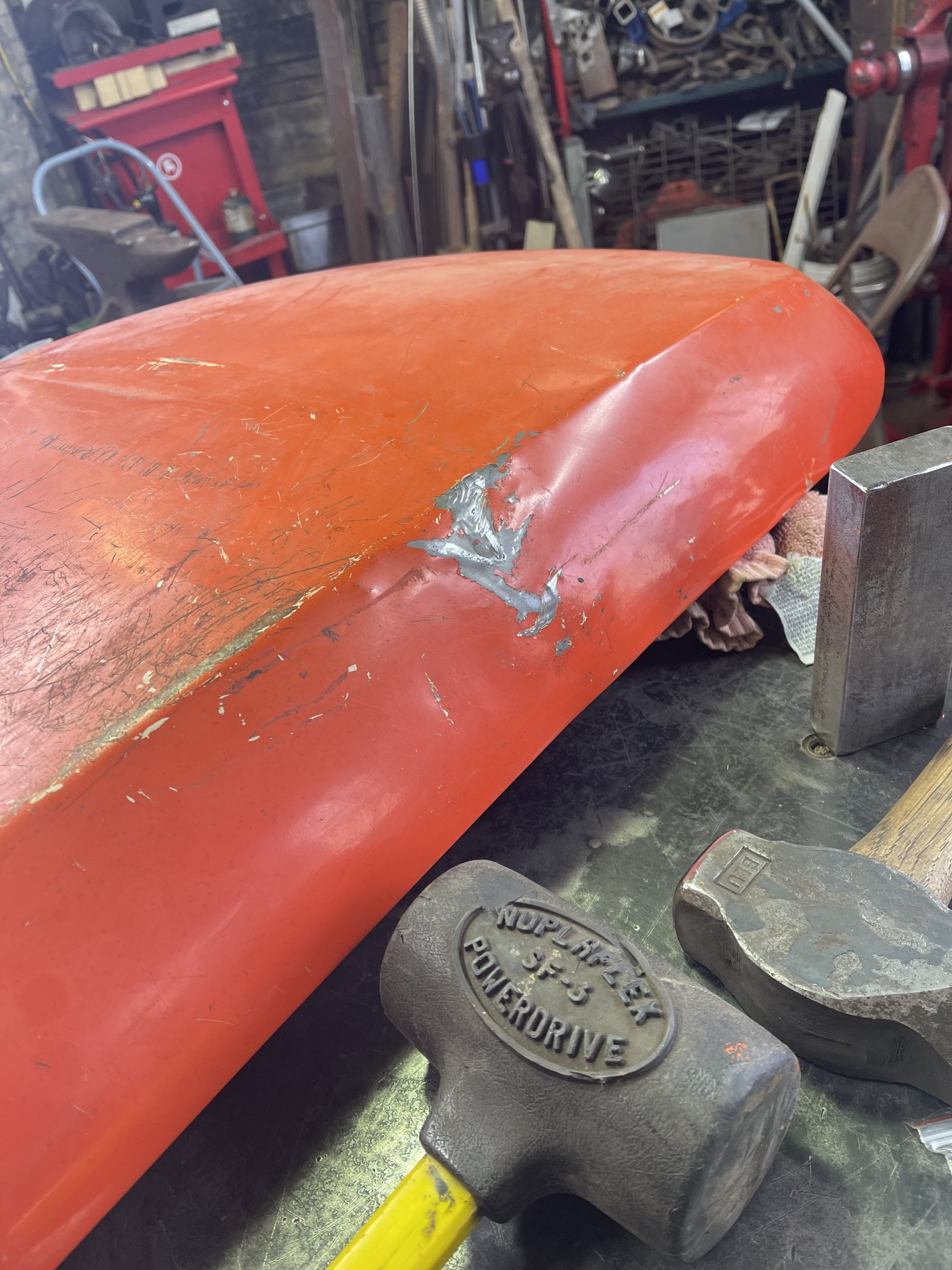

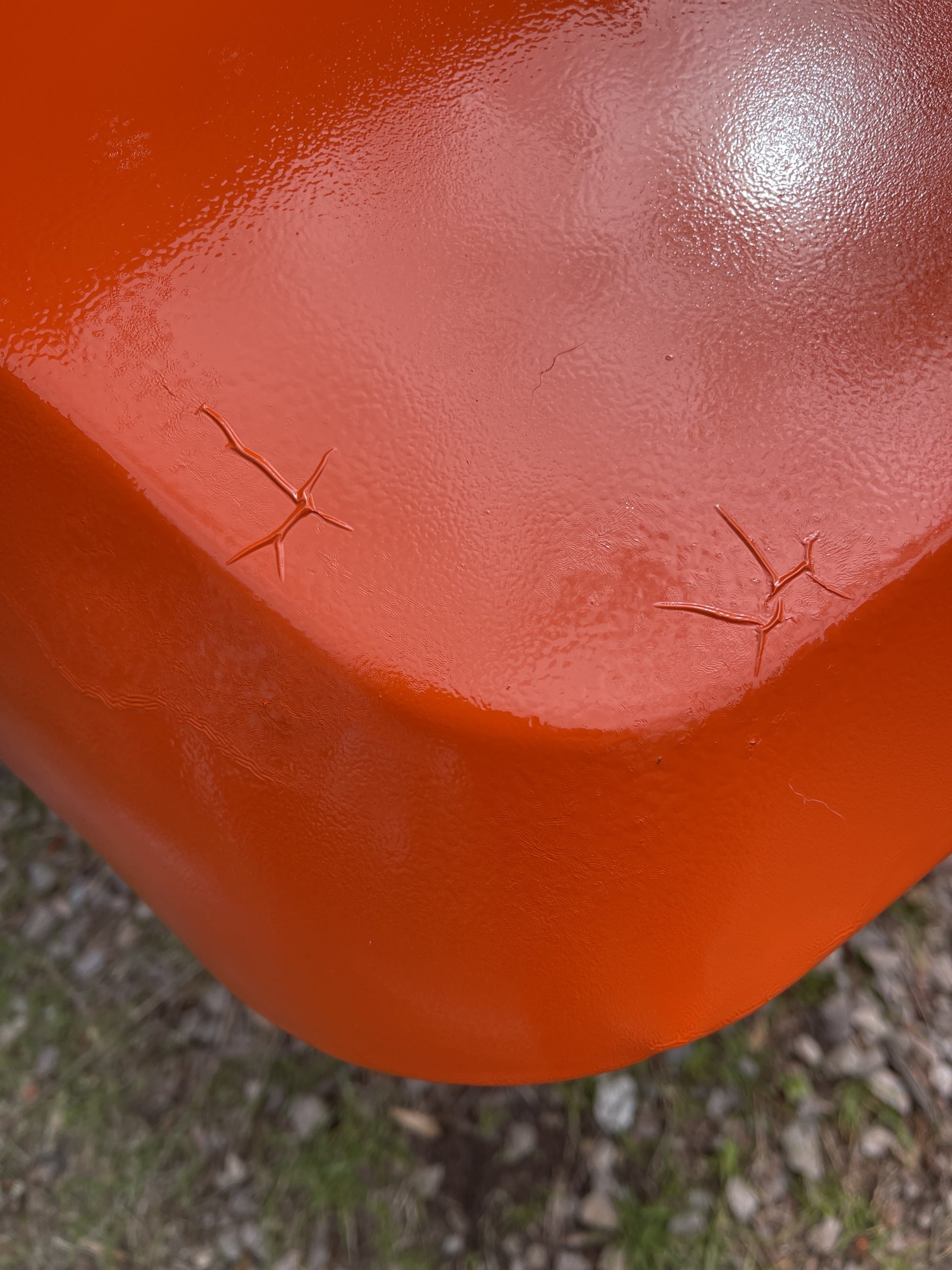

After 30 minutes of beating on the hood.

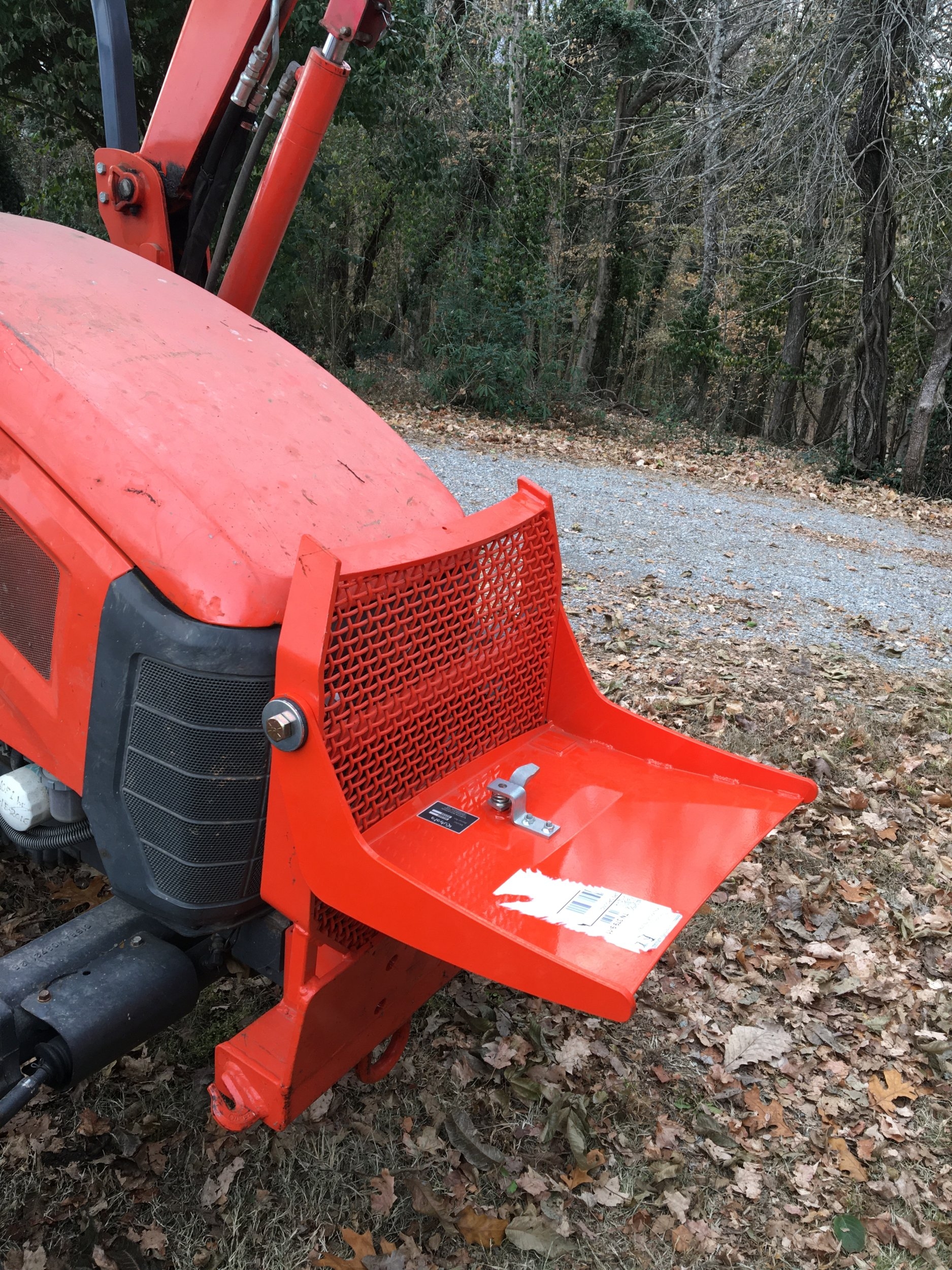

Been nice spring like weather for several days and really catching up on some outdoor projects including some that included clearing trees. Rain expected to start in a few hours so time to deal with a big stump from a large oak that fell last spring beside an animal shed. Have worked off and on clearing tree, sold saw logs, digging stump and whittling it down to size. Much too big for the M59 to lift. 8-9’ diameter with a 40”+ butt cut. 5-7ton wood muffin. Plan was to roll it about a 100 yards into the tree line for a final resting place. Got to 10 yard line and had it roll back.

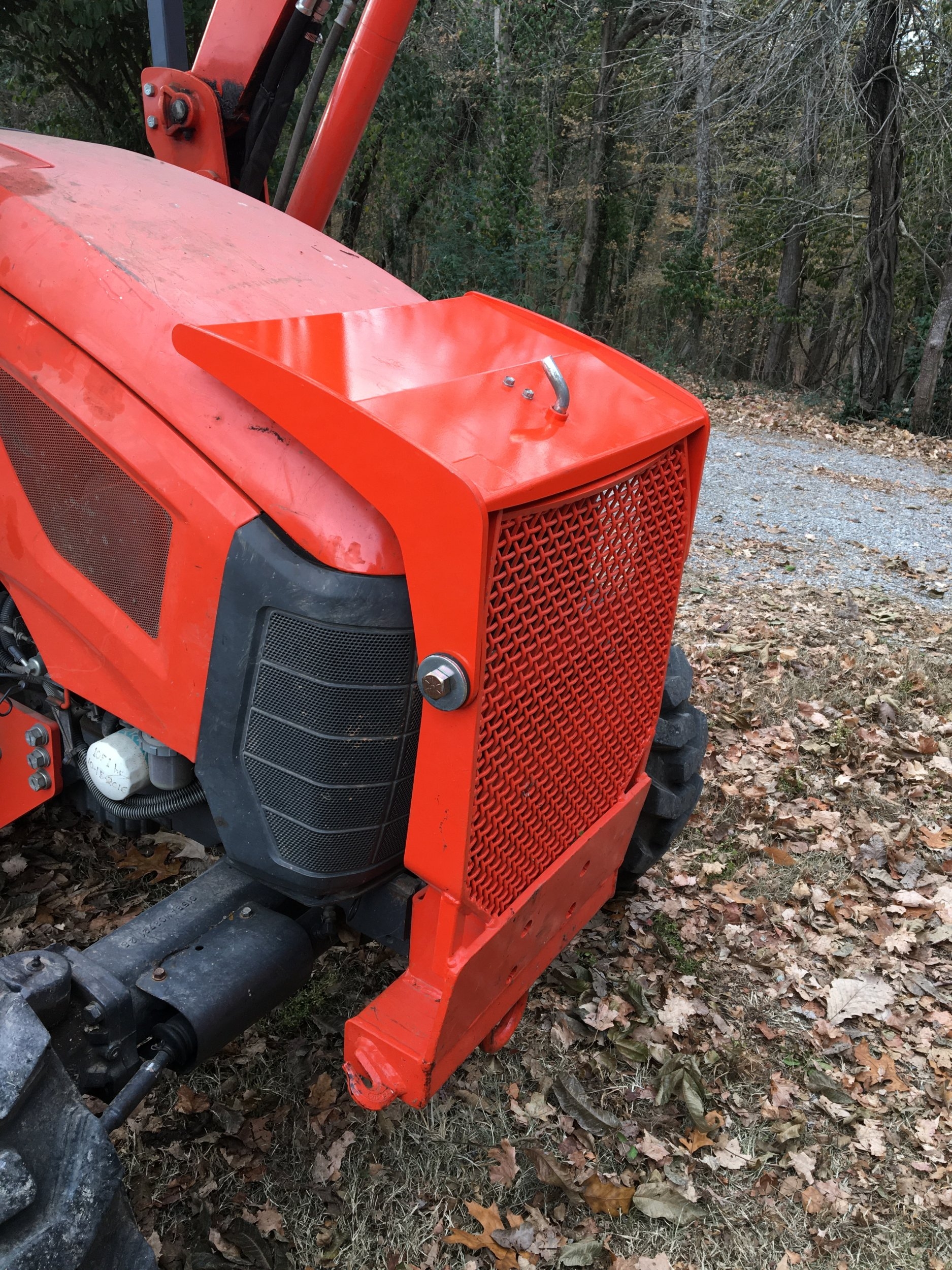

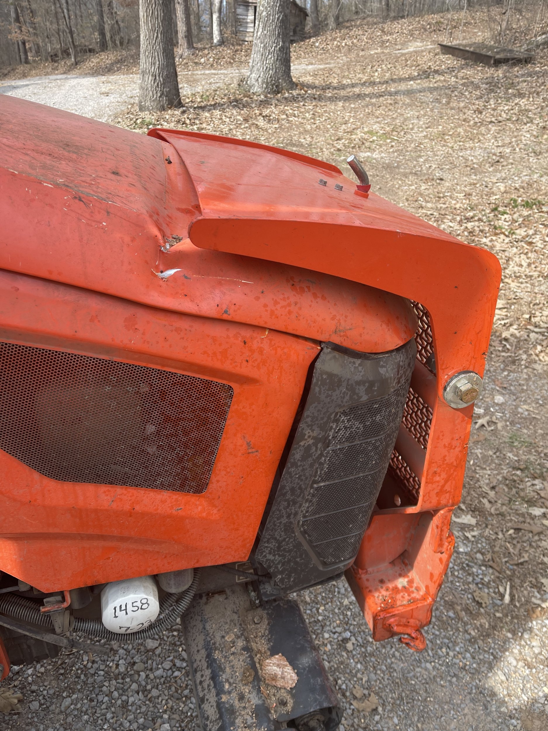

Crunched the hood even with the bonnet protection.
Tried again for the last push. Hydraulic oil squirted from right lift cylinder. Rod looked bent.
View attachment 853883View attachment 853884
Sux when your best player is injured. Have to evaluate for repairs.

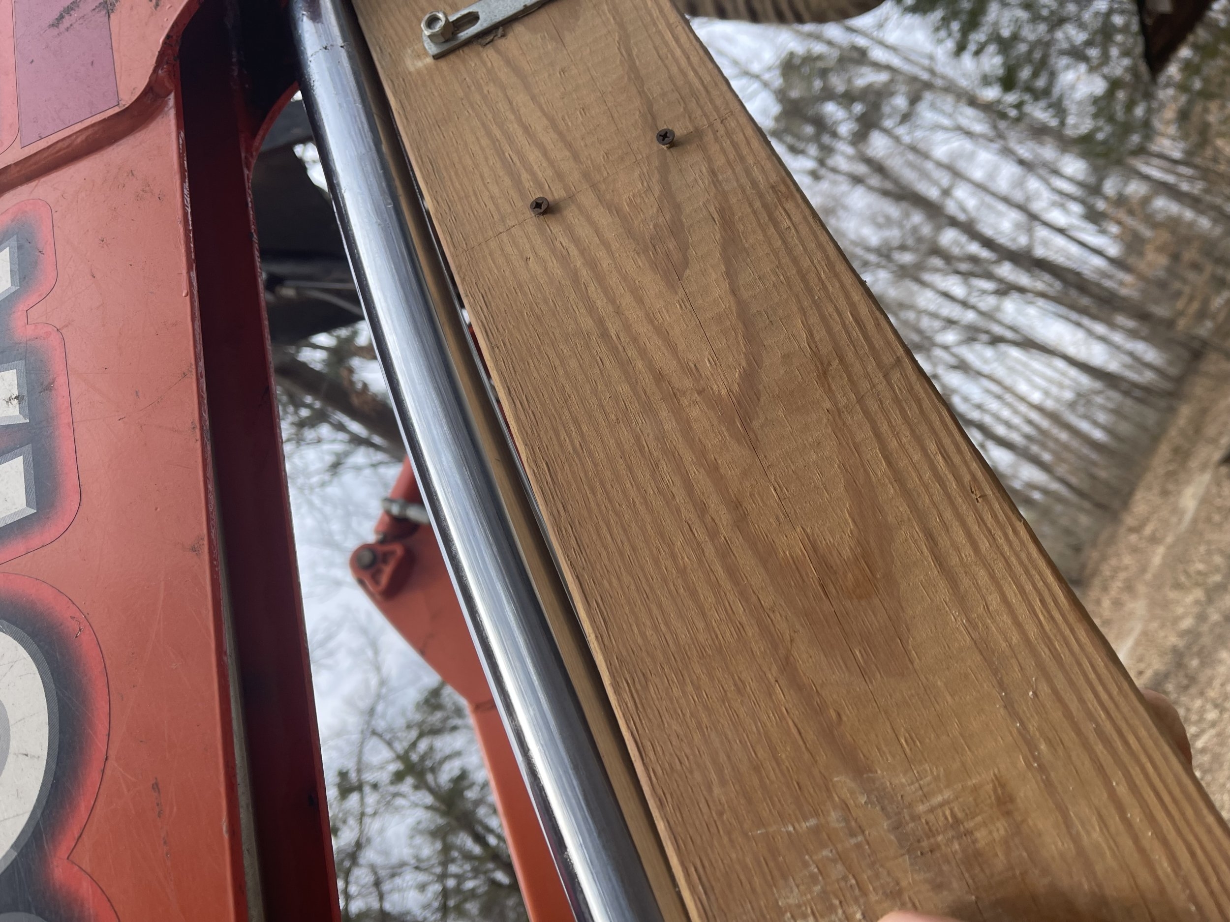

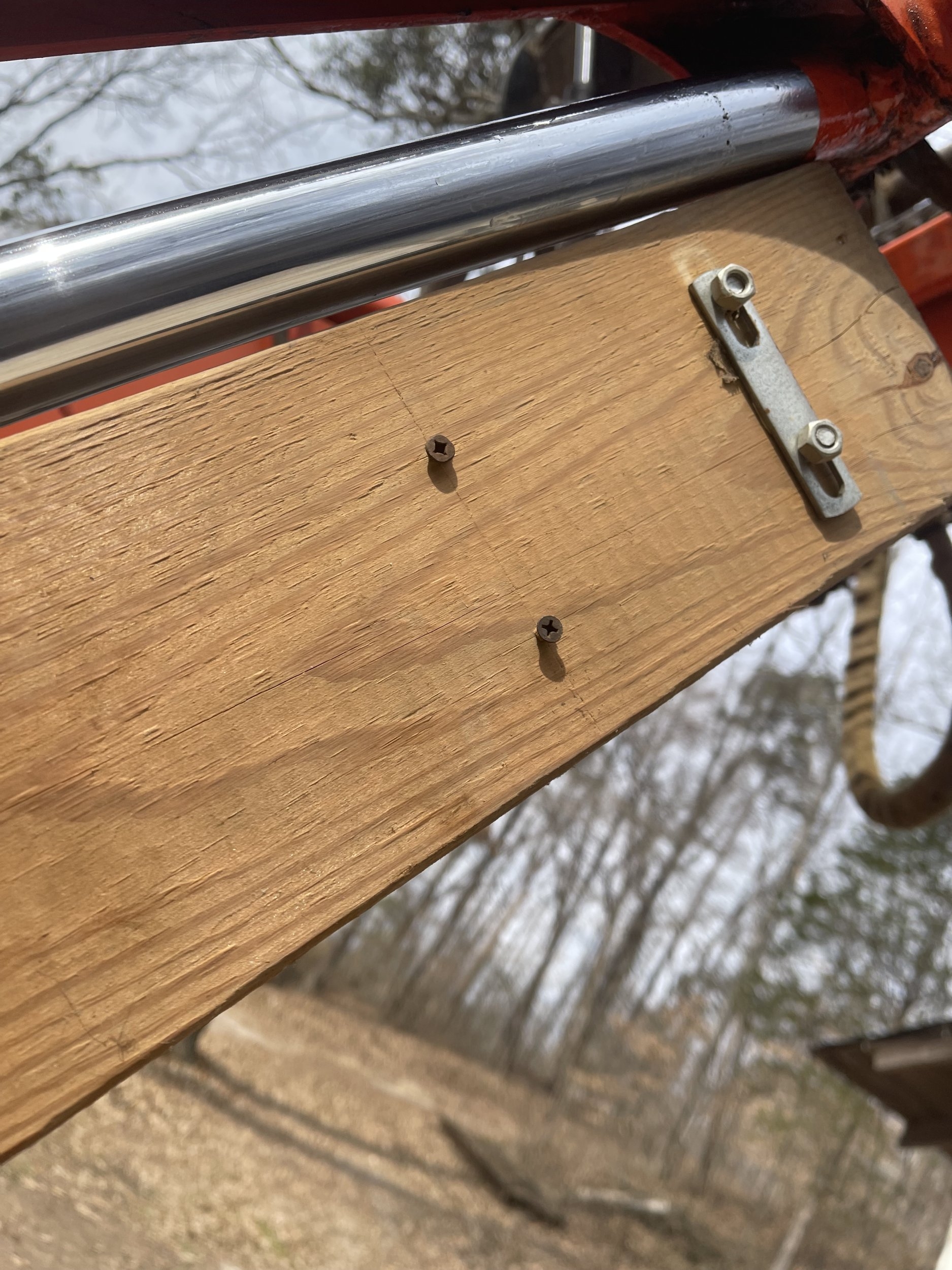

Cylinder rod has about 1/2” bow. No leak with no load. No chrome damaged. Might be able to straighten in press? First experience for straightening a cylinder rod.
Can beat the bonnet straight. Going to look again after sleeping on it. Like to learn new things just not this way.
Whole brush guard is pushed back some. I’ll start there.
Where did you get that hood guard?
