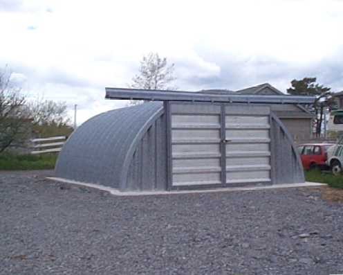

Don't think fancy is the word to use /forums/images/graemlins/grin.gif. I bought mine used tore it down moved it and rebuilt it.
