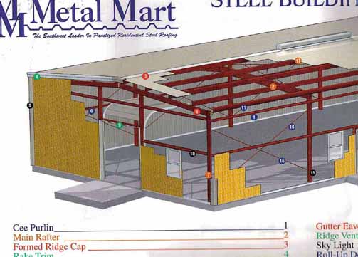

</font><font color="blue" class="small">( Not a problem. We build these buildings all around here. They are engineered by the factory. In fact for my span they called for a 5' on center. but I decreased it to 4' because I like to over-kill everything. The mfg claims they are safe to walk on as long as you step on the flats and not the ribs. But since I weight 330LBs I stay on the purlins when I have to go up there. Their 6 inch purlins are designed to span 25 ft on 5 ft centers. If I remember right, the bldgs are rated for 175+ MPH winds. I always add extra ties etc. for my own peace of mind.
I deal with a place call "Metal Mart" near Shertz, TX I think they have a web site. I'll ask next time I'm up there. )</font>

Maybe this will help!! See Attachment. This for a barn 40 feet wide, by 100 ft long.

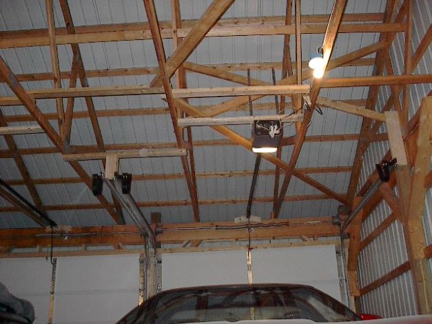

Here's a photo of the roof inside my 28 x 40. G

I see what you mean, big difference. Thats a lot of termite food there, WOW. nice. Bet that cost a lot too. Metal was cheaper than wood here before China went nuts.

I was just helping a friend put metal on his 28X40 tractor building saturday. I guess he sure over engineered it. Trusses on 16" centers and 1/6 Purlins on 2 ft centers...Still have one side of the roof to put the metal on as soon as the weather breaks, was 6 deg this morning, brrr
Ben
A metal roofed 40' building only needs 11 trusses.
Going to 16'' centers means 31 trusses.
The extra 20 trusses @ 30 Ea = $600 blown for nothing.
I feel 2x4 purlins 2' OC would have been better and cheeper than the 1x6.
