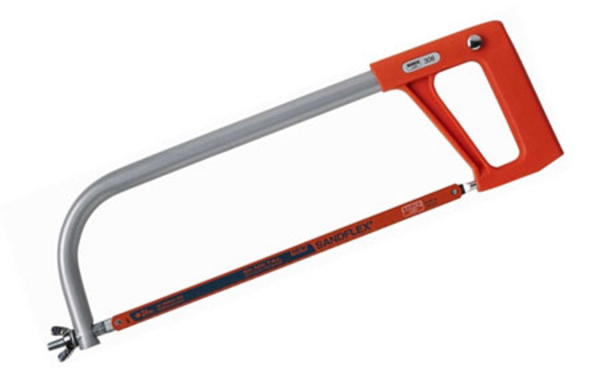

I'm the Quality Manager for a tube fabrication company, and I can tell you that we have three basic methods of cutting tube here:
1. Laser cutter - precise, not going to be friendly to a finish coating, and obviously very expensive
2. Metal cutting band saw - how the bulk of our materials are cut, mostly on two large industrial HEM saws
3. Cold saw - not ideal with large quantities, and clamping can damage any finish
That hack saw is definitely the economical way to go. Use a miter box to help keep straighter cuts.
